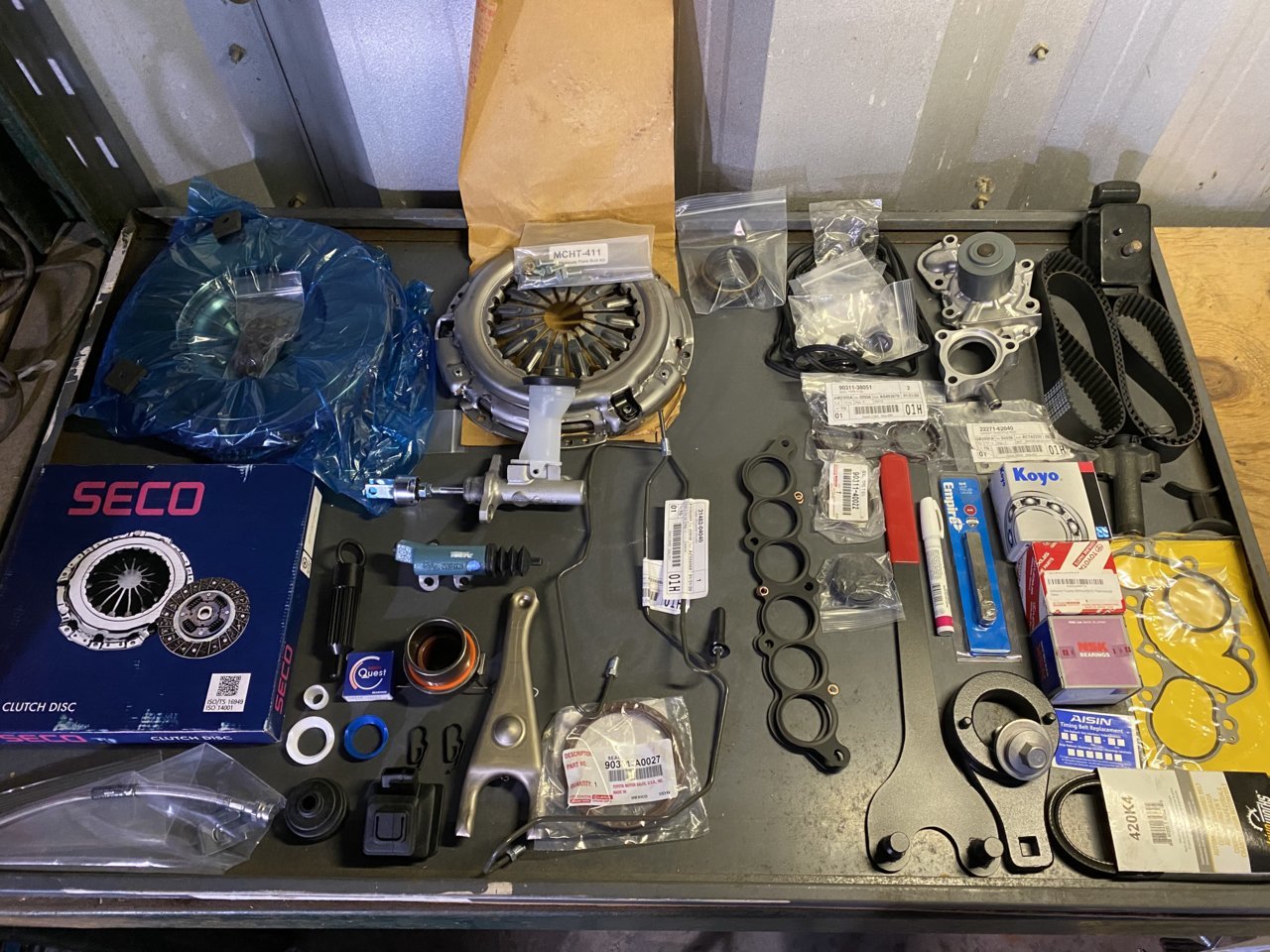

    Some parts can be found cheaper on Rock auto.
    They didn’t have anything in stock for the clutch hydraulics so I got my master and slave cylinder from Marlin. Still cheaper than $150 from Toyota.
    Parts from Marin crawler:
    8 x 3.4l 5VZ Flywheel bolt - $17.28
    Flywheel, V6 3.4L - $119
    1995-04 6cyl 1200lb Clutch kit - $339
    Steel braided clutch line kit - $33.25
    Clutch Slave Cylinder - $49.99
    Clutch Master Cylinder - $89.99
    Clutch fork boot for 1995-2004 R150 - $22.24
    Heavy duty pressure plate bolt kit - $7.99
    Heavy Duty Seats (White & blue) - $12.49 each
    2x Clutch collar retaining clip - $5.12
    Round shift handle boot 1981-2004 - $10.14
    Heavy duty socket - $7.49
    Parts for swap from Camelback Toyota:
    Clutch Hydraulic line 31481-04040 - $11.42
    Clutch Hydraulic line 31482-04040 - $15.44
    Release fork 31204-35031 - $44.81
    Rear Main Seal 90311-A0027 - $34.74
    In the picture, All the parts from the intake plenum gasket to the right are all for timing belt/valve cover gaskets. Parts on the left are all for the swap
    I’m sure there will be more parts when I get into it and Ill add them to the list as I go

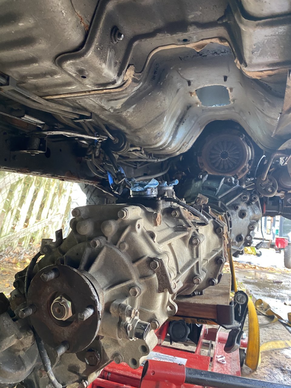

    So the time has come after waiting 8 months, I pulled the donor truck in the back and am pulling out the transmission tomorrow. I’ve been using it as a work truck which has been nice but I’m ready to get on with this build.
    Getting the trans out tomorrow and will have more pics to come

    Might be too late for this now, but I’d put the truck more on the concrete where the trans has to come down and you can roll the trans jack or whatever jack you’re using unless you plan on a helper and ratchet straps being your method of removing and replacing the trans.
    Edit: saw you’re not putting the other trans back in this one. I replaced my 4x4 trans with another one myself and those things are heavy.

    Lol yeah I’ve got a plan. I’ve bought a trans jack from Northern tool for the swap, and I’ve got some plywood I’m going to slip underneath for myself and the trans jack. And had to make room on the pad for my brother whose building out his sprinter van. As for when I actually start swapping stuff onto my double cab, it’s going to be inside the shop. But the donor truck just for pulling shit off I’m going to just do it outside, should take less than a day to get the trans out and from there everything will happen inside the shop
    Dalandser[QUOTED] likes this.

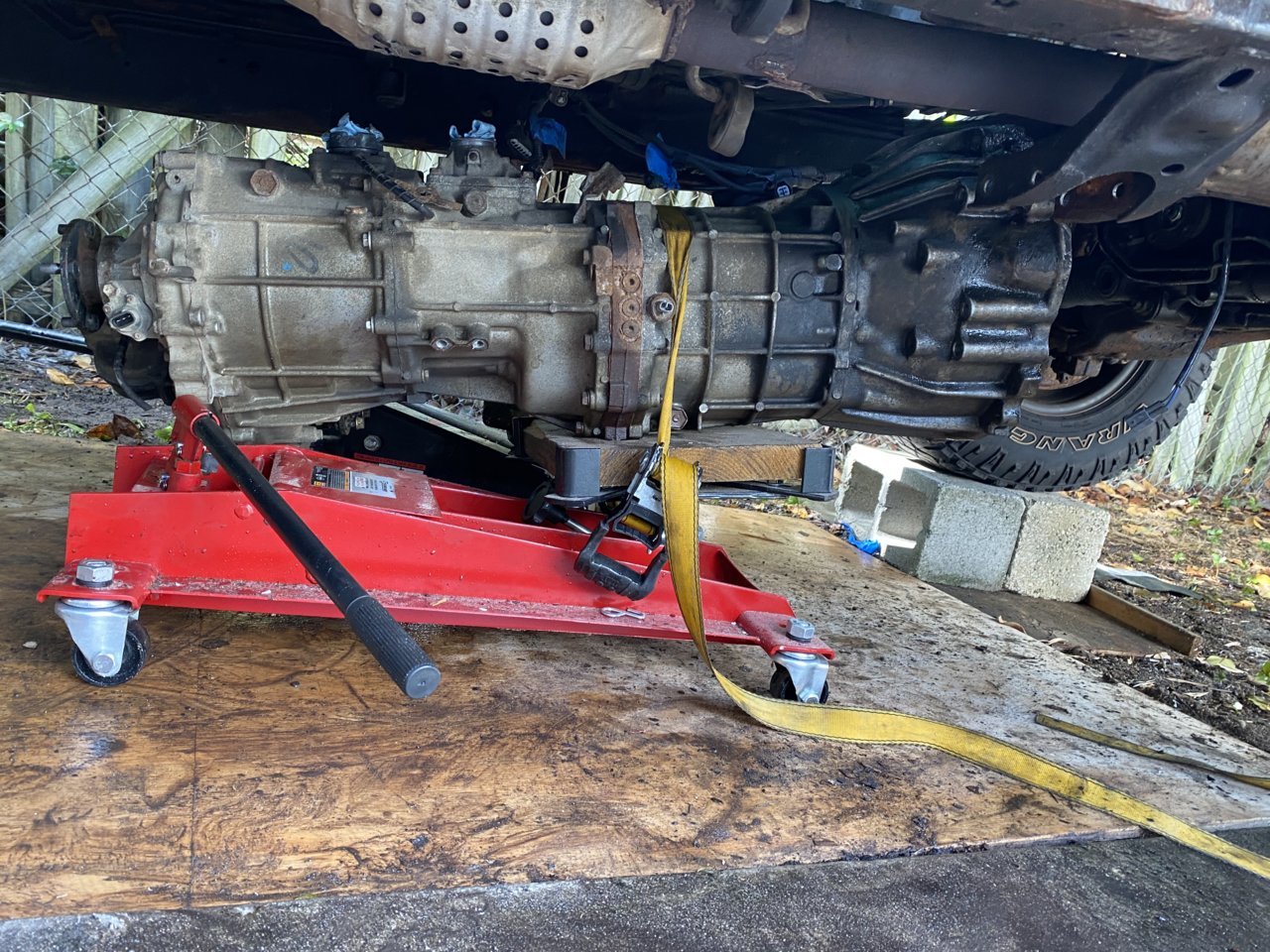

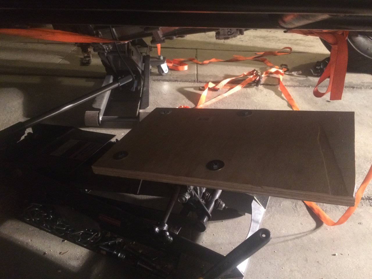

    I ended up cutting a piece of plywood for a larger base for my trans jack since the xfer case is off center and kept wanting to rotate the trans when lifting it. Another set of hands might have made that unnecessary.

    Cinder blocks are a Major NO NO for vehicle support!!
    They break so very easy!! I had a friend have his 17 year old son killed that way while good jack stands sat unused in the garage .From what we heard it was not quick!!
    Nothing worse then losing a child and blaming yourself my friend joined his Son about 2 years later I don`t think he was ever sober after that day

    I ended up just using a ratchet strap to keep it in place on the trans jack while maneuvering it out, had no problems with it moving on me at all. I didn’t have any help and it came out honestly a lot easier than I thought it would. Only took a couple hours from taking the drive shafts off to pulling the trans out. I feel I was lucky as all of the bell housing bolts were coated in oil so none of them were corroded
    I only had 2 bolts break, one bolt that holds the bell housing to the trans and then one bolt that holds the tcase to the trans. Other than that came out like butter. Had to remove the bell housing to get it out from under the truck though as I didn’t want to remove the exhaust
    That’s really sad to hear man,
    you’re absolutely right. It’s not worth it when the right tools are in the shop.
    I only used them as make shift car ramps, I put jack stands under the frame as insurance. I updated my other post to reflect that as to keep anyone from getting the wrong idea. That was my bad, and definitely don’t recommend them be used alone as jack stands that was bad wording on my part.
    I was laying on a creeper the whole time so that if one of them did break I wouldn’t be in harms way but of course it’s a lot easier to say I was being careful but if something were to happen there’s no guarantee it couldn’t have gone bad.
