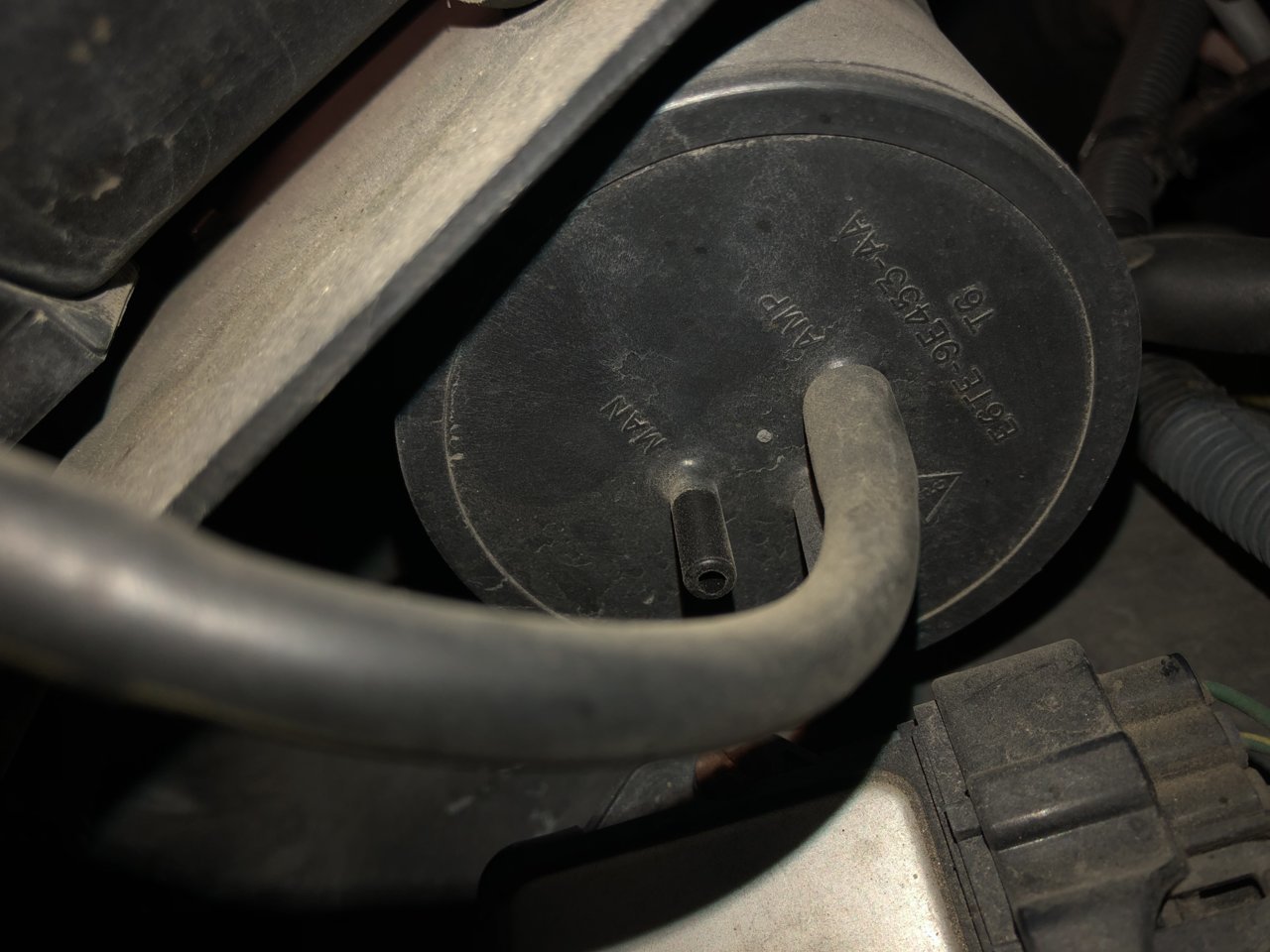

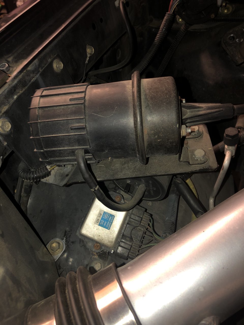

    Can anyone tell me what the vac diagram is for the cruise control if any for a 2001 3.4 Tacoma?
    For some reason all the pictures I find on the web show a control unit that looks different from what’s on my 2001. Looks like I have the ford version. I added a supercharger and I may have deleted a vac hose off the port in the pic below labeled “MAN”. Is this required for the cruise to work? Fuses look good, wiring looks good but it does not engage. Thanks

    Found it. Definitely needs a vac line. Guess I’ll have to tee it in somewhere as sc doesn’t have a dedicated port for it. Thanks
