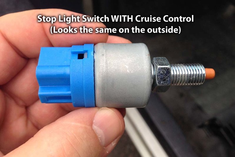

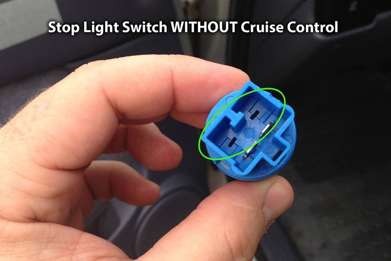

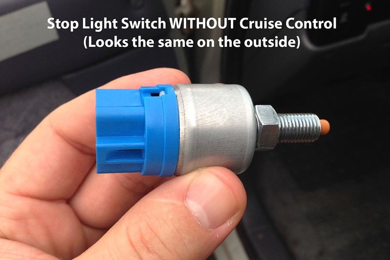

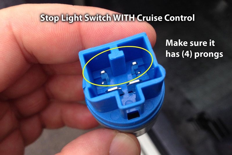

    OK, I'm having an issue with my Cruise Control activating.
    I just had to replace the "Stop Light Switch" second one I have had to put in. I could not get my truck out of park without pushing the shifter release button. Also found that my break lights were not coming on.
    $24 later and I have a new "Stop Light Switch" but I can't get my Cruise Control to engage. If I come to a stop and push on my break pedal and then hit the CC button the green indicator light comes on, but as soon as I start rolling the green CC light flashes on and off.
    I saw something out here about LED lights that might cause the problem from week voltage or something. I had to replace my license plate lights with LED ones like on a motorcycle but I think I have used my CC since then without issue.
    I think it has something to do with the "Stop Light Switch" any suggestions would be helpful, rolling from Phoenix to Yellowstone next week and CC is great to have in Utah.
  17. Aug 11, 2014 at 7:44 PM
    #17
    AZ Doug 44
    AZ Doug 44 New Member
    Aug 10, 2014
    #135851
    2
    Doug
    Chandler, AZ
    2000 V6 3.4L PreRunner TRD
    OK, I found the root cause of my problem. The guy at the parts store gave me a "Stop Light Switch" WITHOUT the cruise control pins.
    When I came back in I said is it possible that there are (2) versions of the "Stop Light Switch" maybe one with CC pins. He said "no" but lets look it up. Sure enough the kid sold me the wrong part a few days earlier. A quick swap and boom, CC is working fine.
