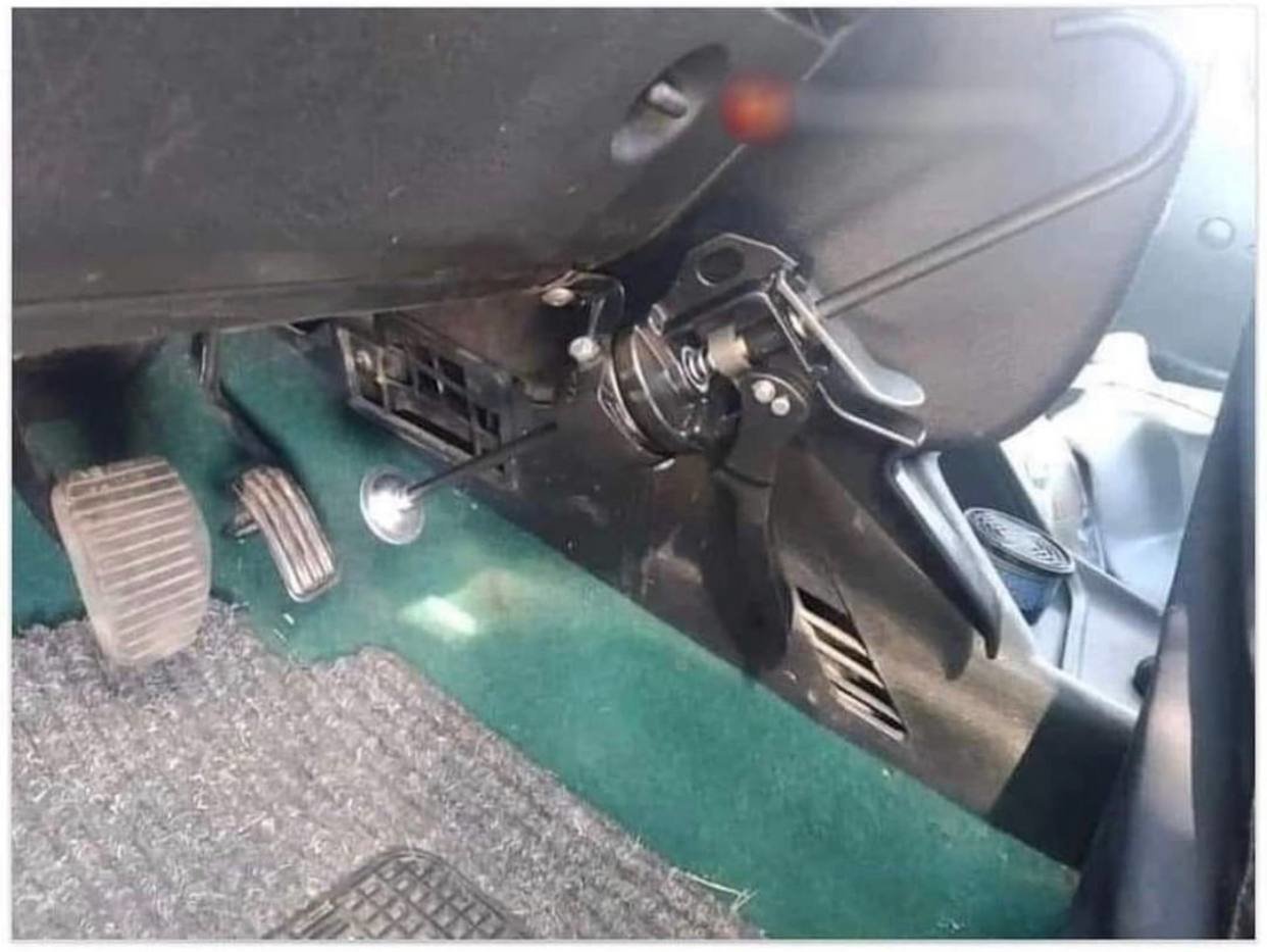

  7. Dec 12, 2021 at 12:13 PM

  8. Dec 12, 2021 at 12:17 PM

    :rofl:love it. Very simplistic.

    That's what us motorcycle guys have had to do until recently when bikes started coming with throttle-by-wire. I've got a clamp that holds the throttle tube at a fixed position and rests against the brake lever.
    It's better than nothing but really only works if you live somewhere relatively flat.
