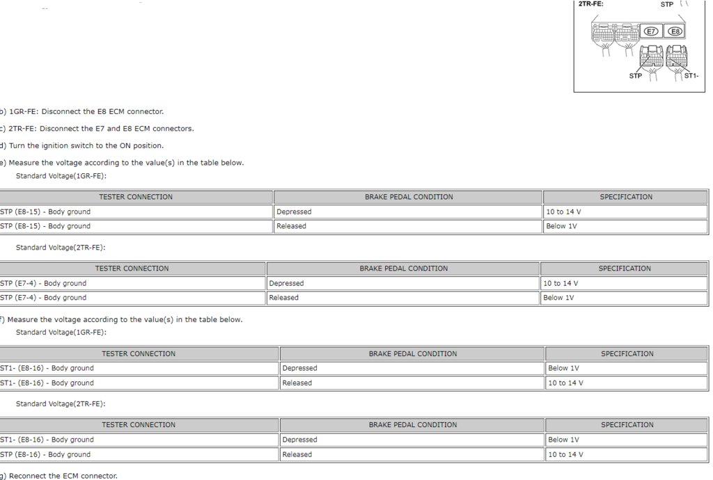

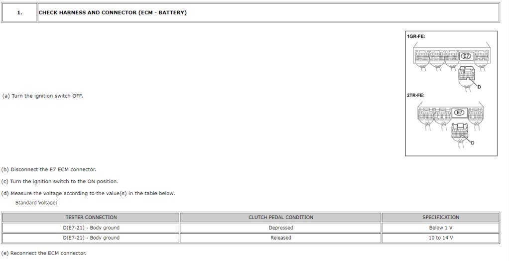

    Without a scan tool that can read data from the cruise system you can manually check the clutch and brake switch inputs but that's about it.
    Brake Switch:
    STP (Normally Open (0v)) is on Connector E7 Pin 4 (Blue)
    ST1 (Normally Closed (12v)) is on Connector E8 Pin 16 (Violet/White)
    Clutch Switch:
    D (Normally Closed (12v)) is on Connector E7 Pin 21 (Blue/Black)
