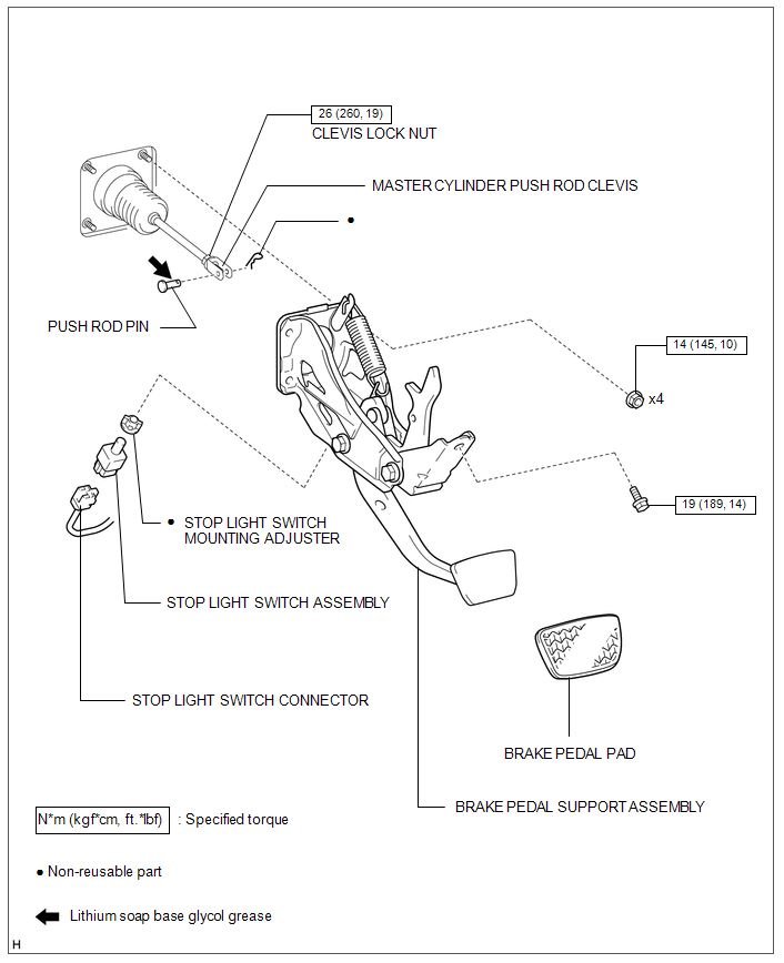

    When I am driving with the Cruise Control on,if i want to de-activate it with the brake pedal,it can't be done with a simple tap of the pedal.It seems I need to depress the pedal quite a bit,to the point that the brakes are slightly applied.I'm thinking also that it requires quite a bit of depression to turn on the brake lights.Does any one know if there is a spec for the amount of pedal movement required in these situations? I know years ago it was a simple switch that contacted the pedal arm and it was adjustable.Havent looked under the dash of the Taco to see if it is the same setup as yrs ago.

    I'm 95% sure the stop light switch triggers brake lights and cuts cruise control. It is mounted on an adjuster. If you have techstream you can apply the pedal and see when it triggers to set it how you want.

    Simple adjustment.
