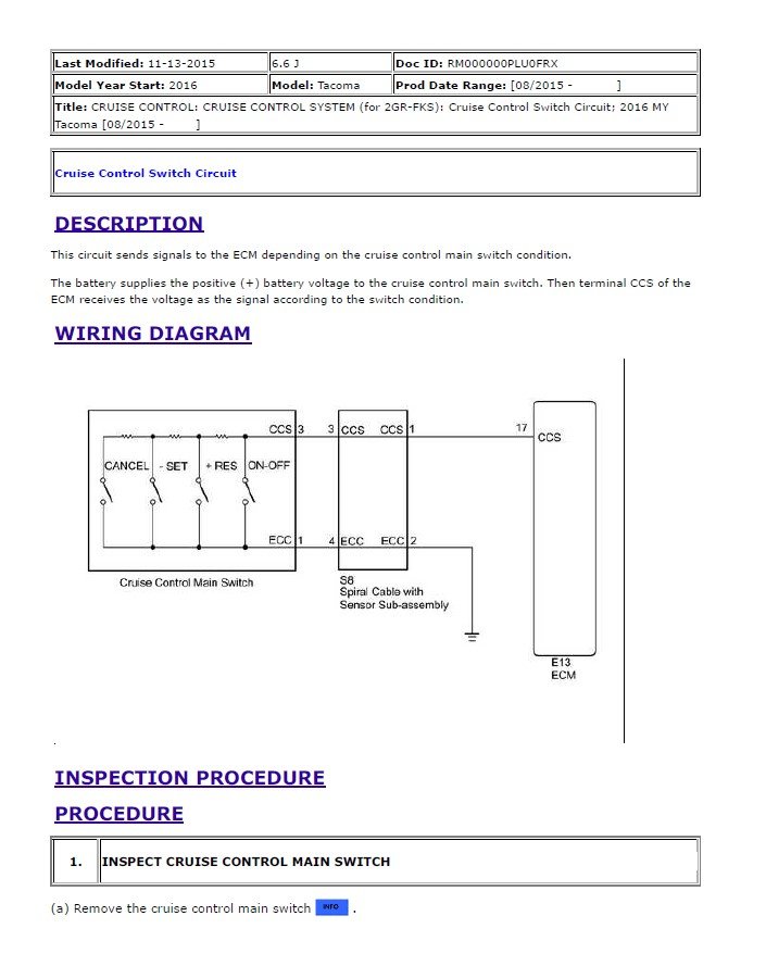

    I started a trip home - 1600 miles and the cruise control deactivated but the dash light stayed on. I turned the truck off and back on. The light went out and the cruise does nothing.
    I have never even heard of one going bad. Driving that far old school has my leg very sore.
    6000 miles out of warranty
    Anyone else have one go bad?

    On 2nd Gens this would be the clockspring in the steering wheel.

    WRT clockspring, I suppose other buttons on the steering wheel may not be working - worth a quick check.

    I have a 2017 SR. Adaptive cruise? Radar what? Lol
    I have a spare cruise switch I am going to put in. If that doesn't work, I am going to have to further diagnose. I have just not heard of any others having this problem.

    Most likely a clock spring, an advanced scan tool or a volt meter with wiring schematic are the only way to tell.
    There is no longer a seperate power circuit for cruise control since the electric throttle plate became common place.

    I replaced the CC switch in the setting wheel and it now works. Everything else worked. No fuses were blown and all the other dash lights were fine.
    Weird.

    Totally not weird, considering:
