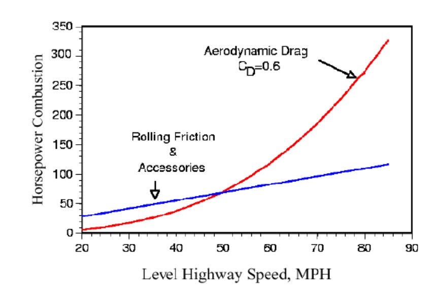

    I don't know where you got the idea that cruise control gets better mileage. It is absolutely false. It is not as efficient as your foot.
    I would think headwinds played a major part on your way out.
    Lastly, your truck's most efficient speed is only 50 mph. Here's a typical curve. Take a look at the amount of HP required to go from 50-70 mph! All of that is wind resistance. Even a 5mph headwind is additive and will suck the fuel required.
