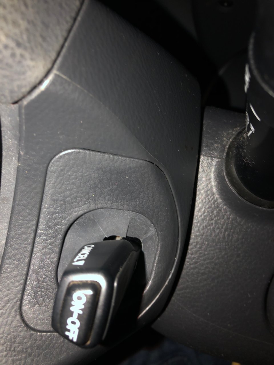

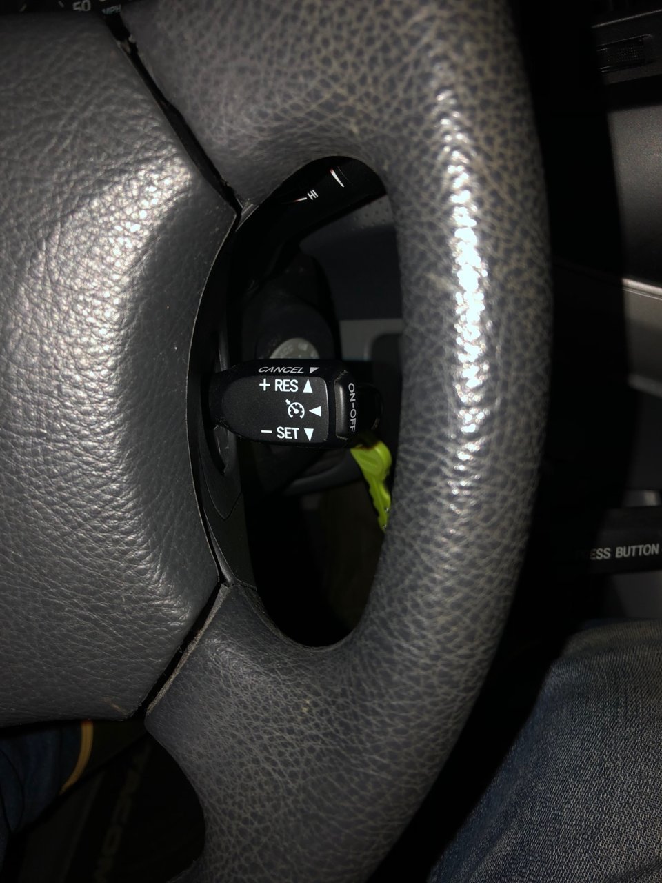

    Just completed the install and everything works perfectly. Brand new 88280-14030 Clutch Switch plus 45186-0C020-B1 Steering Wheel Side cover with rubber gasket; $27.17 delivered from McGeorge Toyota Online Parts.
    Second hand Cruise Control switch assembly from Ebay: $21.98 delivered.
    Everything was plug and play, including the clutch switch.
    Time to install: about 90 min.
    By far the first mod anyone should do to a manual trans Toyota!
