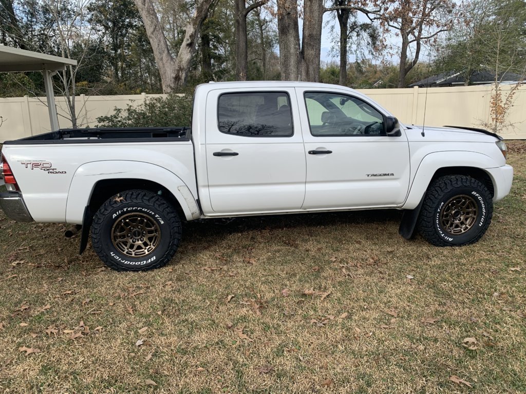

    Here is the truck with the new wheels and tires. On Monday Im having the OME MT 64 kit put on plus new upper and lower control arms.
