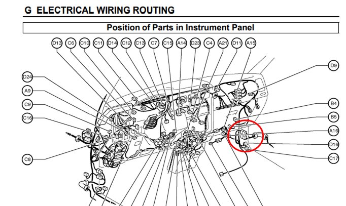

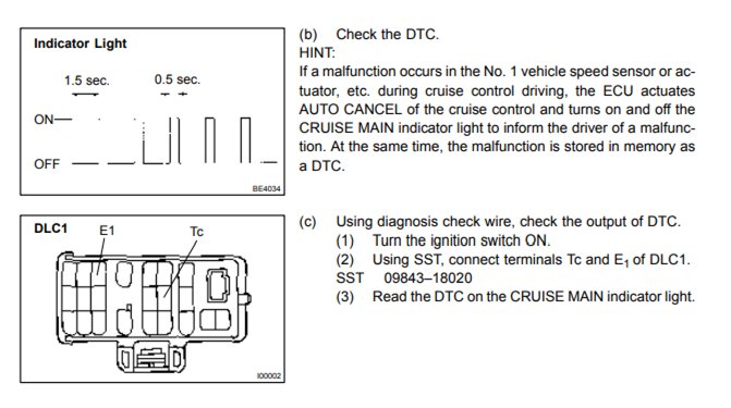

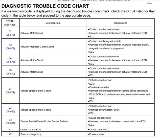

    Here is what I can offer as far as advice. Looks like your ECU is trying to tell you there is a problem. You need to check it for DTC(trouble code). I am not positive, but the ECU is probably located in the right cowl trim (hand kick) panel area. Image below is from 2000MY.
    There is a Toyota Spec Service Tool recommended. https://toyota.service-solutions.com/en-US/Pages/ItemDetail.aspx?SKU=09843-18020
