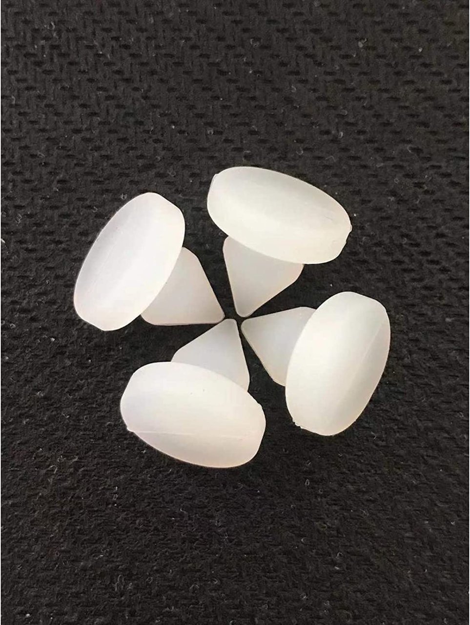

    I think you figured it out. The white button is still there but its going through a hole in the pedal assembly instead of being pressed. Whatever was in that hole is gone.

    That would do it, I've used those plastic pushpins to fix those in the past you just have to find one that is the right size.

    Yup, I had some push pins that fit, and it worked. Thanks, guys.
    Here are some key words for those plastic pins:
    BRAKE CLUTCH PEDAL STOPPER PLASTIC RUBBER PAD BUSHING
