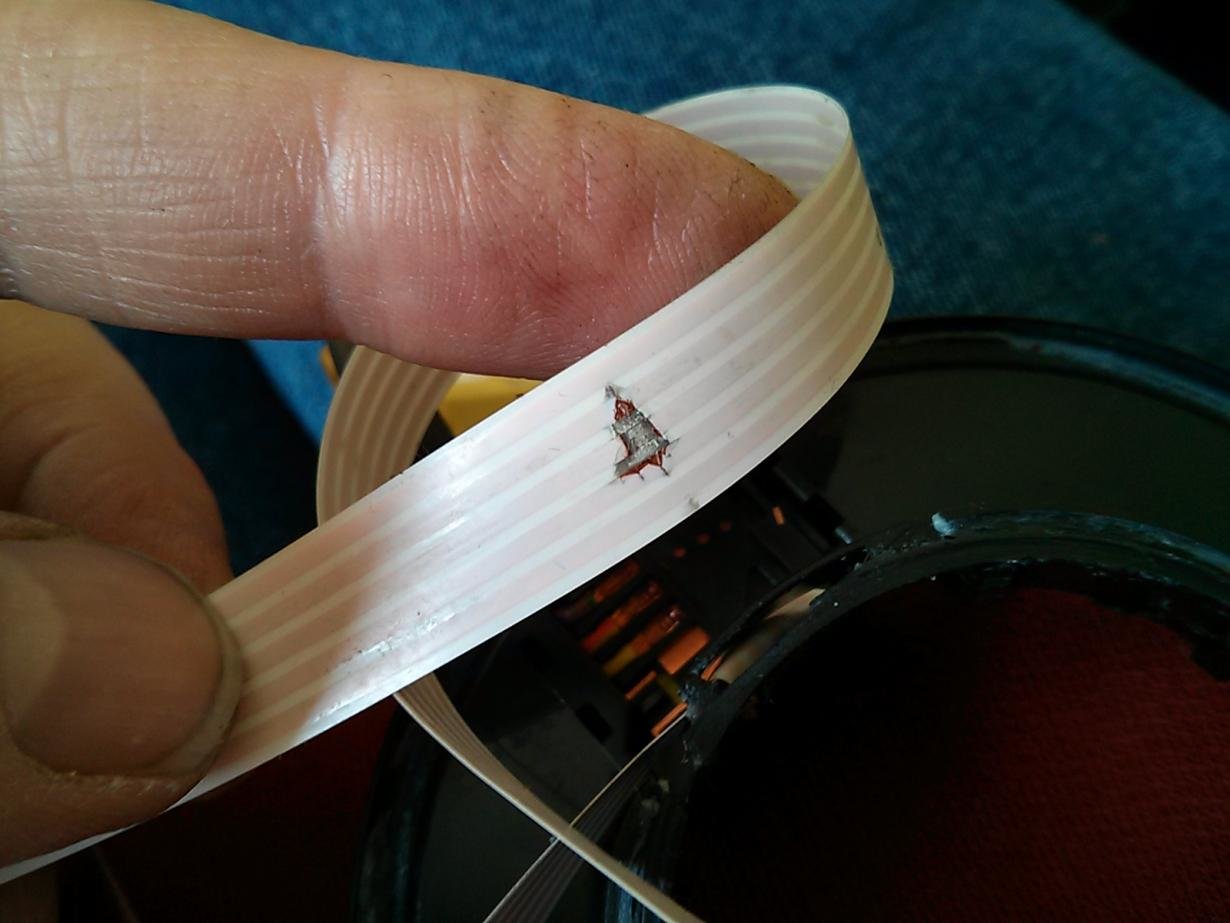

    The ribbon cable in the clock spring has multiple wire traces for multiple functions. On yours it seems only the circuit for the cruise is effected so far.

    Okay, that actually makes sense. Once I take apart the clock spring and inspect it I’ll take some pictures of what might be damaged.

    You will probably see something like this effecting one trace or more. Note this is not a Tacoma clock spring cable. The Tacoma will be similar and with stereo controls and cruise probably has more traces.
