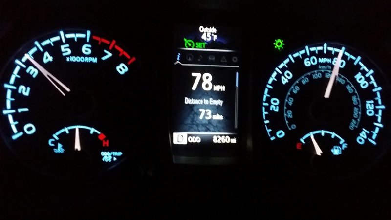

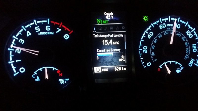

    I am at the dealership, talked to a few techs here. They have not seen a problem like mine (ours). They have only seen a few 2016s coming in for service or ANY problems.
    There is ONLY one new SR5 2016 4x2 on the lot; no other Tacos. Salesperson just told me they are having a hard time getting them.
    I have pictures of the dash that my wife took when I was driving, and I have footage of the driving/shifting from my mounted gopro. I showed that to them.
    From our conversation; I think they believe the issue, but will need time to check it out. I live out of town so I will setup an appointment to drop it off next week.
    I am SURE nothing can be done, but if I (we) don't take it in and document it nothing will be done. This forum is GREAT, but it is NOT TOYOTA, so we need to take it in and document it.
    The engine runs on a computer; there are ways for engineers to modify the torque curve; they just need to know about issues.

    that display looks great at night. Time for me to trade!
    SamChieftan[QUOTED] likes this.
