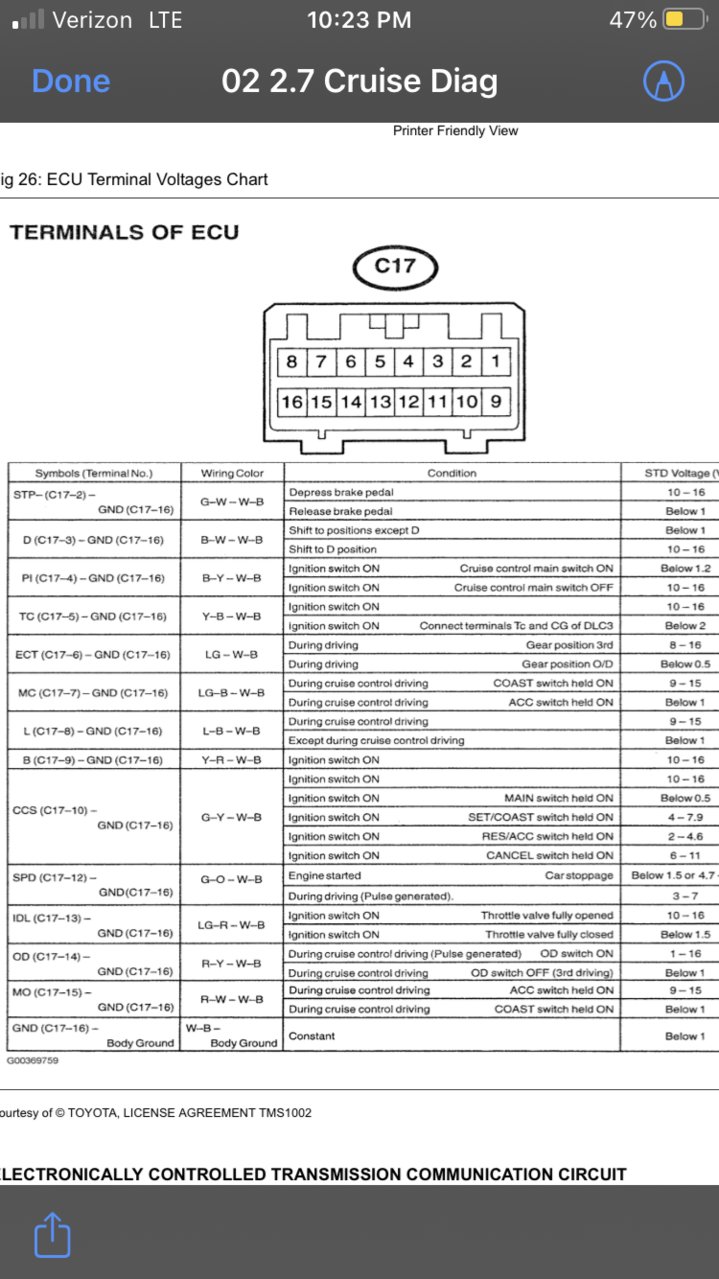

    Is there any people that are very familiar with the cruise control wiring? Need help getting it going in a swapped truck. Original engine was a 2.7. The factory ecm only has connector 5 plugged in. Trying to bypass the other wires to get it to work. I do not have power to the blue/black wire at the cruise module or the brake switch. I have powers and ground to module. Cruise light comes on. Park/neutral wires are jumped to simulate the truck is in drive.

    Thanks, I have that but pins 6,13,14 not sure what input they need. And pin8 has no power either

    Do you have a good one of the brake switch? According to the cruise diagram it gets power on pin 3 from the cruise module, but wondering if there is a connector in between or gets power from somewhere else?

    Here's the troubleshooting guide for the cruise, that's about all I can do to help.
    It looks like some pins are different between engines, unfortunately that's the price of changing things from stock, getting everything back working correctly can be a PITA.

    Thanks hopefully I can get by with this.E3390B91-B54A-482A-A343-298373C9B41F.jpg

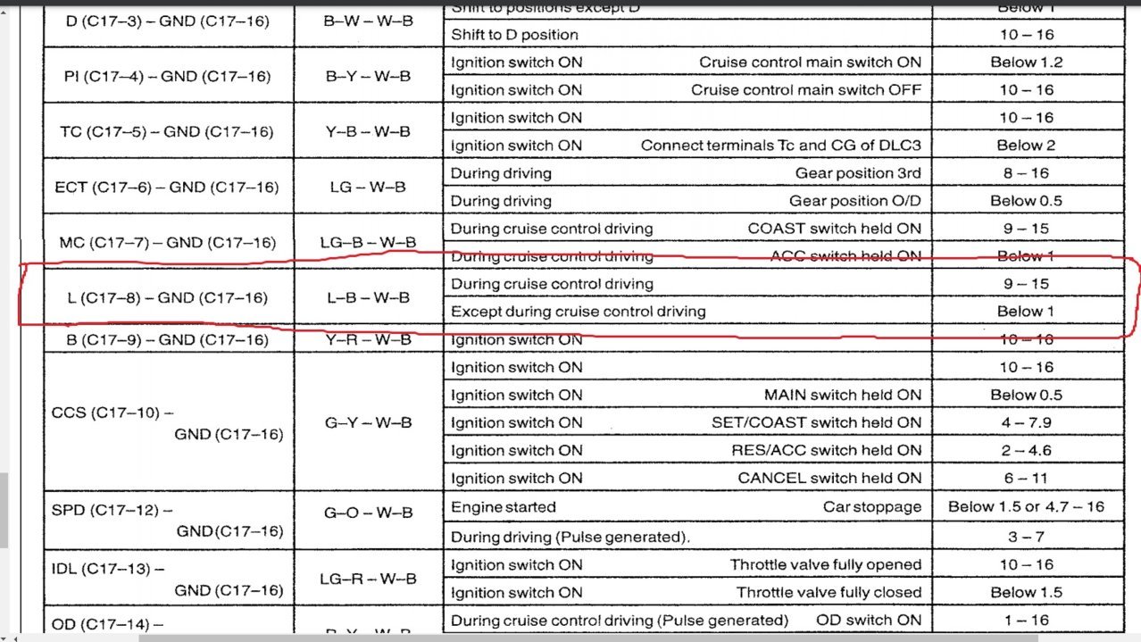

    If anyone can verify pin 8 key on engine off voltage or where it gets power that would be fantastic thanks

    Looks like it's only active with the cruise engaged.

    you are going to be my new favorite lol I don't know how i did not catch that, spent too much time staring at schematics
