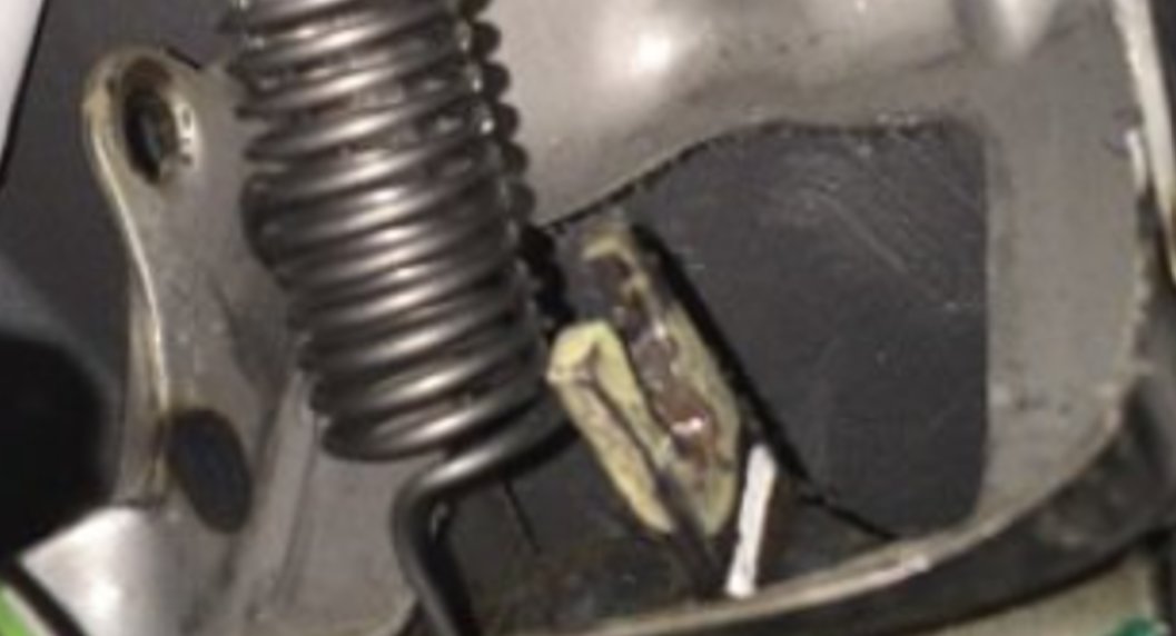

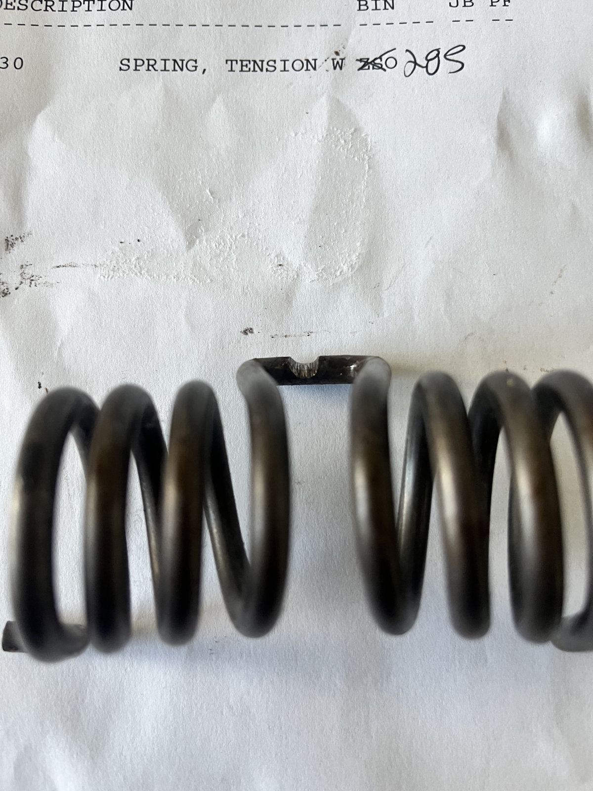

    This is likely what his spring looks like, I know mine looked similar (though not quite as bad) when I took it out

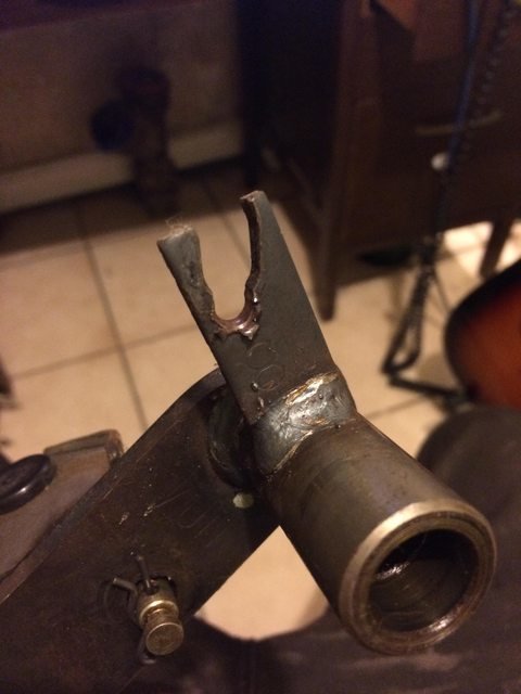

    And on the bracket side it digs into this piece:
    Horrible picture I know, best I could find, but you can see how distorted that slot has become from wear.
    I'd just throw the $5 linear spring in there and call it a day, even makes the clutch feel better imo

    I hear ya, that’s also what mine looks like but that worn portion of the spring isn’t the problem with the clutch pedal returning fully, it’s that adjustable arm (can’t recall what it is called). That spring isn’t going to go bad because of some wear at the center.

    It's not just the notch in the spring there is almost certainly a big notch in the corresponding part of the clutch pedal. The coil spring is a fancy design that makes it easier to hold the clutch pedal down. When it wears like this, it most certainly cause the pedal to not return fully. If it gets really bad the clutch pedal will sometimes even stay all the way on the floor when you press it. It's a common problem with these trucks and a very easy fix. Just pop out the coil spring and replace it with a linear one. The 4-cylinder models have a liner spring that will work, and the 6-cylinder models have the attachment points for the linear spring.
