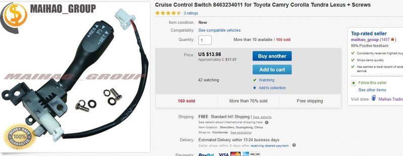

    i called my 2 local toyota dealers and they do not even install CC , they told me to call a place locally who install aftermarket CC, I wanted factory OEM CC, my '05 tac 4x4 base model is not pre-wired either.

    i ordered this the other day on ebay. when it arrives, i will follow the video and attempt the install. worst case i'm out $20 CDN. I emailed a buyer near me that bought the same unit. it worked no probs.
    fyi OEM on ebay.ca is over $100 for new.
    i'll follow up after it arrives and I install it.
    how to install video....
    https://www.youtube.com/watch?v=TjoTus5q5p0

    It took a while to come. I needed to upgrade the wire harness to include the ground for the airbag. The stealership had it for $80 cdn. Just installed. It all works. FYI. The dealership wants $165 for the stalk and u still have to buy the wire kit.
    Took 10 min to install.
    Mines a base model prerunner and it was prewired. I think they all are.
