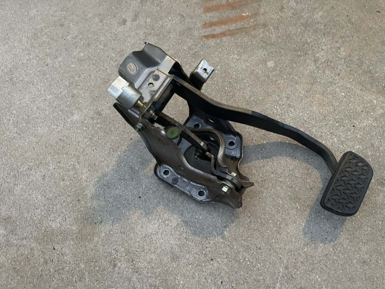

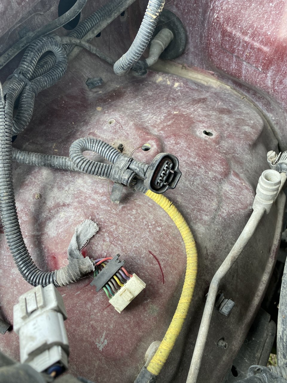

    Hopefully you have this connector in your engine bay....
    mystery connector | Tacoma World
    and one of these....
    For 2001-2004 Toyota Tacoma Cruise Control Switch SMP 95567DP 2003 2002 | eBay
    and a place and connector on the cowl harness for this....
    SMP T-Series Cruise Control Release Switch for 1997-2005 Toyota Tacoma - la | eBay
    may have to buy the whole brake pedal bracket to accommodate that switch...
    I've got a whole backup one out in the shed.....I'll go look at that tomorrow...
    maybe post some pics.....

    Will do. I believe I have the mystery connector. There’s a couple there not being used. PO removed the servo & cable. Switch on column lights up green when I push it.

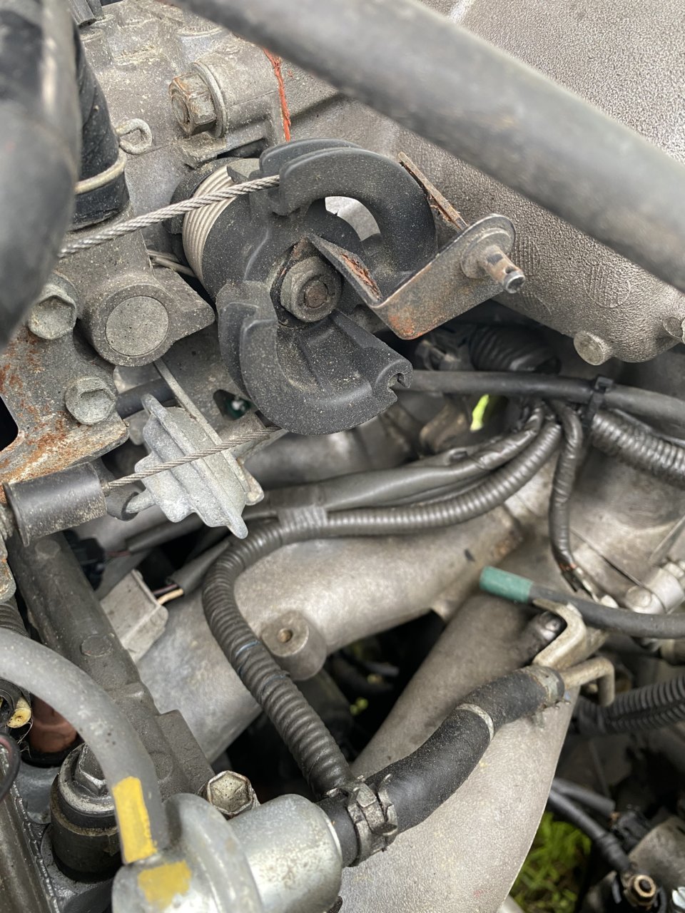

    I think the your exsisting pedal to TB cable is the same as the pedal to cruise unit..
    so you should have to aquire the cruise to TB one....
    If I remember correctly....that one was unobtanium in the US....would of had to order it from Japan or Dubui...
    that's the reason when I saw that whole unit on ebay for $130 with the two cables....I grabbed it....
    cables alone would have set me back $230....
    each one of the cables are north of $100.....and then the kick down cable....
    hence the insulation efforts....

    I have this connector. Any idea what the white one is for?
    This is TB

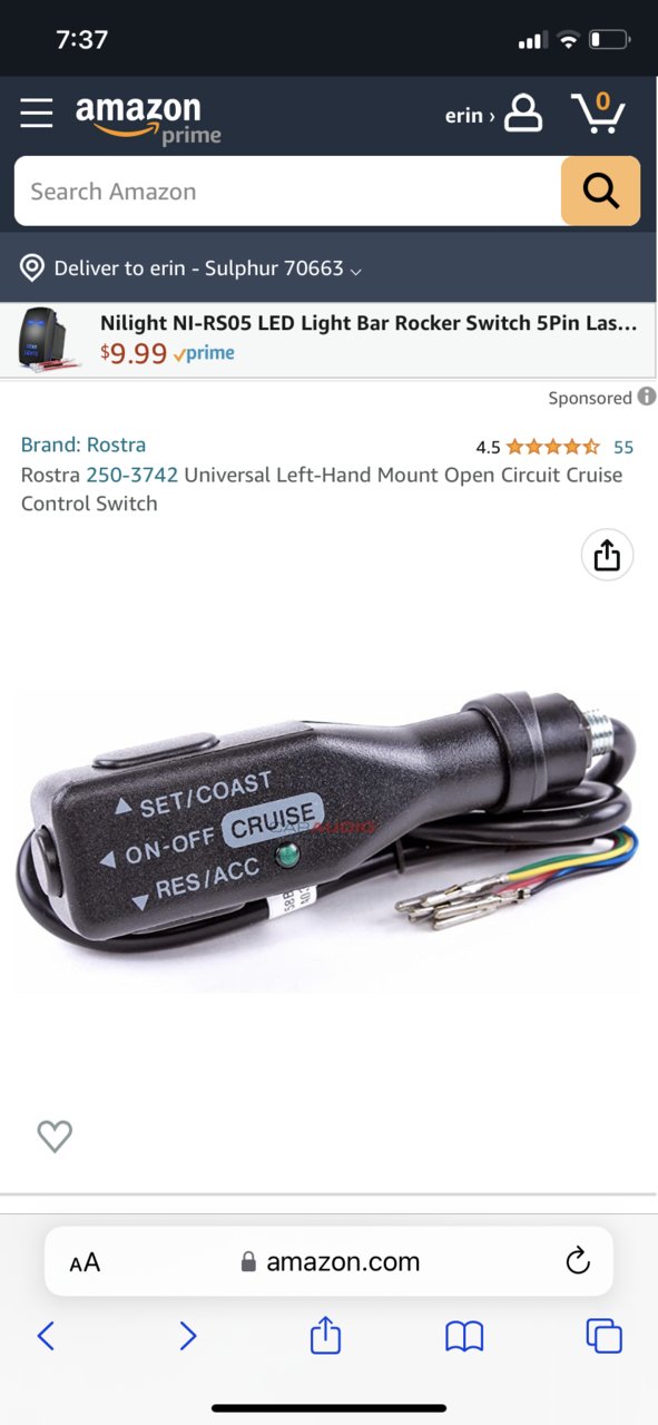

    The white connector and harness looks aftermarket.

    That looks like a Rostra set up. Gulf States would add an aftermarket system to trucks that didn’t have cruise. It was built by Rostra.

    1997 Tacoma lowboy
    Show a picture of the cruise switch.
