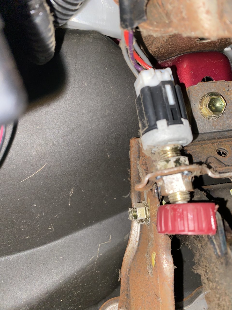

    Does this brake switch look like the one for the Rostra cruise?

    As I recall, the factory switch was used on the brake. The Rostra system just t-tapped on the “cold” side of the switch.

    The coke bottle cap is definitely not factory….

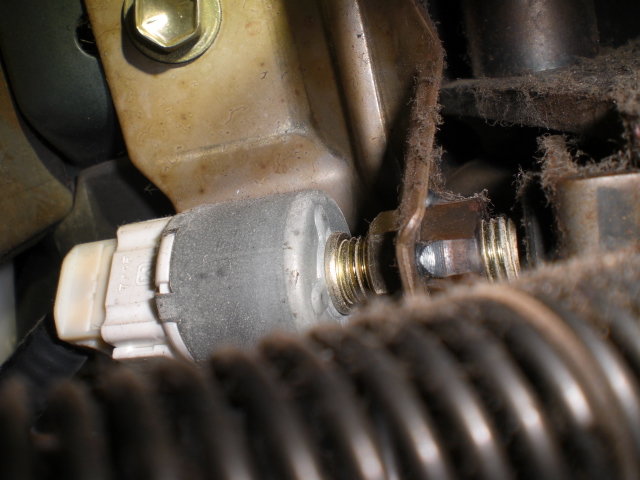

    .....98 AT......

    I suspect the rubber plug that snaps into the metal housing is missing. You can actually still buy them from the dealer.
