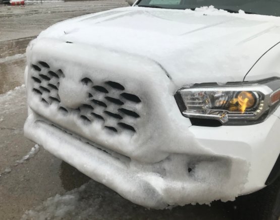

    I got an error message about cruise not available in the snow yesterday. Went away this morning though. Bought the truck in Dec 2020, should I call my dealer to have them check it out?

    No, heavy show and rain can cause the system to disable,,,, of course cruise shouldn't be used at those times anyways, so not an issue.

    Did you get snow on the front TSS sensor? Radar would not work if so.

    Front sensor blocked with snow. Normal.

    Your forward radar was probably covered in a layer of snow.

    Snow on the PCS radar in the grill will cause that. Keep the center emblem clear of ice and snow and you'll be fine.

    I didn't think it would be a problem it had just started snowing

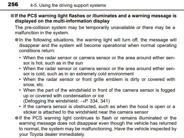

    Yep, this is an expected condition per the Owner's Manual...Happy Friday!!

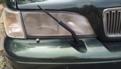

    My old man used to have a volvo years ago. Would I be able to put on something like this to get it to work in the snow?
