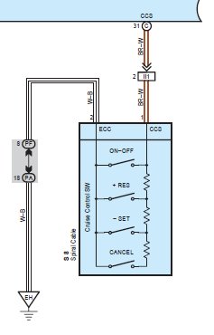

    I have a couple questions.
    Does the OP have the Rostra instructions that I can look at.
    Manual or automatic?
    I changed my clock spring to get stereo controls, I believe the clock spring has the provision for cruise no matter what truck you have. I'll need a picture of the clock spring pins to be sure.
    When I did mine I bought a clock spring from a 2015, a cruise switch (possibly also from a 2015) and the little cover for the switch. You only need to ground the switch and run a wire to the ECU. The first time I had the wrong pin in the ECU and blew a fuse so be careful. I've included the wiring diagram I used. The only part you're interested in is this:

    I used the rostra wiring. My clock spring has the 2 air bag plugs and the real small square one with 3 pins in it. 1 for the horn and the 2 for cruise. I don't have the big port for radio controls. I went port 1 on the clock spring colum side to port 31 on the ecm. The ground from port 2 on clock spring to frame ground. I ended up find the the port 1 pin on the clock spring is OL. So I removes the ground wire from the jumper harness and ground it to one of the screws on the switch. Then relocated the power wire to port 2 and moved the power wire over in the jumper harness. And it all works great. I know I will have to do a clock spring at some point. I'm a diesel mechanic at a kenworth dealership. Just not so familiar with Toyota stuff. I'm good at wiring. I've had to overlay many wires on trucks before. Way more challenging lol.
