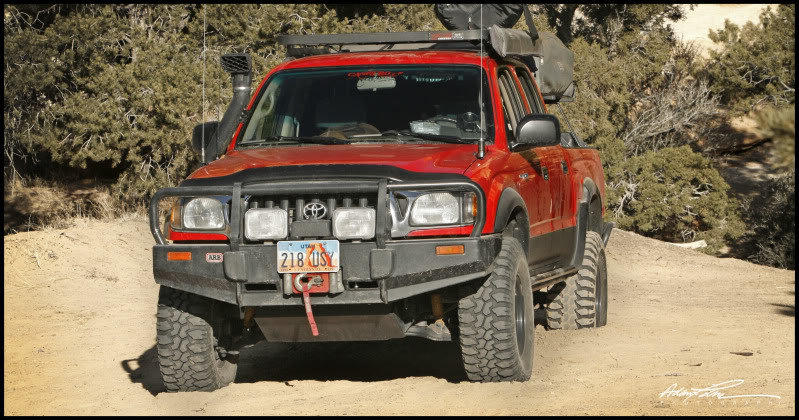

    Basic Specifications:
    OME 882 front coils w/10mm poly spacers & 10mm aluminum top-out spacers
    OME Nitrocharger Sport Struts/Shocks
    Dakar Springs w/AAL
    Maxxis 32" Bighorns on steel wheels
    OEM E-locker in rear axle
    Energy Suspension Poly Rack & Swaybar Bushings
    Notes: I had been thoroughly pleased with the Old Man Emu (OME) kit on my previous Tacoma, when the time came to setup this suspension it was somewhat a no-brainer. However I did switch up a few things from my previous setup. As the front axle weight of this truck had greatly increased, I needed to bring up the front a bit. We experimented with about 5 different spring/coil/spacer combo's until I found the the current setup which has seemingly solved my woes. I've since installed similar setups on other 'heavy' front Tacoma's and 4Runners and found it to be a rather satisfactory setup. The rear axle weight was also much higher on this truck with the addition of the RTT and Bakkie Rack setup, weighing ~200 lbs of constant weight. To combat the added weight I added an OME additional leaf to the spring pack. Old Man Emu did not initially have an AAL application for this model but I had the luxury of having a pile of their different offerings in stock to play around with. I had actually been through this on a customers truck a few years earlier so when it came time to bump up mine it was literally as easy as bolting the desired leaf in. In the last couple years I have been using a hitch mount dirt-bike hauler to move around my 300 pound dirtbike, the suspension squats a bit under its weight and leverage but really holds its own even when full loaded for a trip, perfect! There are higher performance (adjustable & remote reservoir) front suspension components available for the Tacoma however for my needs the Old Man Emu components strike the perfect balance between performance and longevity with an attractive price to boot. Many of the upgraded adjustable coil-overs don't fare well in Utah's harsh and salty winters or caustic desert environs. Having to rebuild a coil-over regularly or deal with a blown assembly in the middle of nowhere wouldn't work for me thus cementing the OME option. It has rarely left me wanting and given my uses for this platform I would absolutely repeat. (Update: OME now offers the OME D6XL additional leaf for the CS046R leaf springs, if I find my springs apart in the future I might swap them out with the AAL I've been using but is far from a priority as its working fine as-is)
    Lift/tires - Check.
    I've dabbled with a variety of different tires on my 4x4's over the years but the last set of tires I put on my previous Tacoma had really proven themselves to me, the Maxxis Bighorns. While I don't feel they get the longevity of other similar mud-terrain offerings they work well in various off-road conditions and have stalwart sidewalls. I've now had 4 sets of the Bighorns on my Tacoma's and knock on wood I've never had a failure of the tire in fact I've had just a couple of leaks caused by sharp rocks or nails/screws. Its far from conclusive but its won my repeat business.
    San Juan Mountains, Colorado

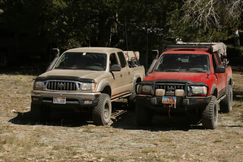

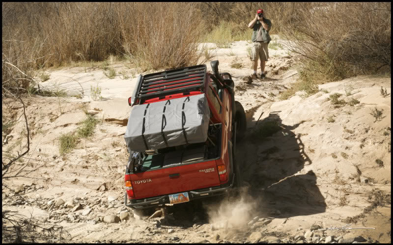

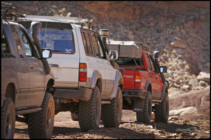

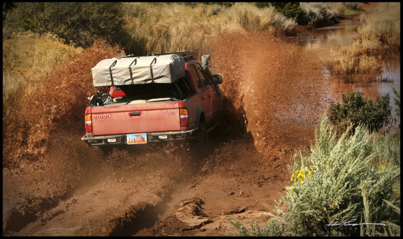

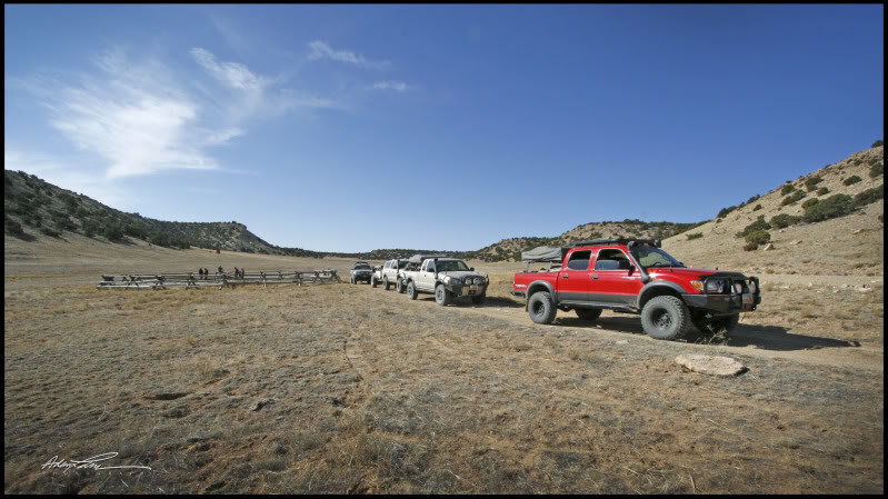

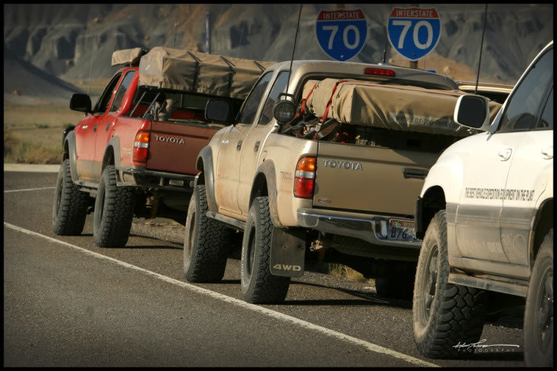

    adding a few pics in memory.

    Great shots Adam, thanks for adding those. While it makes the grieving* process a tad harder I can't help but smile at all the fun trips :D
