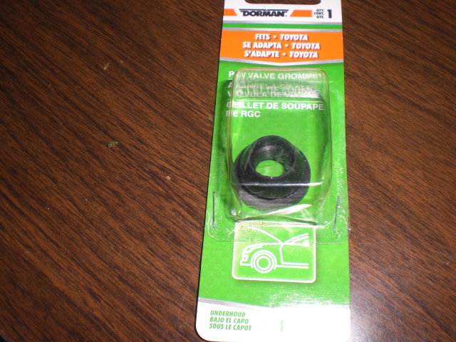

    Yeah those little gromets are the devil.....perfect storm....they set there for years unnoticed, cooking into a hard ceramic...
    Probably more vac leaks than you know.....bottom has broken off, and you never know....
    After going on my own fishing trip....I make sure to change that at least every 24 months.
    Always go score another right after putting new one in for a reminder....
    And I've found its better to attack it with two hemostats........otherwise, might have to go fishing....
    And for god sakes, take the cover off.....its not that big a deal.
    as a bonus, you can check valve clearances while your in there.
