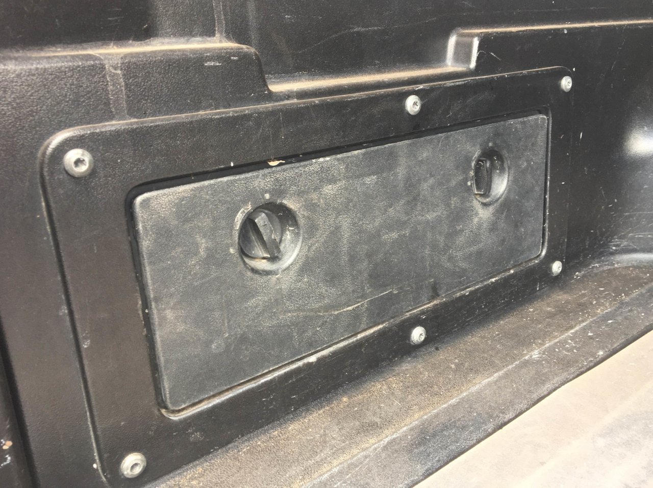

    I originally commented on this issue in a thread on Toyota eliminating the drivers side bed cubby....

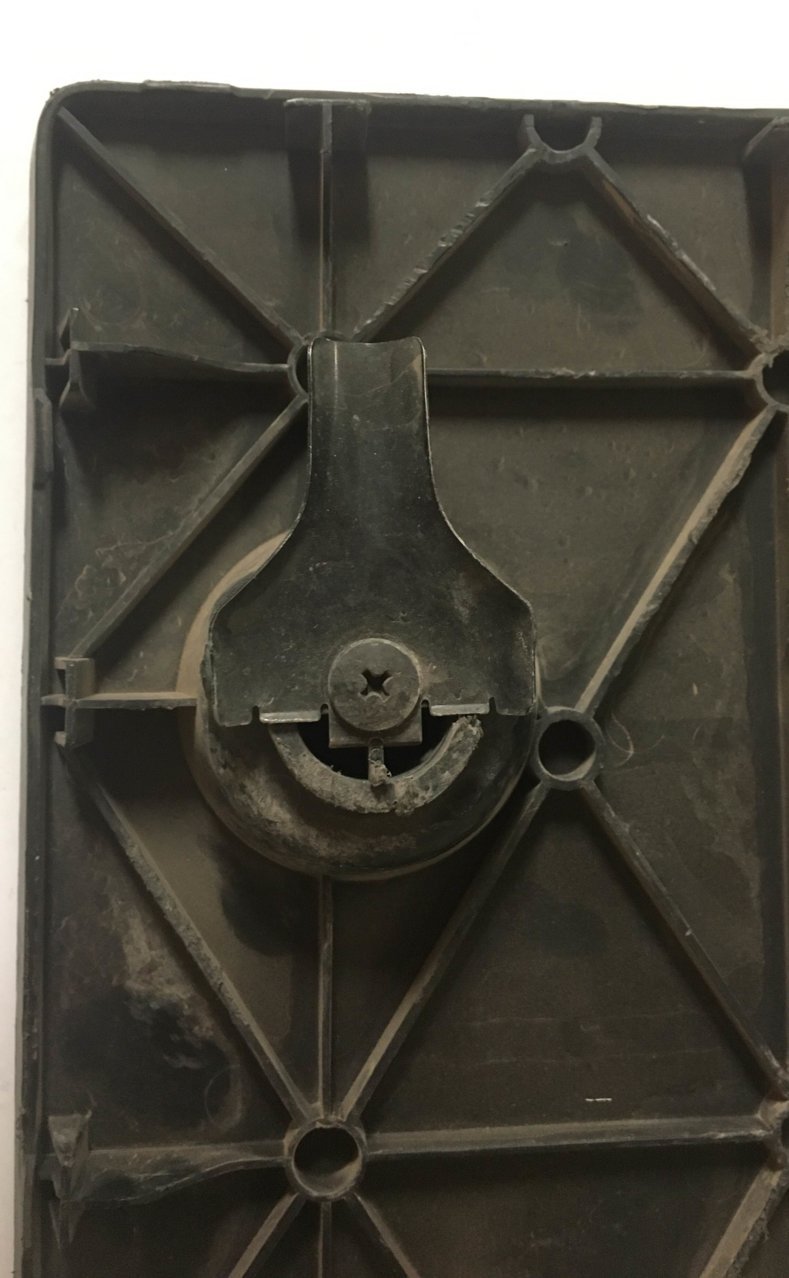

    Toyota used the most flimsy sheet metal inner latches to keep both bed and under-seat compartments closed. They bend and flex and work themselves open letting the contents loose in the bed.

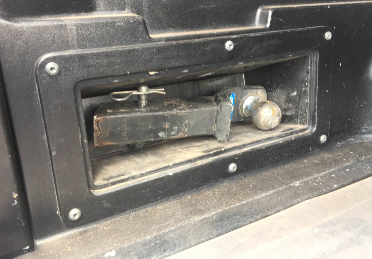

    I store my hitch & ball in the bed driver side on the 2009. A little bouncing from the hitch against the door and the force just bends the latch until the door rattles open and the hitch winds up bouncing in the bed.
    The double cab under-seat storage uses the same junk, and they are mangled also from continuous use.

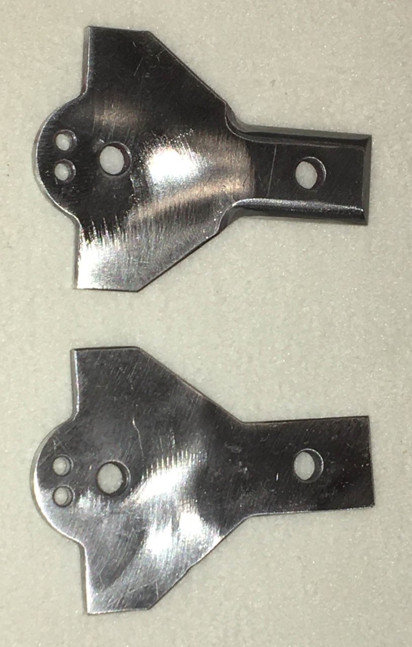

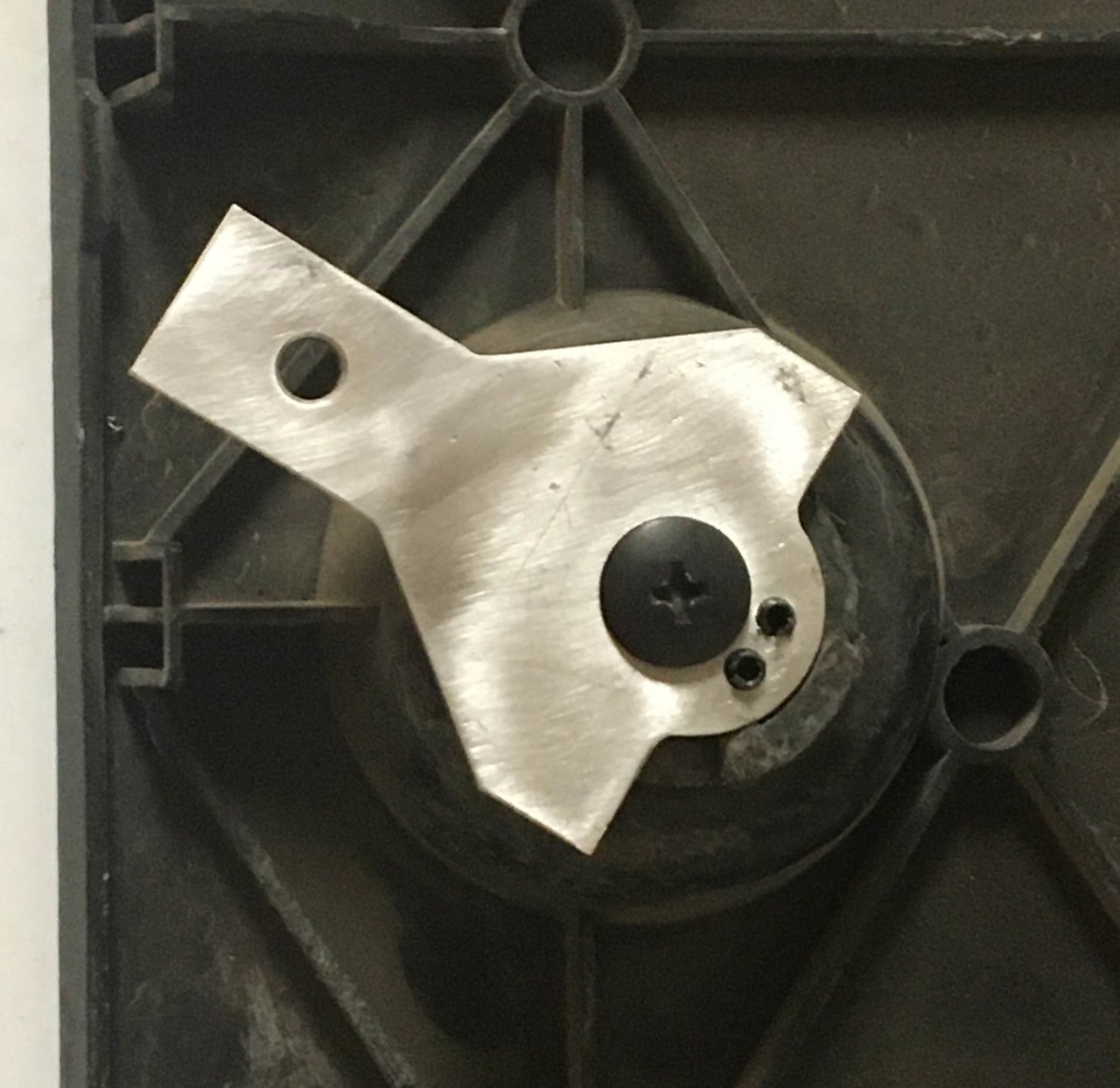

    I made new latches from 1/8" Al. Two roll pins straddle the knob web in place of the original comb fingers. Im thinking about anodizing them next.
    So far they seem to be working much better.

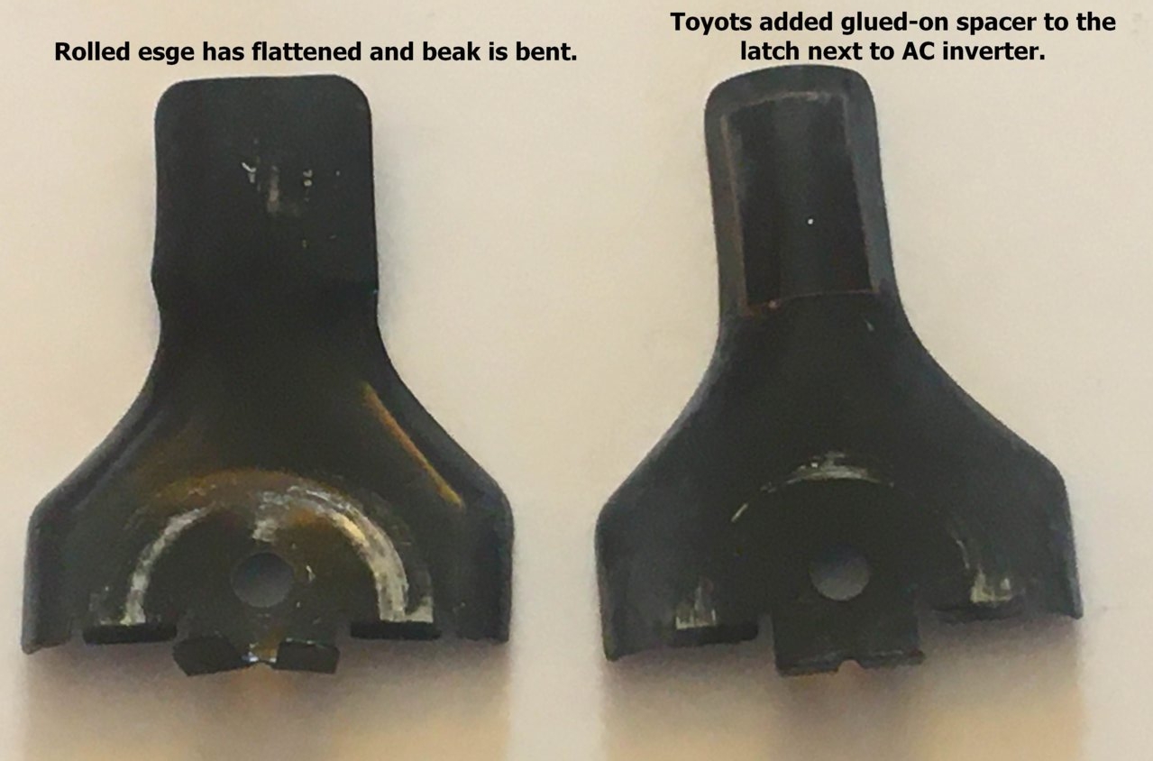

    Here are 2 of the latches. Failed one (left) is from under-seat driver side. The other is from the small cubby next to the AC inverter. I wonder if the little patch was a factory fix for a loose fitting latch cutout?
