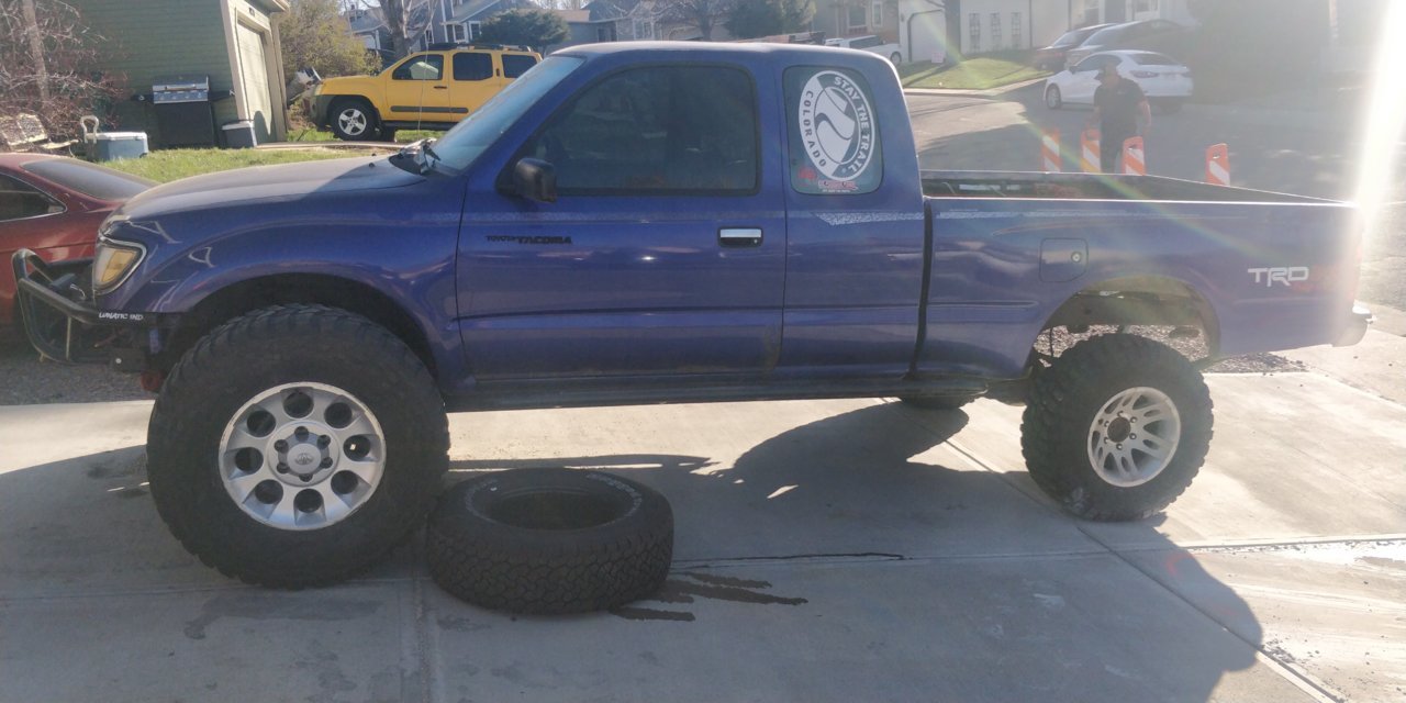

    I spent almost no time working on the Tacoma this winter except to put in a new switch for the bumper light bar...
    I got the Trepadors mounted and decided to go with airsoft BBs to balance them since they're gonna get chunked up and need to be rebalanced often anyways. I had good luck with BBs in the past on a set of bias ply Super Swampers so I hope that they work again.
    Some tubbing may be required :thumbsup:

    All the cool kids getting big tires :pout:

    Ahhhh....those wheels....love 'em.
