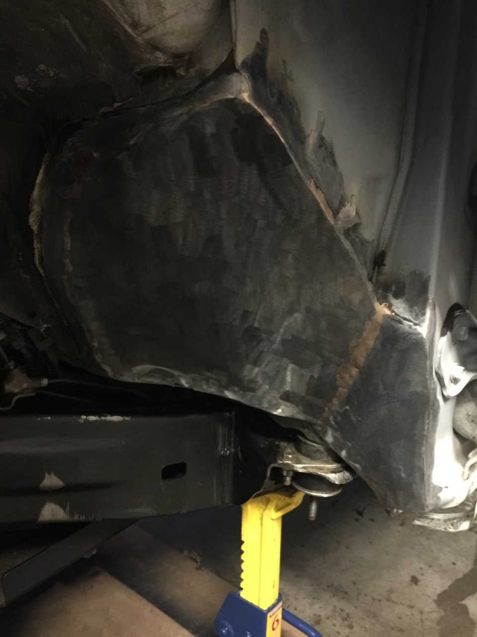

    Nah, I got lucky and so far I’ve had zero clearance issues running 315s and the only leak issue I had was thru the wire grommet into the cab. But I’ve know a few dudes on here that have had issues with leaky tubs and I’m pretty sure there was a member who didn’t take enough off and had to go through the cut/weld/seal shittiness again.
    I’d say just take your time and go past what you think you might need. In fact, I scored some stock bumps from Tim the Shock Dude that were cut down to half their height to use as the bump limit to build in some margin. I cut out a shit ton, but I don’t rub up front. (The rears are a different story :anonymous:)

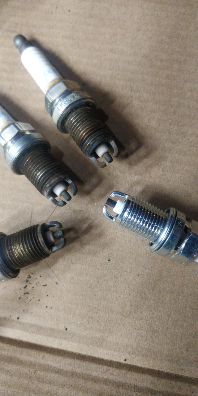

    Spark plugs came in, didn't have a lot of time so I only did the driver's side. These plugs only have 23K miles on them o_O

    Changed the other 3 plugs this evening, found a vacuum leak while I was at it.
    I guess the truck runs better? Can't really tell much of a difference but I only drove it a couple blocks

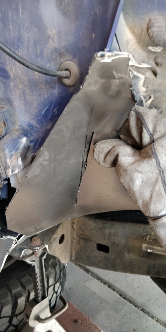

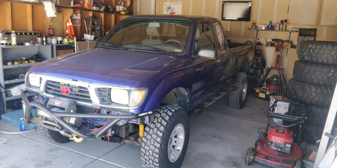

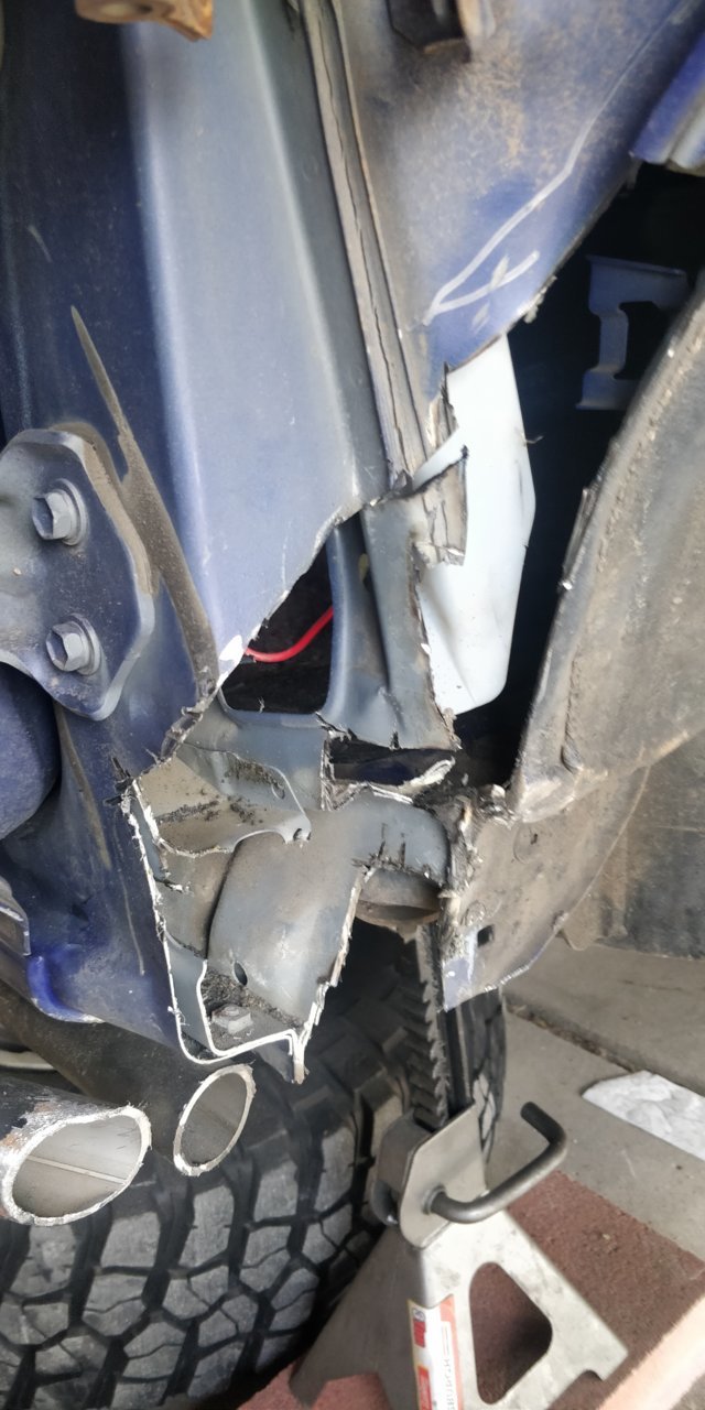

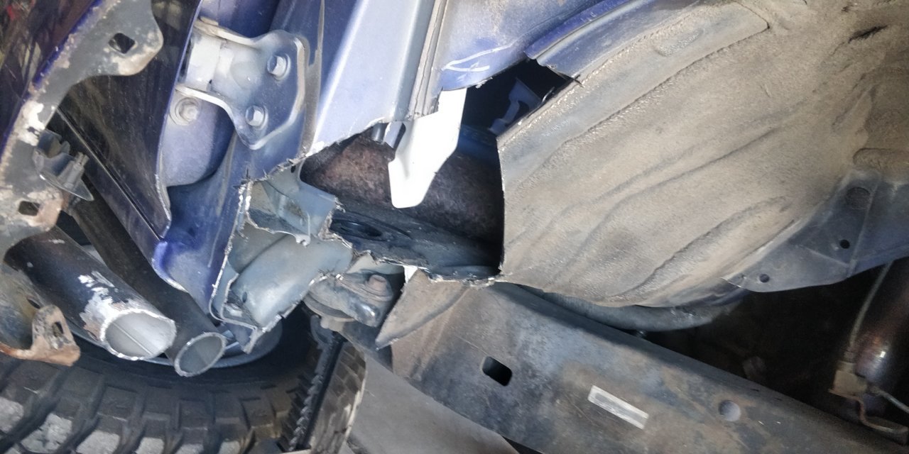

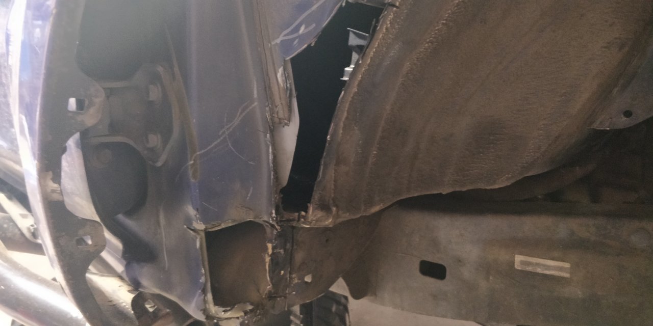

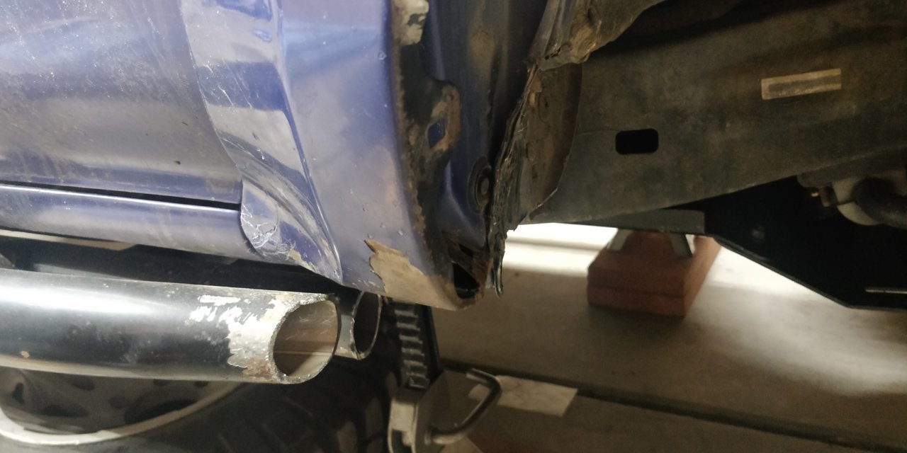

    I had my sliders welded on way back when because I didn't have the skills or tools to do it myself at the time. They ended up being welded a little too close to the front wheel well so I had to cut the slider some
    Didn't get as much done as I'd like but slow n steady n all that

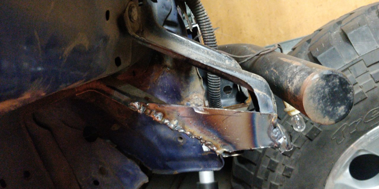

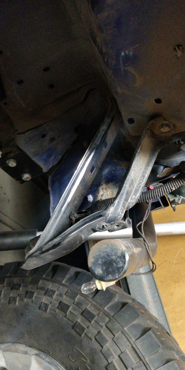

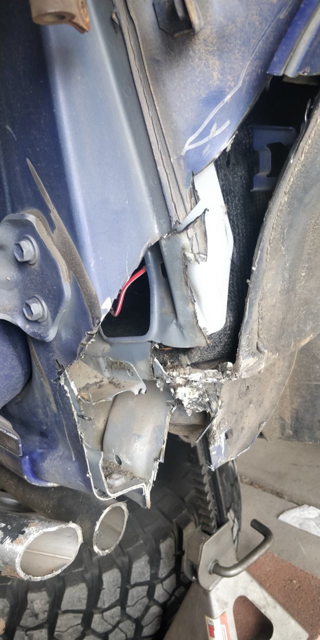

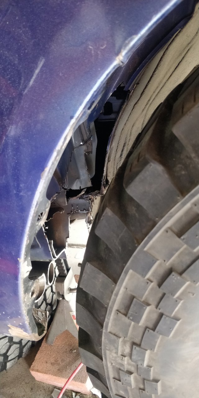

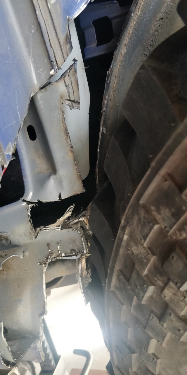

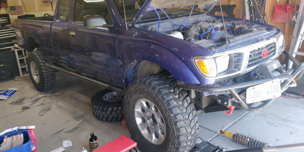

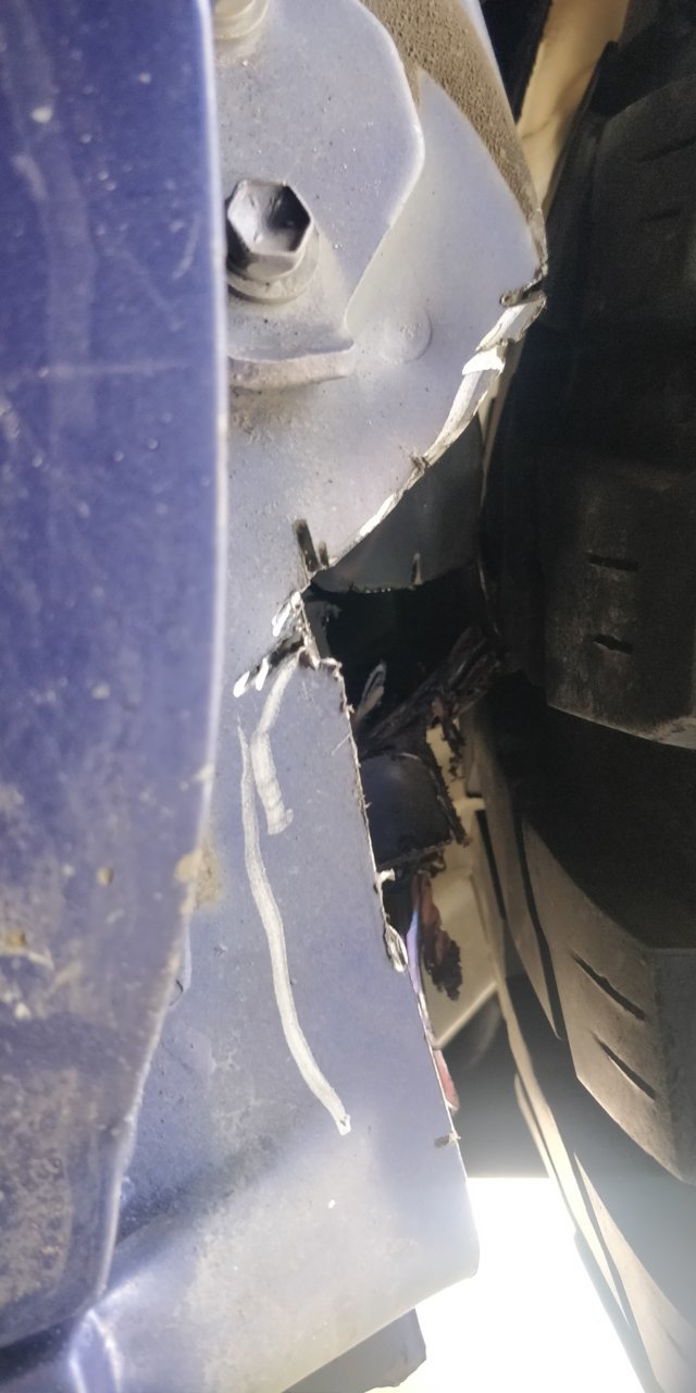

    I wish my truck was emo so it would cut itself
    IMG_20190504_161931.jpg IMG_20190504_162943.jpg IMG_20190504_164632.jpg IMG_20190504_165417.jpg IMG_20190504_165055.jpg
    Another hour of progress, still have cutting to do but it's better than before

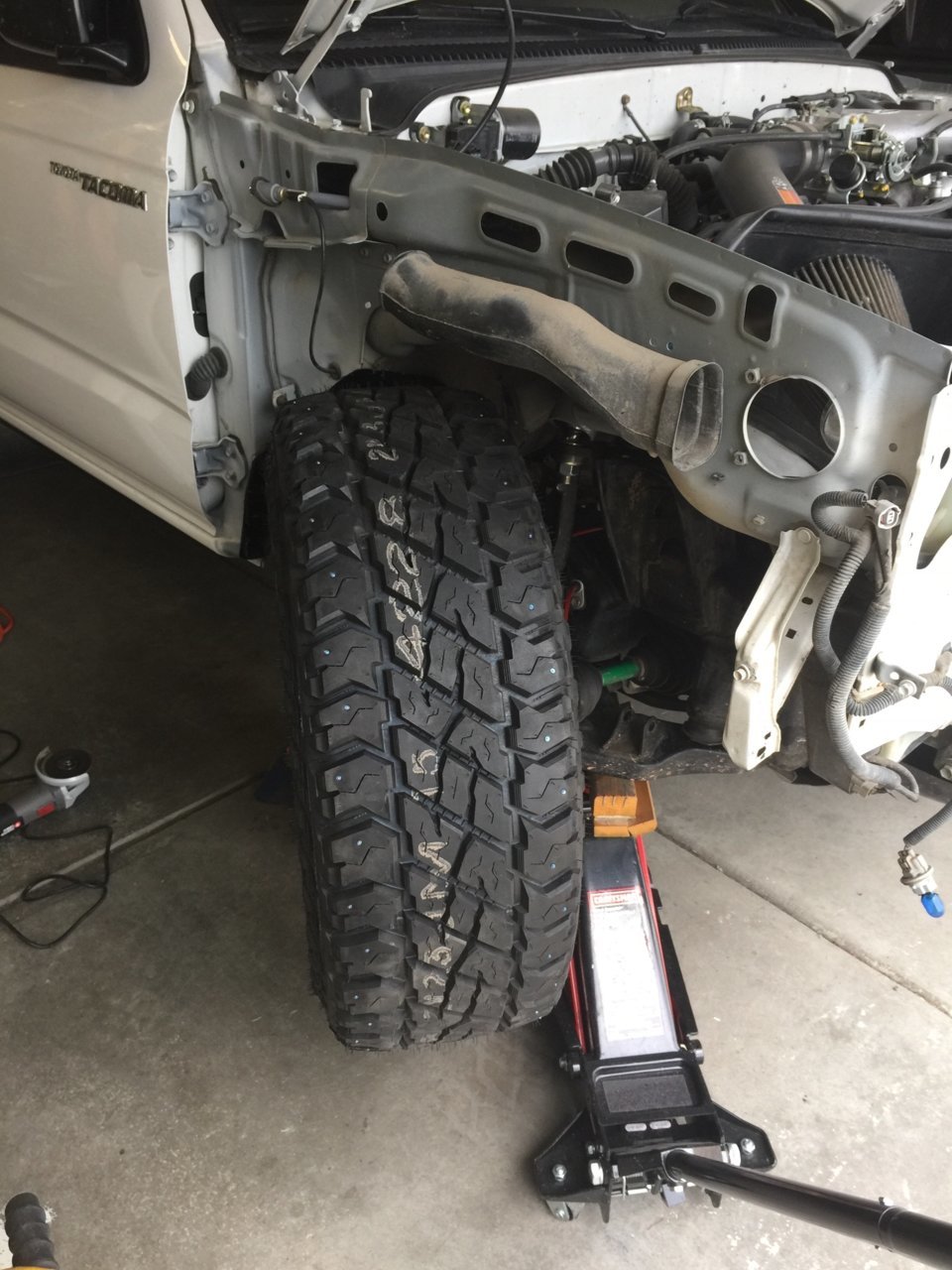

    Got part of the passenger inner fender tacked in
    IMG_20190505_121708.jpg IMG_20190505_123837.jpg IMG_20190505_154906.jpg IMG_20190505_162008.jpg

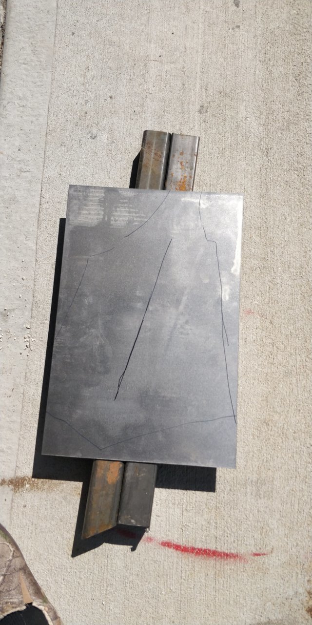

    Thank you, I have been dragging my feet with working on this truck lately and I appreciate the encouragement :) Ive been working a lot and have not done a good job with time management for this truck as of late...

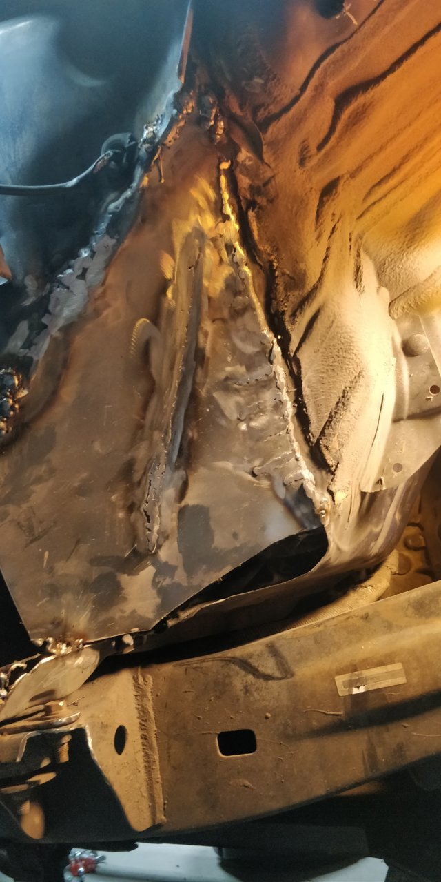

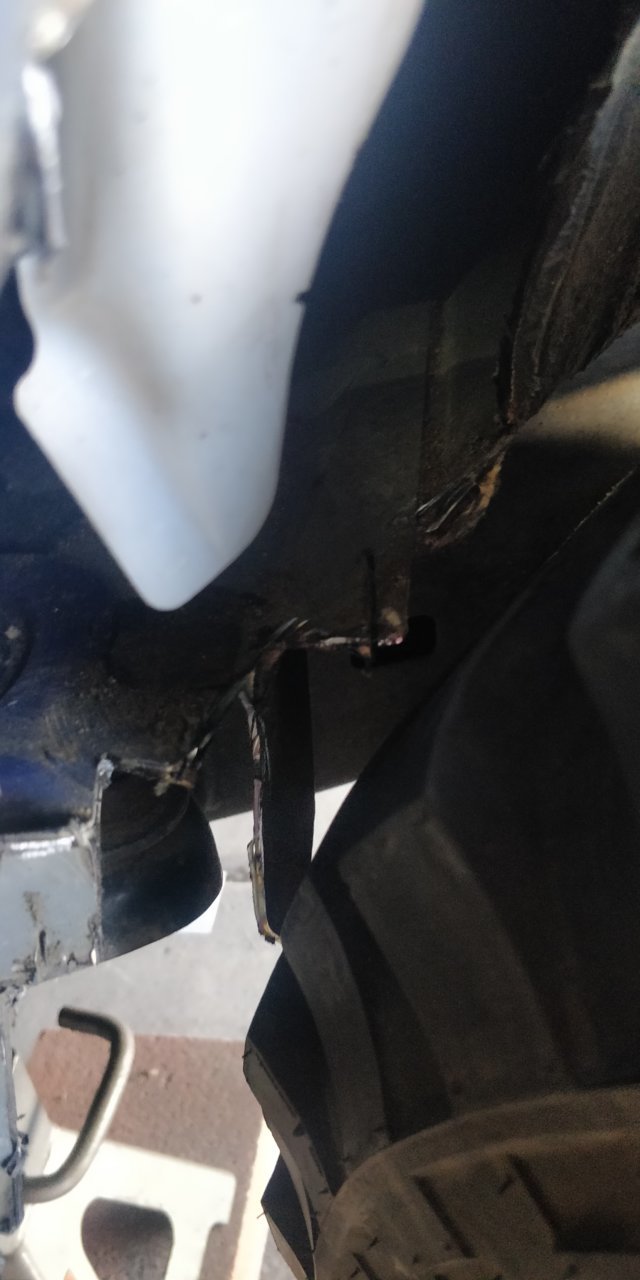

    Fender support needed to be trimmed so I found a scrap to booger weld on there. Got lazy and didn't want to adjust the welder setting for the thinner metal :rolleyes:
    Made about a million tacks and then did lots of grinding even though it will all be covered with seam sealer and undercoat. You can see where I cut it and hammered it into place along the right side.
    Wish I hadn't been so lazy in cutting, I'm gonna have to make a couple fun size pieces to fill in the rest of the fender :facepalm:
