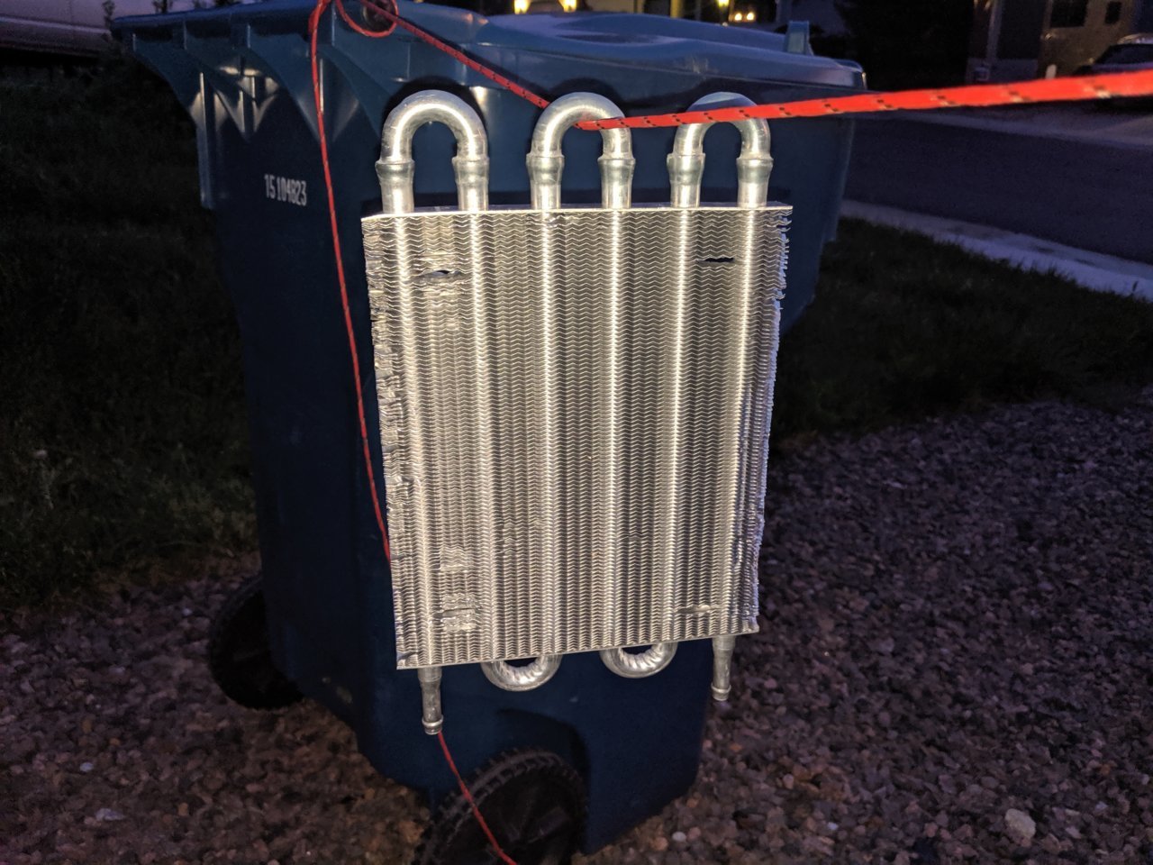

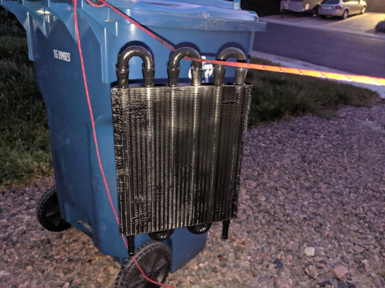

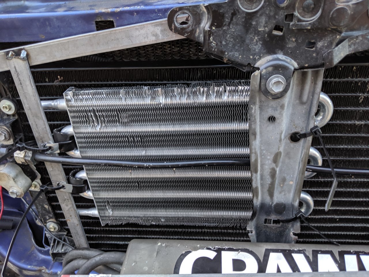

    Cooler for PS came today so I drained the reservoir, disconnected the low pressure steering line, and started to install the cooler. The cooler comes with cheesy zip ties to hold it to the condenser/radiator, which I was going to run, but they were snapping as I snugged them up.
    I'll have to come up with some kind of mount. Not sure if I will put it in front of the condenser or if I can tuck it in the passenger fender and get enough passive cooling that way.

    I can probably fit it on the top of the fender well without having to worry about the tire rubbing. Not sure if the UCA would hit

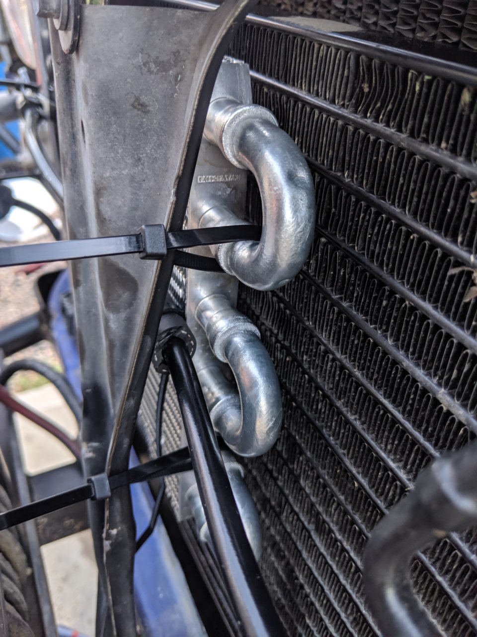

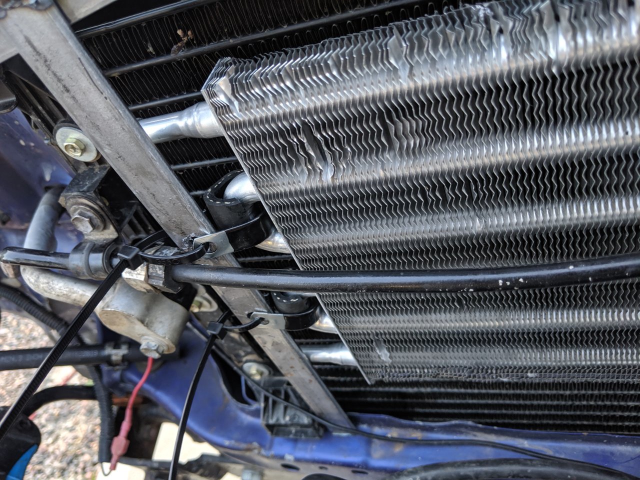

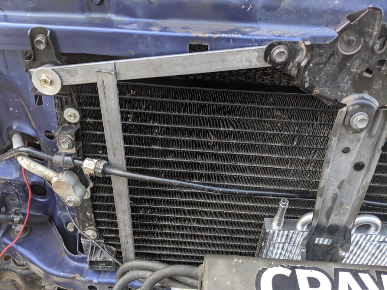

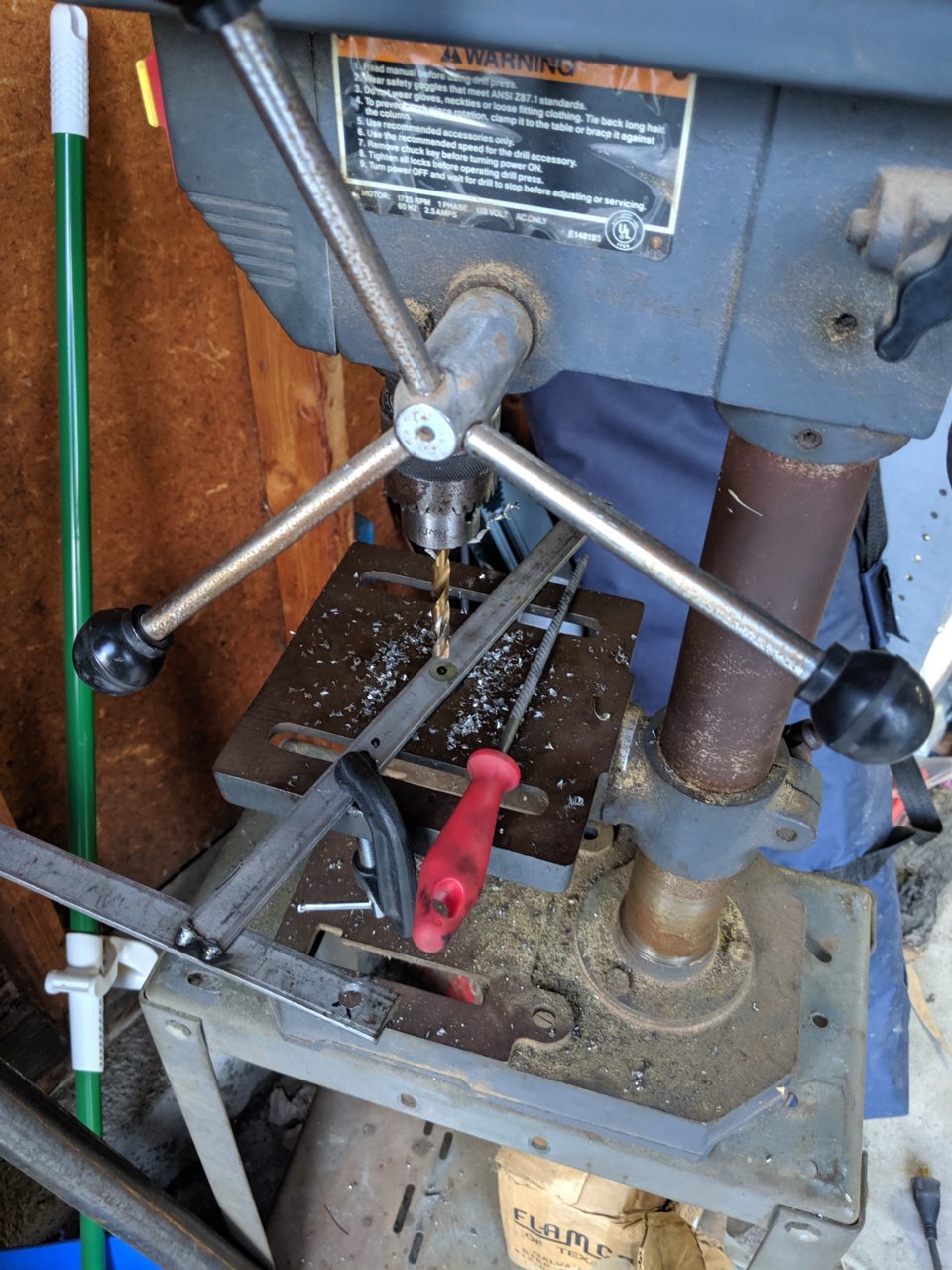

    Need to come up with a better way to stand the cooler off of the AC line at the center of the core support but I figured out more or less how to mount the cooler. I think I'll get a steel bushing from the hardware store to push it back 3/8~ if I can. the cooler and bracket I made came off for a coat of Rust-Oleum engine paint so they don't stand out so much
    IMG_20190802_192200.jpg IMG_20190802_194130.jpg IMG_20190802_195114.jpg IMG_20190802_195117.jpg IMG_20190802_195108.jpg IMG_20190802_203626.jpg IMG_20190802_203912.jpg

    Been a while since I heard a good emo joke

    I love the fact that you used a drill press to be precise, but then followed it up with like 8 zip ties lmao
    Wulf[OP] likes this.

    Don't worry, that was just for mocking things up. The final version will have at least 12 zip ties :luvya:

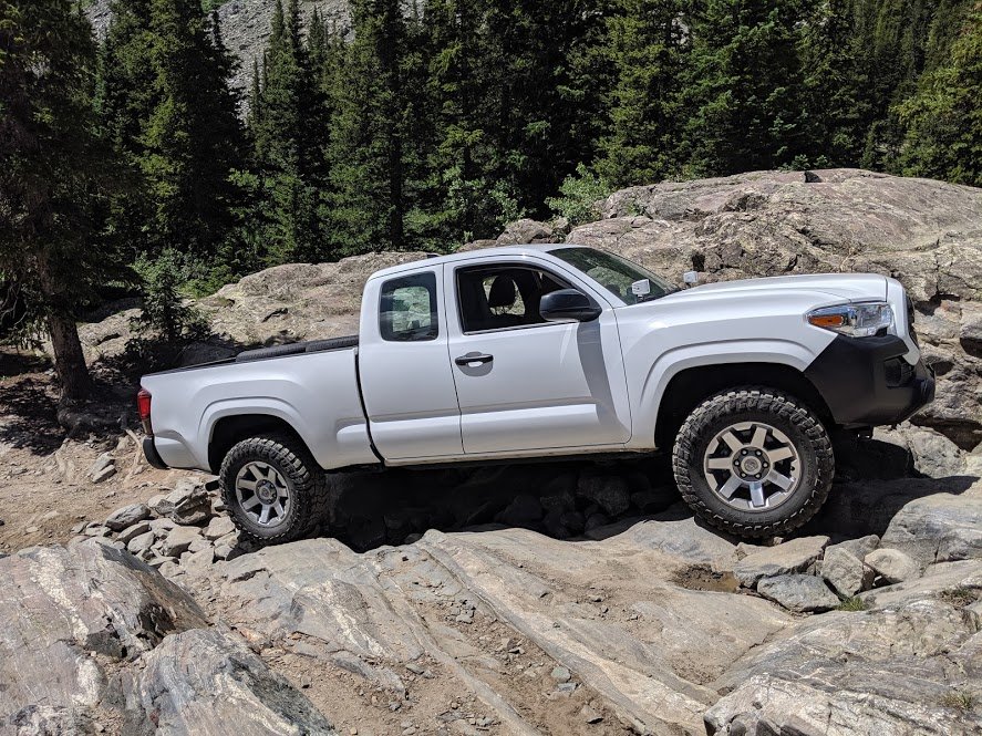

    Last weekend's trip started in Ouray:
    Thursday we took Mineral Creek / Engineer Mountain to Animas Forks. We took California to Hurricane to Corkscrew out.

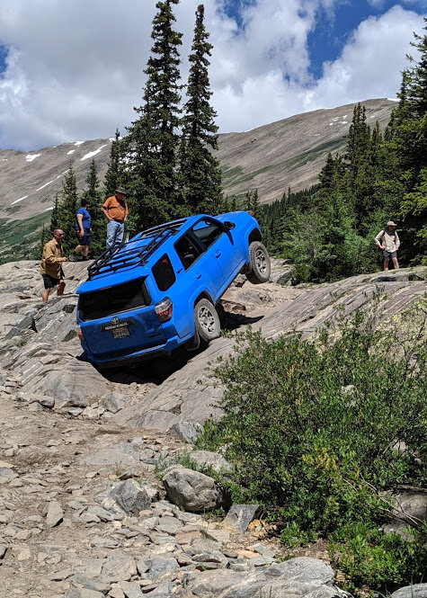

    Sunday we ran up wheeler lake. It was a bit of a shit show as there were already 40~ jeeps up the trail for the All4Fun group event by the time we got there. Going up we got caught up because one of them flopped their TJ at the V notch, then coming down we spent a lot of time waiting for them as they came down in a bunch of smaller groups. No clue how they were able to park so many at the top.
    Aside from that we all made it to the top and got to enjoy some beautiful views :)

    I made it through everything effortlessly save for the V notch, where the 35s and stock gears really made it tricky to maintain enough control to get up and over.

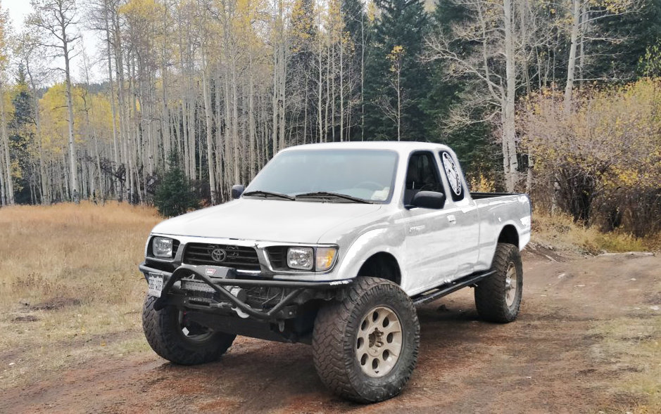

    I've been thinking about doing a paint job to make the truck a little more presentable. @eon_blue whipped up some pics to give me some ideas of what things would look like :)

    Wonder if a wrap would be cheaper than paint?
