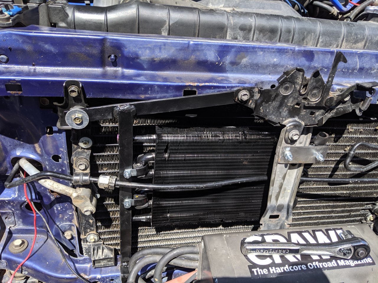

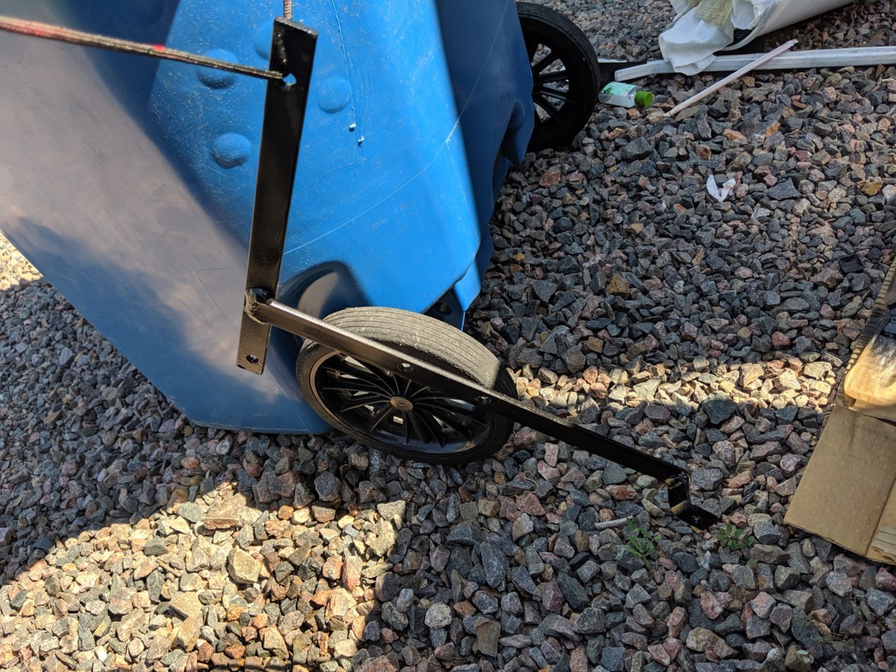

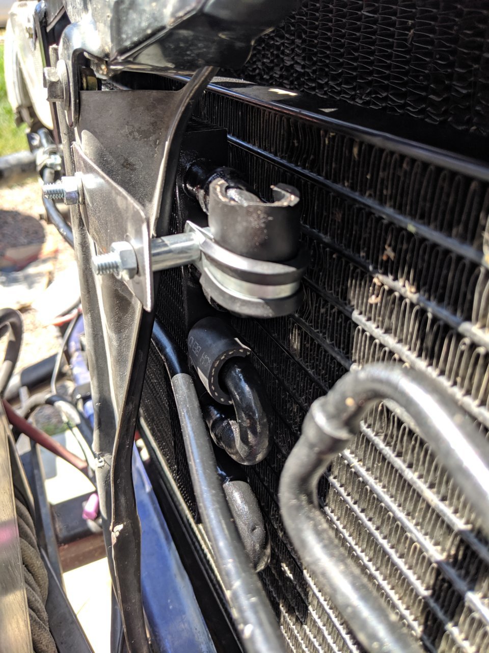

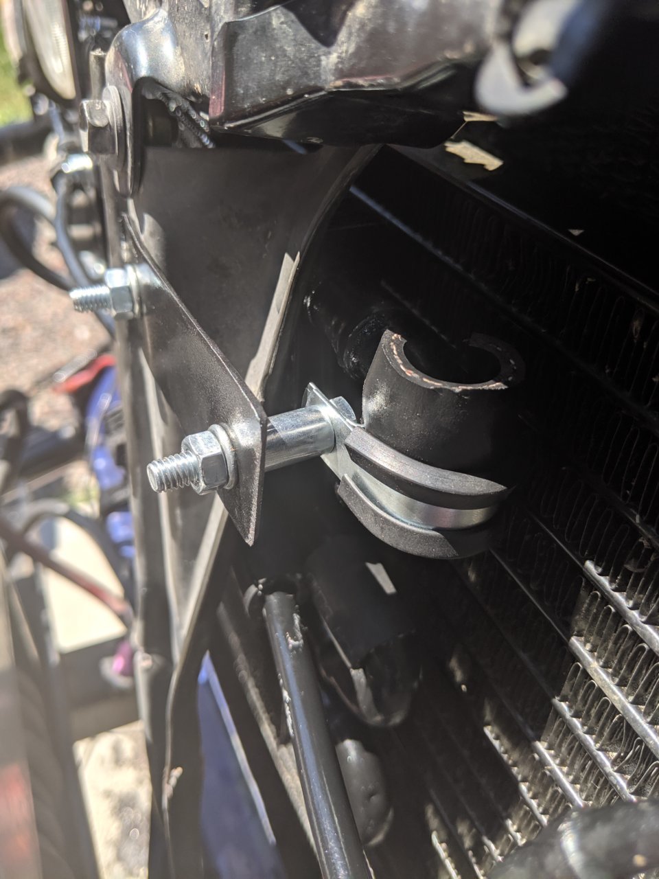

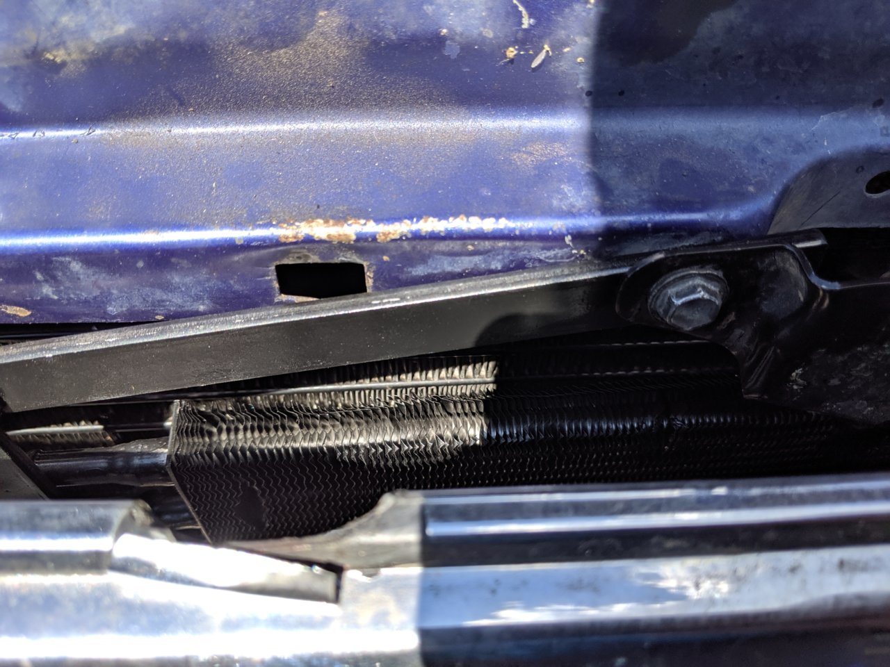

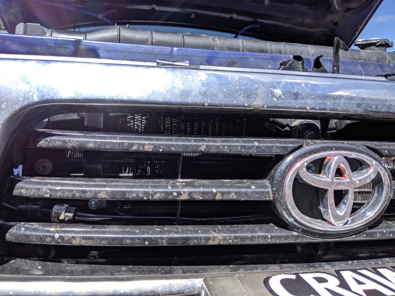

    Figured out my PS cooler mounting to keep it away from the AC line and the condenser so hopefully no damage occurs.
    I need to pull the center section off and paint it then it's ready to get hooked up and stuff
    IMG_20190803_102545.jpg IMG_20190803_121822.jpg IMG_20190803_121736.jpg MVIMG_20190803_121956.jpg IMG_20190803_121947.jpg

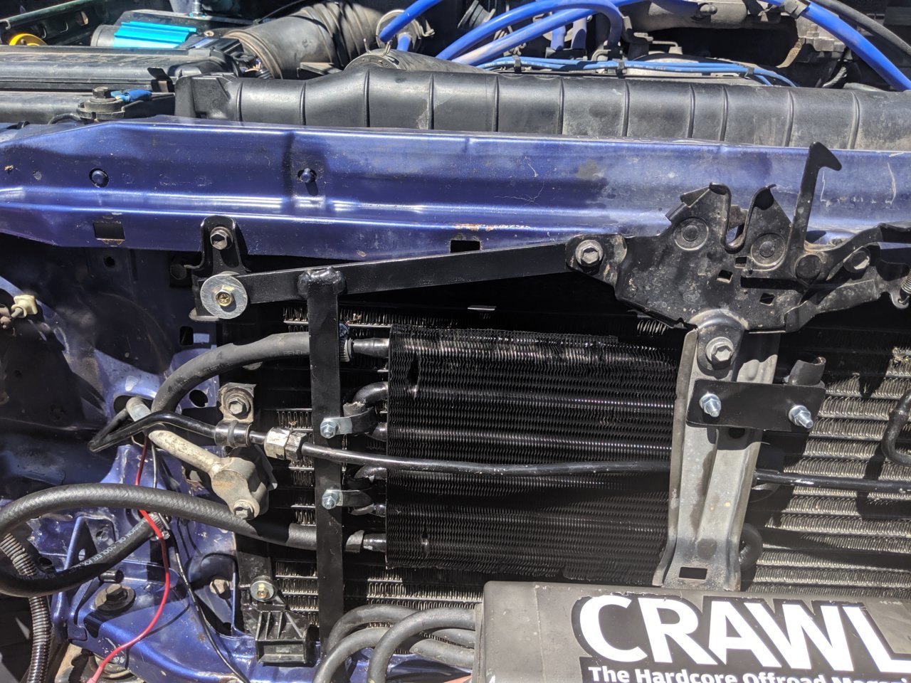

    All bolted in
    Here's what I came up with to keep the cooler from rubbing the condenser or its lines

    So I guess getting an aux cooler in will keep me from ever getting lights in behind the grill again huh?
  12. Aug 4, 2019 at 1:48 PM
    #292
    jubei
    jubei would rather be doing something else
    Mar 17, 2016
    #181549
    6,062
    Jason
    NoCo
    White 2002 XC TRD and Yellow 1971 JEEP CJ5
    Stuff. Also things.
    I was surprised at how constrained things were in there when I put my cooler in. With the AC lines and brackets and stuff it just doesn’t leave many spaces open for the cooler itself, much less a couple decent size driving lights. But maybe there are some light options out there that are a bit thinner profile? I know my cheap 7” leds would still be too deep to fit behind the grill.
