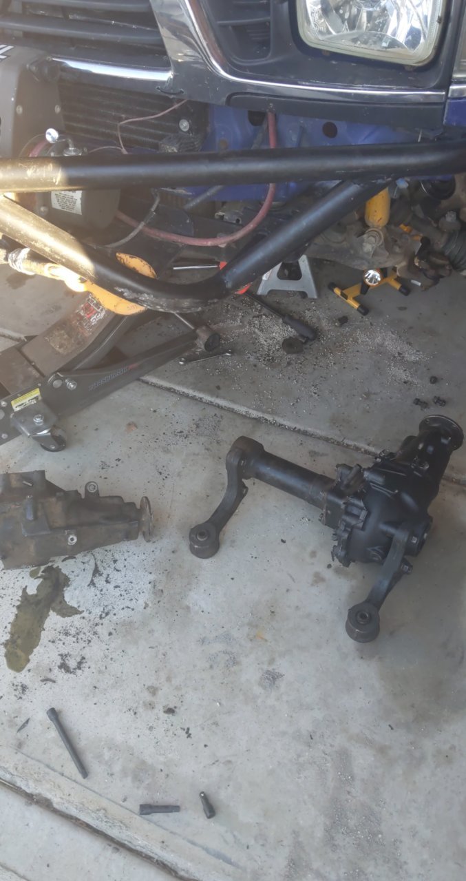

    Last night I took the skid and both hubs off and got the CVs pulled and got the front diff drained. I should be good to drop it tonight after pulling the driveshaft and unbolting it.

    Little more progress today. Swapped axle tube and brackets to the new diff

    That’s a good thing to have behind you. Those external torx bolts that hold the tube to the diff suuuuuuuuck.

    Interesting, mine were standard hex head bolts. They were in there really good though

    Mine were gronked in there really good too, and those torx bolts just wanted to deform. It was the opposite of fun, for sure.

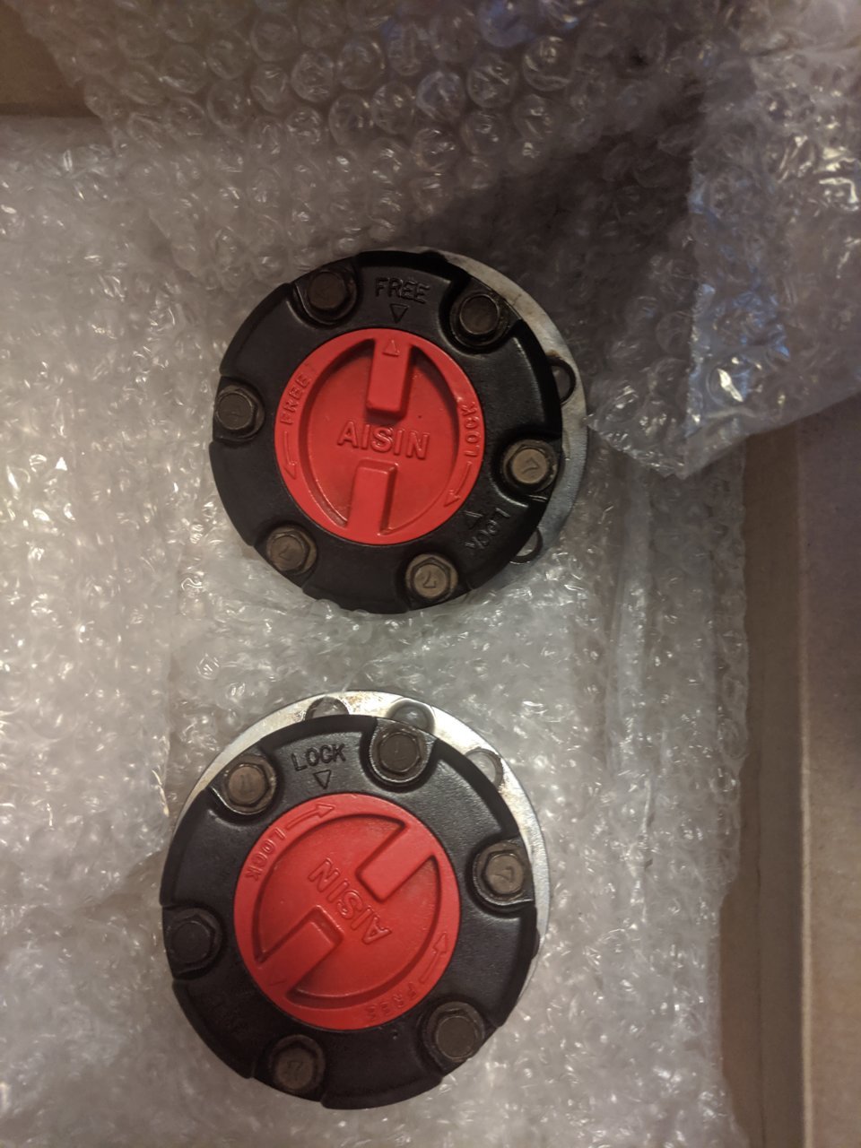

    Have you heard of the manual hubs being a failing point?
    Sometime soon hopefully i'll be doing an ARB in the front with my manual hubs as well. I already carry spare CV's, but have never heard of the hubs themselves being something that commonly fail.

    @Reh5108 , didn’t your manual hub grenade itself when your CV blew or something?

    From what I remember reading, his CV broke inside the hub which caused problems and screwed up that brass ring part in there.
    More related to CV strength than the hubs themselves breaking.

    I have heard secondhand stories about breaking them. I know my buddy with a solid axle Toyota has broken them; those are the same design as our hubs. said I'd rather have my CVs and hubs be the weak point so I'm not breaking gears instead

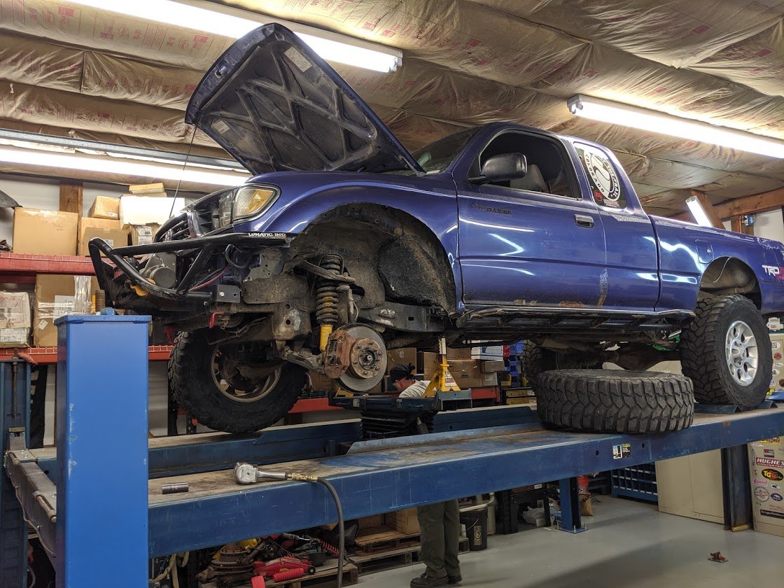

    A little update; yesterday my buddy came over and helped me get the front together enough to load up the truck and drag it to his shop which he has been generous enough to offer to me.
    After getting it there I put the hubs on and bolted up the front driveshaft before calling it a night. The only thing left to do for the front diff is to fill it and hook up the airlines.

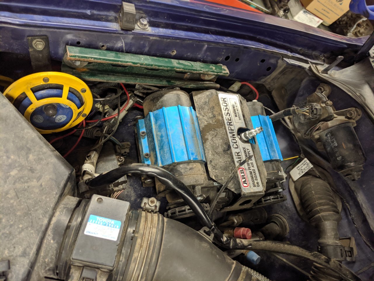

    EDIT: where did you end up mounting your compressor and switches?

    Not sure I have a pic of the compressor mount but I built one that bolts to the fender behind the factory airbox so it sits on the passenger fender close to the firewall.
    I have a paranoid fab bracket that mounts where the ashtray was which is where my front lightbar and compressor switch currently are. I'll add the switches for the F/R lockers there as well, though I have a feeling I'll be wanting to move stuff around

    Front is all together and filled. Still need to do everything for the ARB
    @betterbuckleup here is where/how I mounted my compressor. I was meant to be temporary but I haven't found a better spot for it yet. The unistrut is welded to a 3/16 bracket with a piece of ? Gauge sheet metal that the compressor is bolted to.
