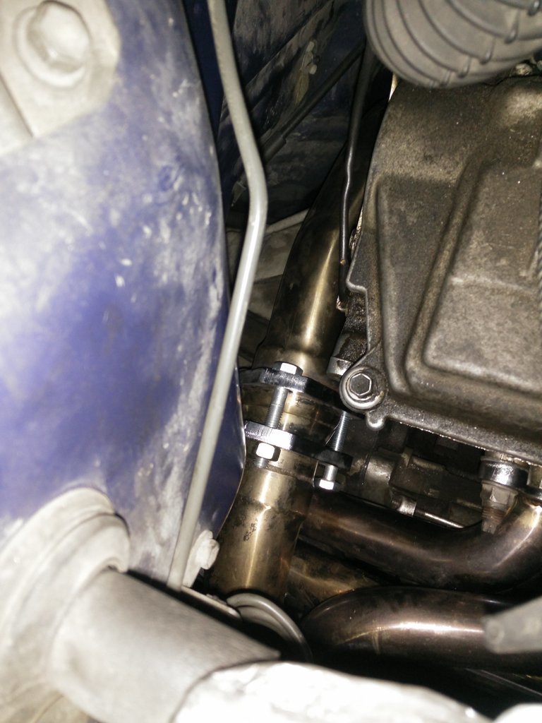

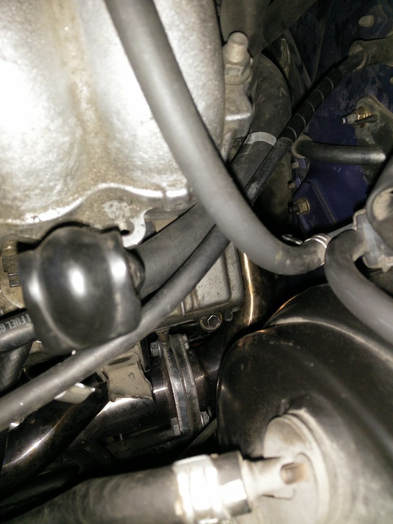

    Super bummed and incredibly frustrated.
    Put about 50 miles on the truck and then it started getting loud. One of the nuts on the crossover connection wasn't tight enough so I guess it worked it's way loose and fell off. Due to the way it's designed the crossover connections on the head side are nearly impossible to tighten. I bought some stubby wrenches and they don't fit on either side. Short of pulling the head or unbolting all the connections and redoing I'm not I'm not sure what to do.
    The driver's side is equally shitty:

    Can you custom bend a wrench to fit? My TRD headers were a chore as well I can't imagine having to think about pulling them off

    That's not a bad idea. I'll have to mess with it later this weekend when I have a chance. I can get a socket on the back so I don't think all hope is lost yet

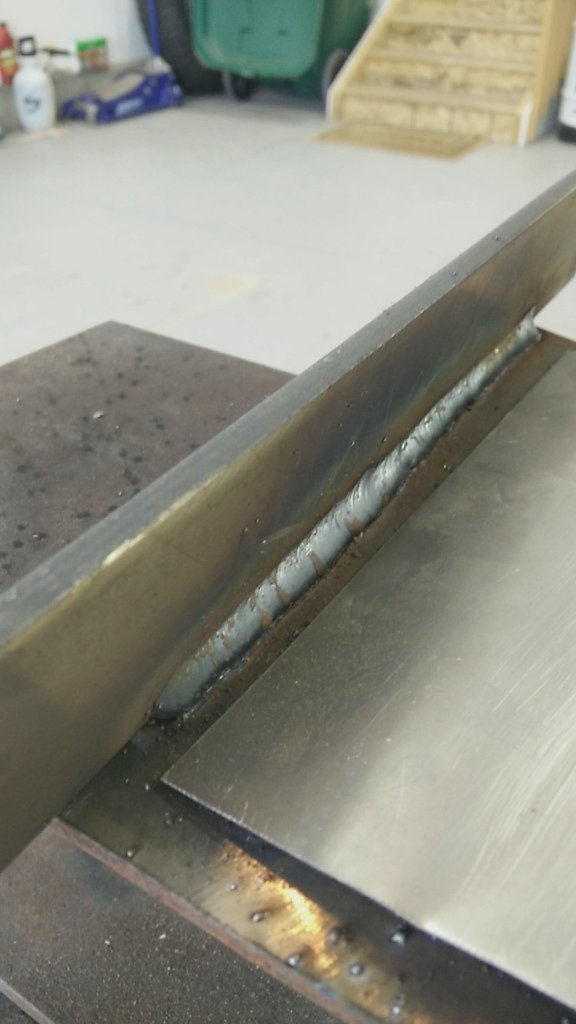

    Didn't make any progress on the truck but today I test drove a Millermatic 190.
    I haven't welded in over a year but picked it up pretty quickly. I tested 22ga and 1/4" and it's a mighy fine machine. Hopefully it will be mine in a few months.
    Unfortunately this is the only pic I took, I had it set a bit too low because I mis-measured the thickness. After cranking it up a bit I got better penetration.

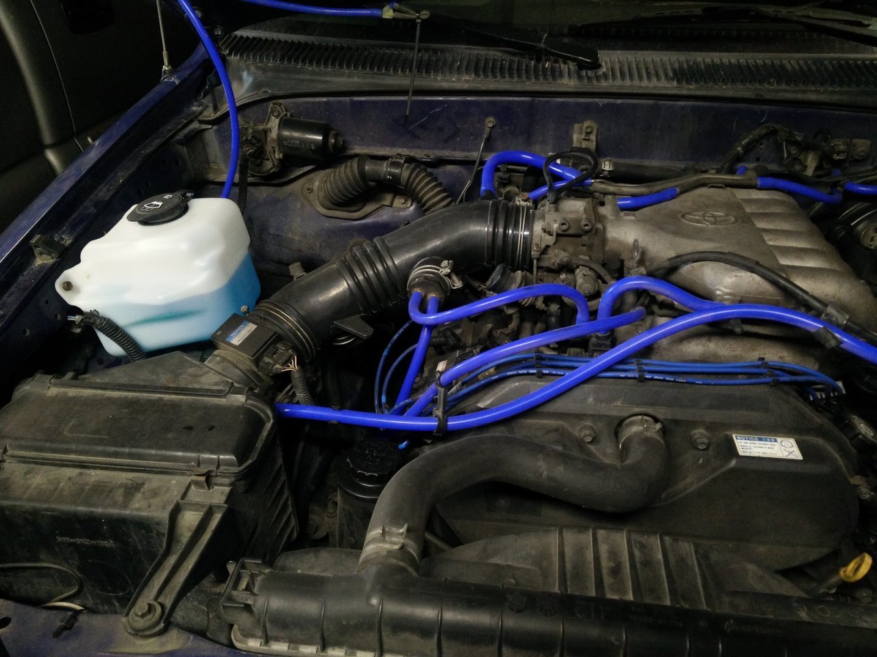

    I also replaced a lot of the vacuum hoses that were cracked and leaking with silicon.

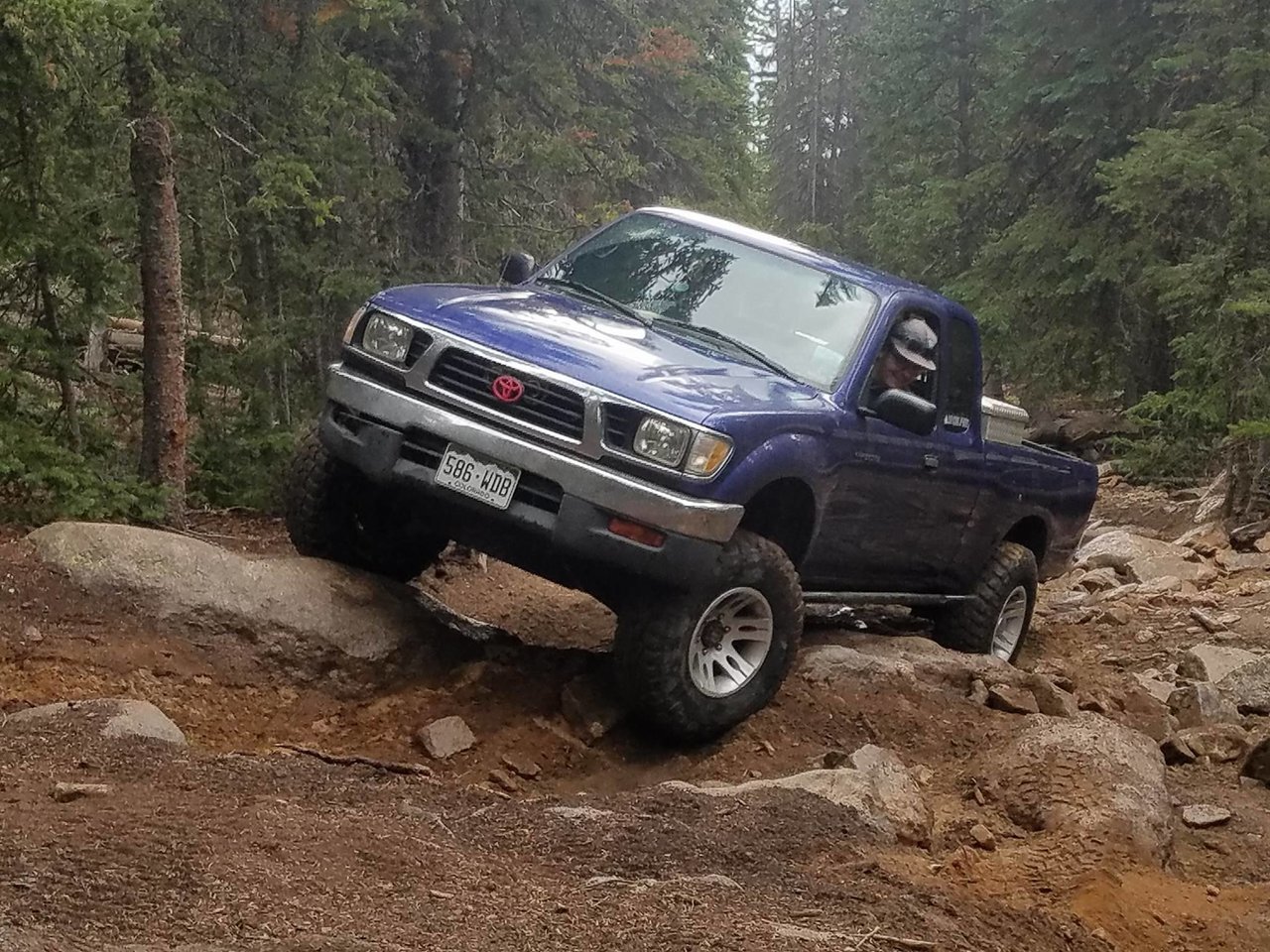

    Yesterday I ran Spring Crazy trail. IIRC trail damage rated it as 8-9 on the upper end, feel free to tell me I'm wrong if you have a subscription :luvya:
    Don't have a ton of pics, it was a pretty nice day but started raining before we got to the rock garden. I slid off a rock and kissed a tree with my bed, oh well. I reached up under and popped the worst of it out

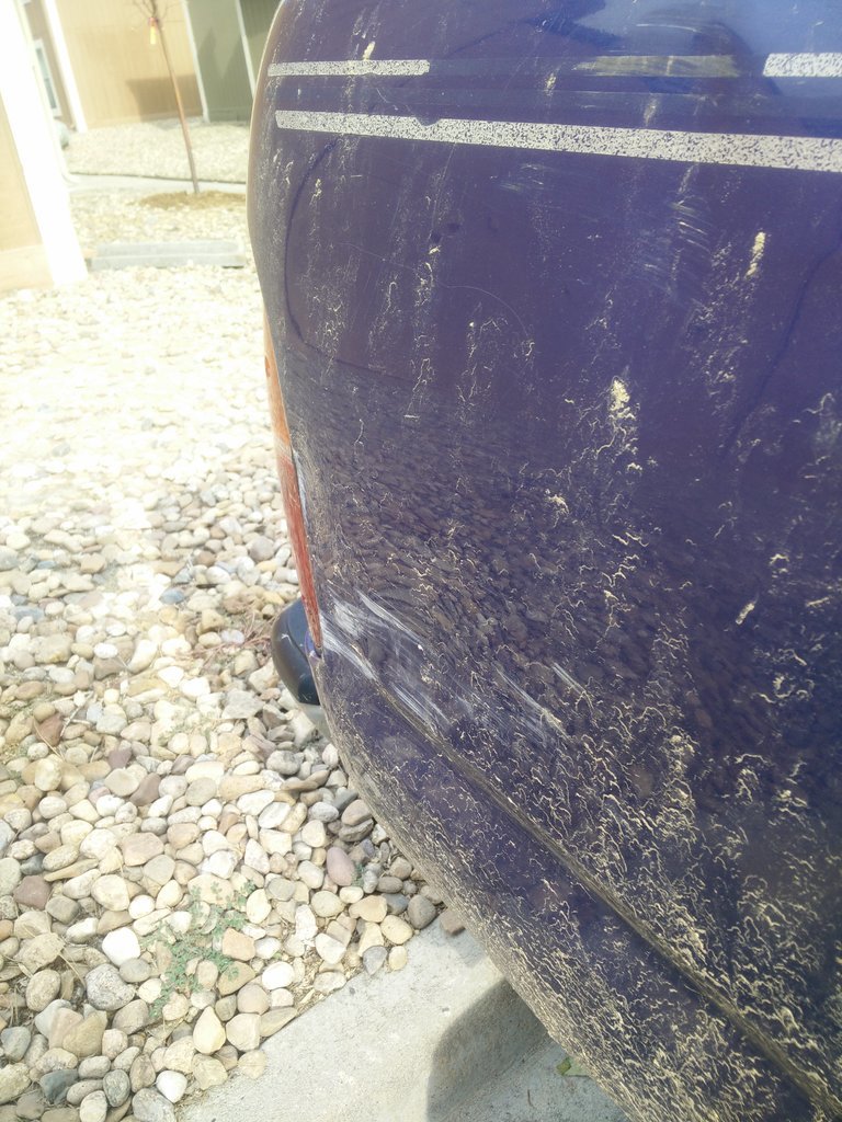

    the passenger side was rubbing on the tire when turning left because I kissed a rock with the chrome part on the trail last weekend. both sides were broken from wheeling / highway debris sooooooo
    I also installed a new washer bottle to relocate it to the engine bay and keep it out of harm's way.

    Ha! I did that washer mod a few weeks ago. Best low buck mod going!
