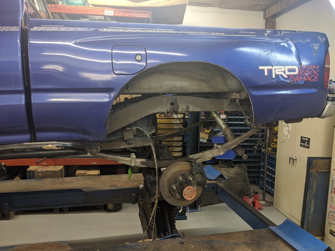

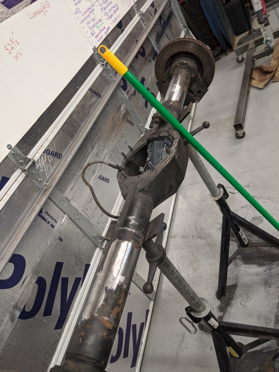

    Still poking along; I have been sick for the last week and then some. Today was slow going.
    I removed the rear axle and measured where I need to set the perches on the new axle. The perches and shock mounts on the Diamond housing aren't going to work for my setup so tomorrow they're getting cut off. I have new ones to weld on in their place. I also ran the elocker harness along the frame and through the shifter hole.

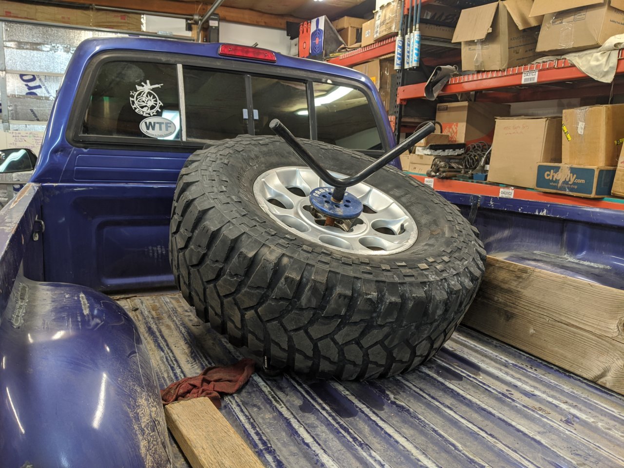

    So I spent all afternoon prepping the housing for the new perches and shock tabs but didn't get them welded on. Between that I put in the driver side motor mount I had to remove to get the front diff in. I also got the spare tire mount in. I left some room in case I decide to go to 37s :D

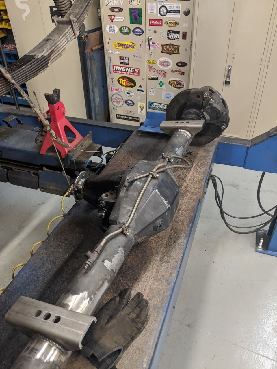

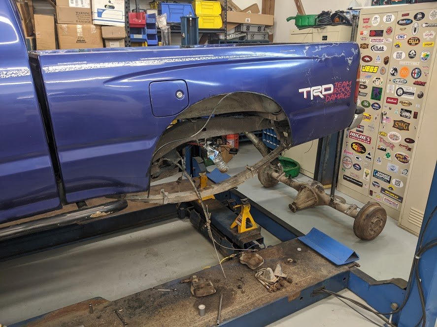

    Yesterday my friend Aaron welded on the new perches from Barnes 4WD while I was at work. When I came by I fit up the axle and things started looking like a truck again. I need to check whether the driveshaft has enough slip to move the axle back 1" to gain a little more wheelbase

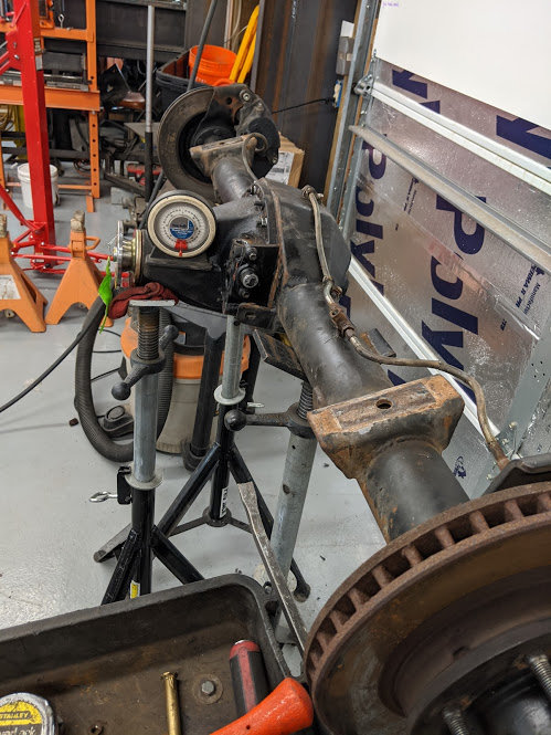

    I pulled the factory parking brake cable and arm off of the frame and replaced the arm with the new one for the t case parking brake.
    I also bolted in the rear axle with these awesome plates that Aaron made IMG_20191120_171211.jpg IMG_20191120_193642.jpg
