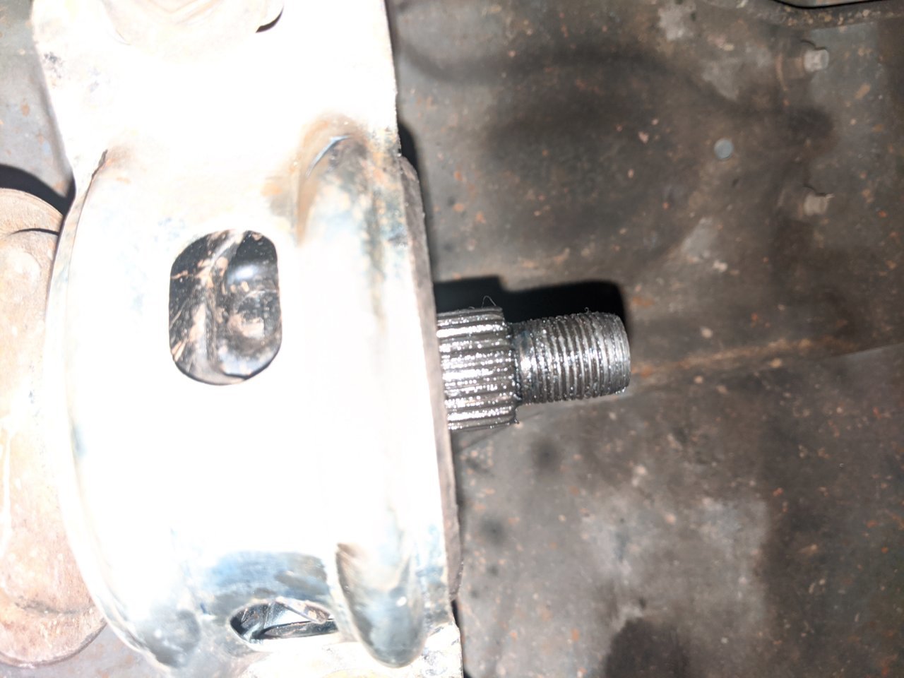

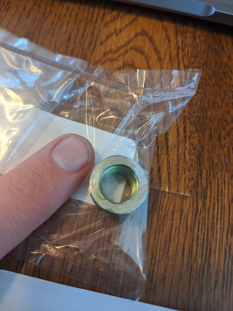

    I ordered a new nut but it's not quite right :rofl:
    I chased the threads of the old one with a tap (and some 15W40 just to piss off every machinist out there :luvya:) and put it back together the "right" way by remembering to follow instructions and torque specs. I also put some blue loctite on for good measure and staked the nut with a chisel so it shouldn't be coming apart again :homer:

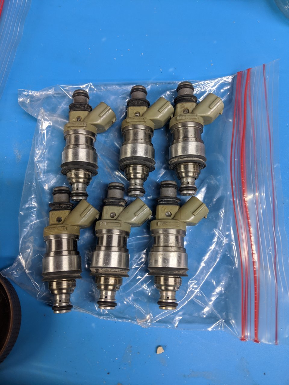

    Dug out the set of injectors that I bought last fall to start preparing them to go in to the truck. Hopefully it fixes my rough idle and intermittent rich CEL that a replacement MAF and new plugs and wires have not been able to clear up.
    I am gonna order o-rings for them even though the existing ones seem fine. I used a 9v to check all of them and sprayed carb cleaner through two of them before the battery died.

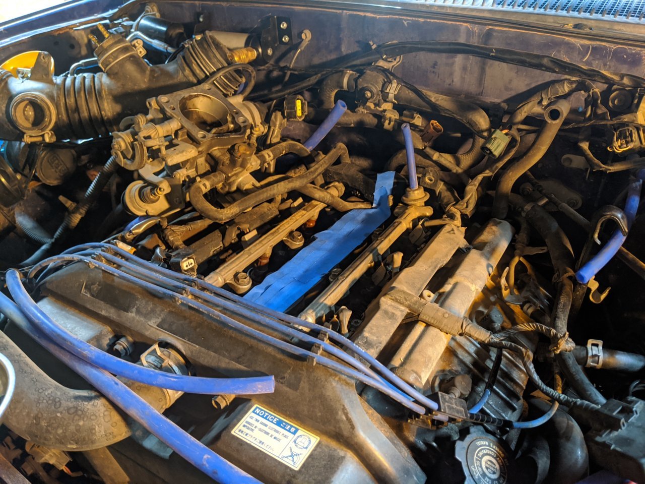

    Finished cleaning the rest of the injectors and got my new intake gaskets and o rings in the mail so I started tearing into things.
    Where the tape is there was no gasket between the upper and lower intake. I'm sure that's been part of my weird idle :homer:

    na, that wont cause idle issues. you actually unlocked the hidden horsepower.
