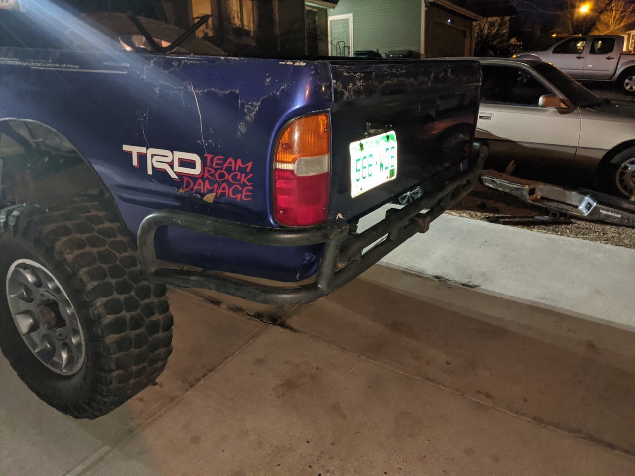

    Ah gotcha. I need to do something like that. The TG bracket that came with my bumper got bend to shit when I dragged it over a rock
  3. Mar 6, 2020 at 3:34 PM
    #523
    Wulf
    Wulf [OP] no brain just damage
    Jan 30, 2015
    #147523
    62,007
    rock raisin
    Oof, yeah, they don't seem to be too long lived
    I'm actually doing this in prep for the used TG rear bumper I just picked up (you can see it in the bed)

    Those bumpers are great. I have the all-pro one with the step platform part on top. Otherwise the same.
    It's seen some abuse. The side protection has come in clutch many times.

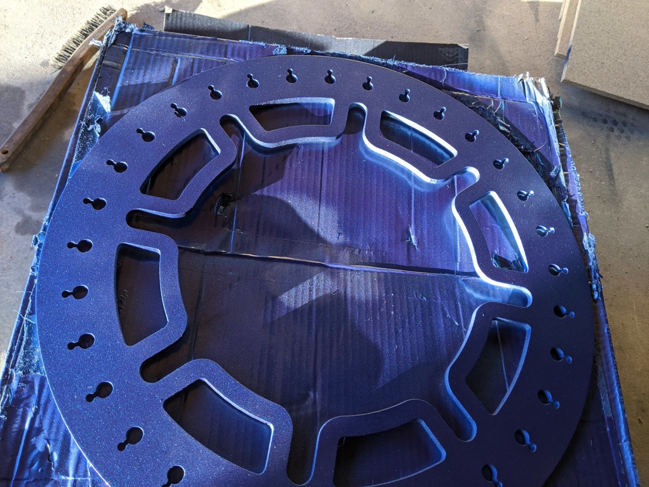

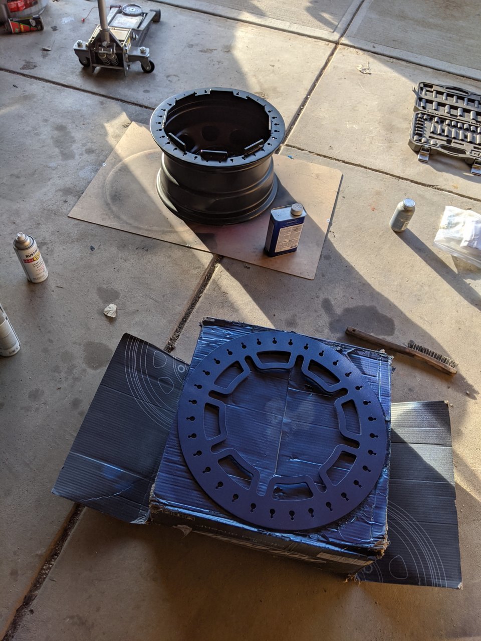

    After lots of measuring I decided to weld it up as is. Looks like it'll be about 10.25" wide. If that's too wide I can still cut it down
    Lots of welding and grinding later the wheel is almost done. Gotta bend those anti coning tabs up.
    I didn't take a pic after I welded the anti coning tabs up.
    I'm excited to get a tire on and see how it fits the truck but that will have to wait til next week

    What are the anti-coning tabs for, Jake? So that the ring stays planar?
    I know basically nothing about beadlocks :anonymous:
  12. Mar 11, 2020 at 6:29 PM
    #532
    Wulf
    Jan 30, 2015
    #147523
    62,007
    rock raisin
    That's correct, it's not a functional issue because the beadlock will work fine but without something to prevent coning the inside of the ring bends inwards

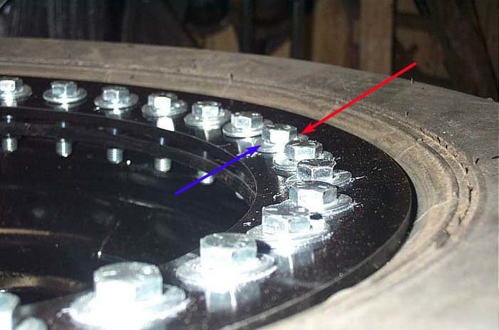

    God damn those things take a lot of hardware.
    gonna have some bling to it when all said and done! Gonna do stainless or zinc coated?
  14. Mar 11, 2020 at 6:35 PM
    #534
    Wulf
    Jan 30, 2015
    #147523
    62,007
    rock raisin
    32 bolts per wheel. Gold colored zinc plated grade 8
