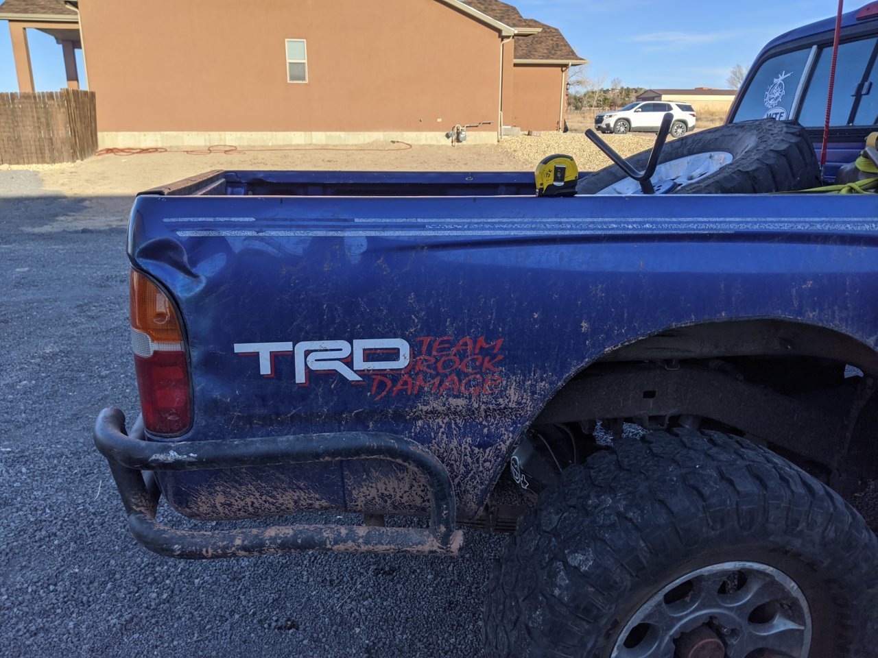

    54" from front edge of bed to center of first mark, 13" center to center between marks
    hmmmmmmmm

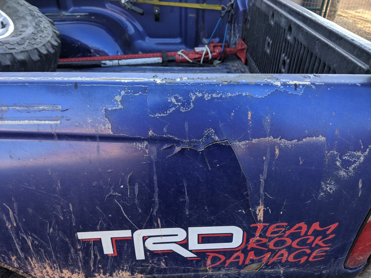

    I've always been hesitant to do it in case I end up missing the space...but I don't really use the bed when I'm wheeling
    Plus, this bed is pretty fucked up between my wheeling scars and the PO. Look at that nasty 1/8" bondo covering the drivers quarter
    """"never been in an accident""""
    """"clean car fax""""
    :duh: :duh:
    As my friend would tell me, it's just metal. I can always extend the frame and throw a clean bed on if I hate it....

    I can never bring myself to do this because I always feel like I am running out of bed space. I love the look and idea, but just can't ever consider it.

    I would bob it before you mangle it up even worse, that would suck to weld.
    I'm also in the pro full length bed camp, and the full length bed never really hung me up. Although I have been thinking flatbed recently.

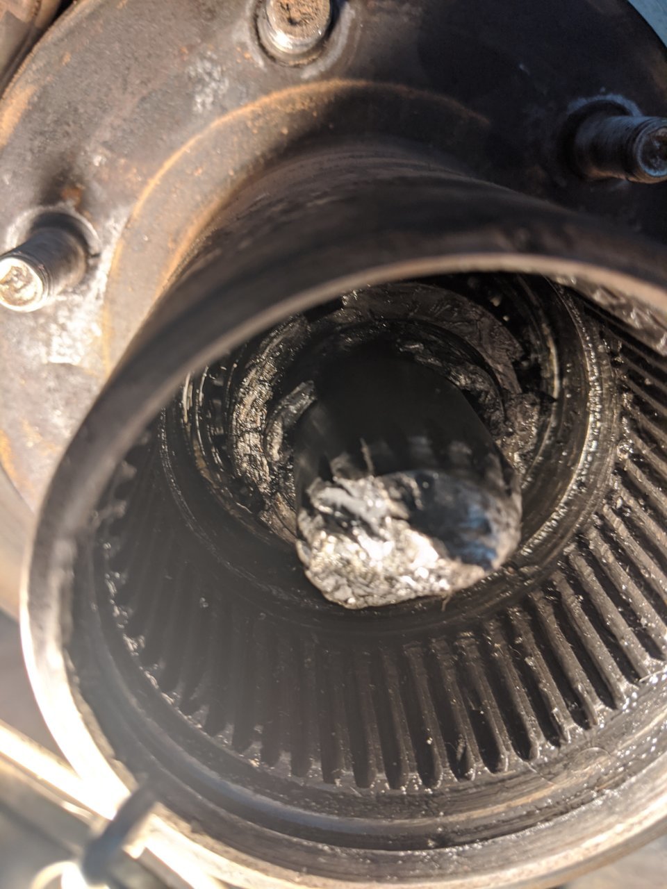

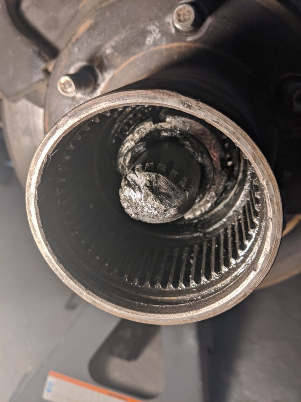

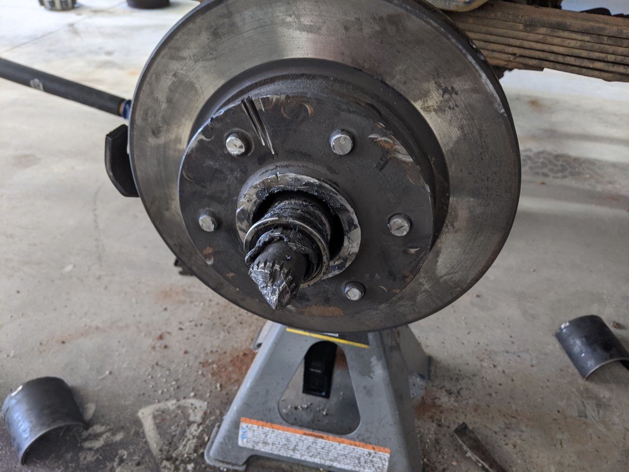

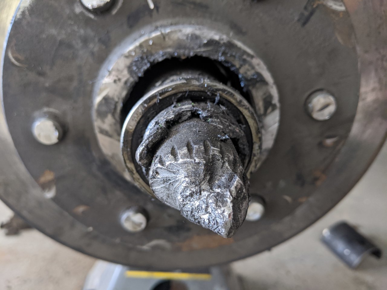

    Started tearing into the truck. Shit is so fucked.
    I had to use a pry bar and chisel to clean up the end of the spindle enough to get the spindle nut off with the right socket and an impact.
    After that I spent 45 minutes heating the end of the spindle/wheel bearing with a torch and beating the rotor with a BFH to coax it off. I made it about 1/8" closer to the end but it's still 3/16" or so from being free.
    I'll keep working at it tomorrow but at this point I'm thinking a liquid wrench would be nice.

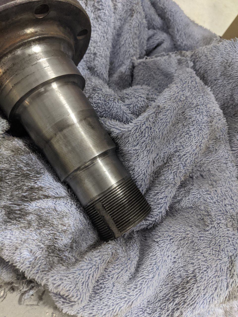

    For reference here's my new junkyard spindle, about 3/4 of the threaded portion was grenaded with the axle shaft :(
    CGoss and Running Board Man like this.

    Since everything from the backing plate out is getting replaced I started cutting.
    I cut around the base of the splined hub, made two opposite cuts parallel with the axle shaft, and split the splined hub off with a chisel. The outer wheel bearing cage and rollers came off with a few taps of the chisel and BFH.
    Obviously this is a shitty option for any case where you want to reuse parts but the spindle is fucked up and I wasn't making any more progress trying to beat the rotor to get it to come off.
