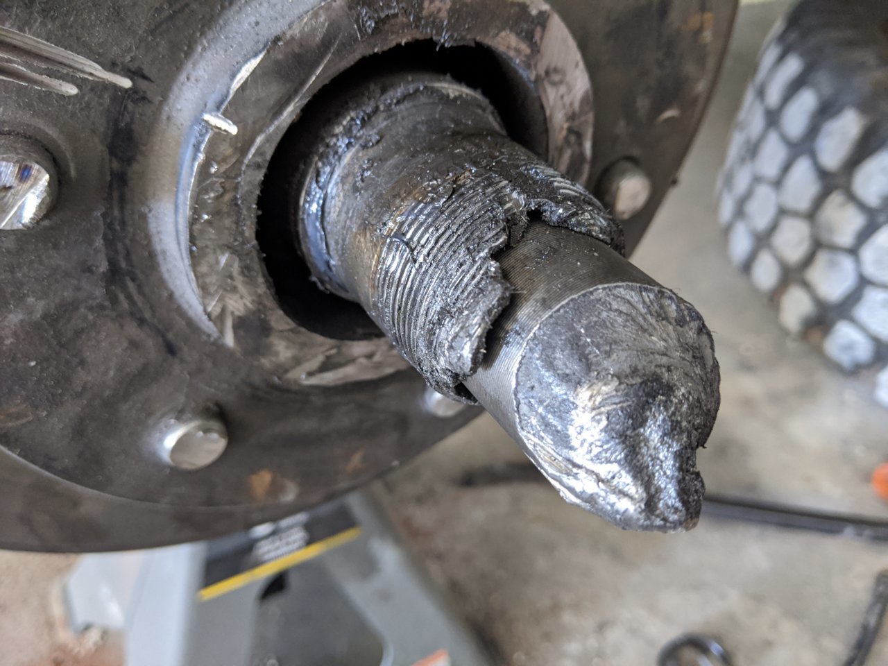

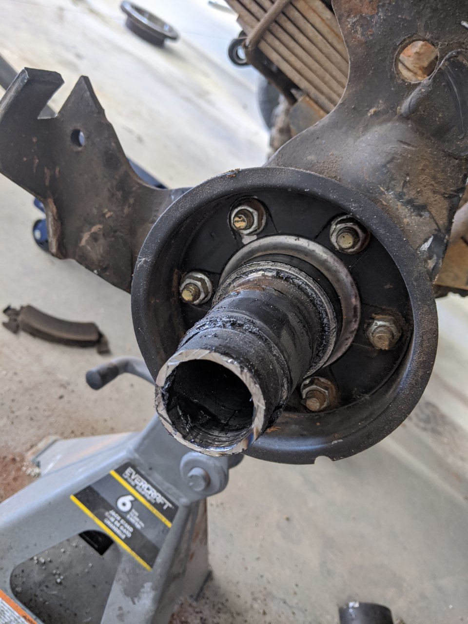

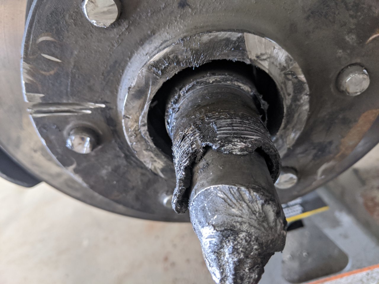

    The end of the spindle was so fucked up that it wouldn't let the shaft slide out -- the 19 spline outer is a couple mm smaller than the inner shaft. The spindle was ovaled a bit and keeping the larger dia porting of the shaft from coming through
    Anyways, time to keep cutting. I cut the threaded end off and the shaft slid right out
