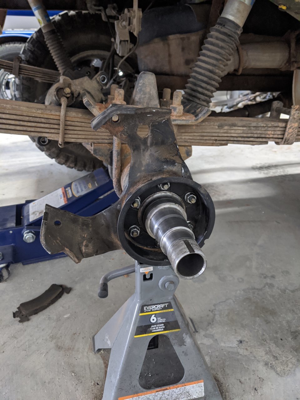

    My new to me junkyard spindle still had the inner bearing that the front axle shaft would ride on to keep it from rubbing the spindle.
    No problem, it's a little thing and I usually don't have much issue breaking them. Yesterday I spent about an hour trying to break it out with a chisel and couldn't get the cage out. I dropped it at a shop and they told me that they broke a puller trying to remove it so I felt vindicated at the least in my frustration with it. The half hour of labor they charged was worth it for my sanity

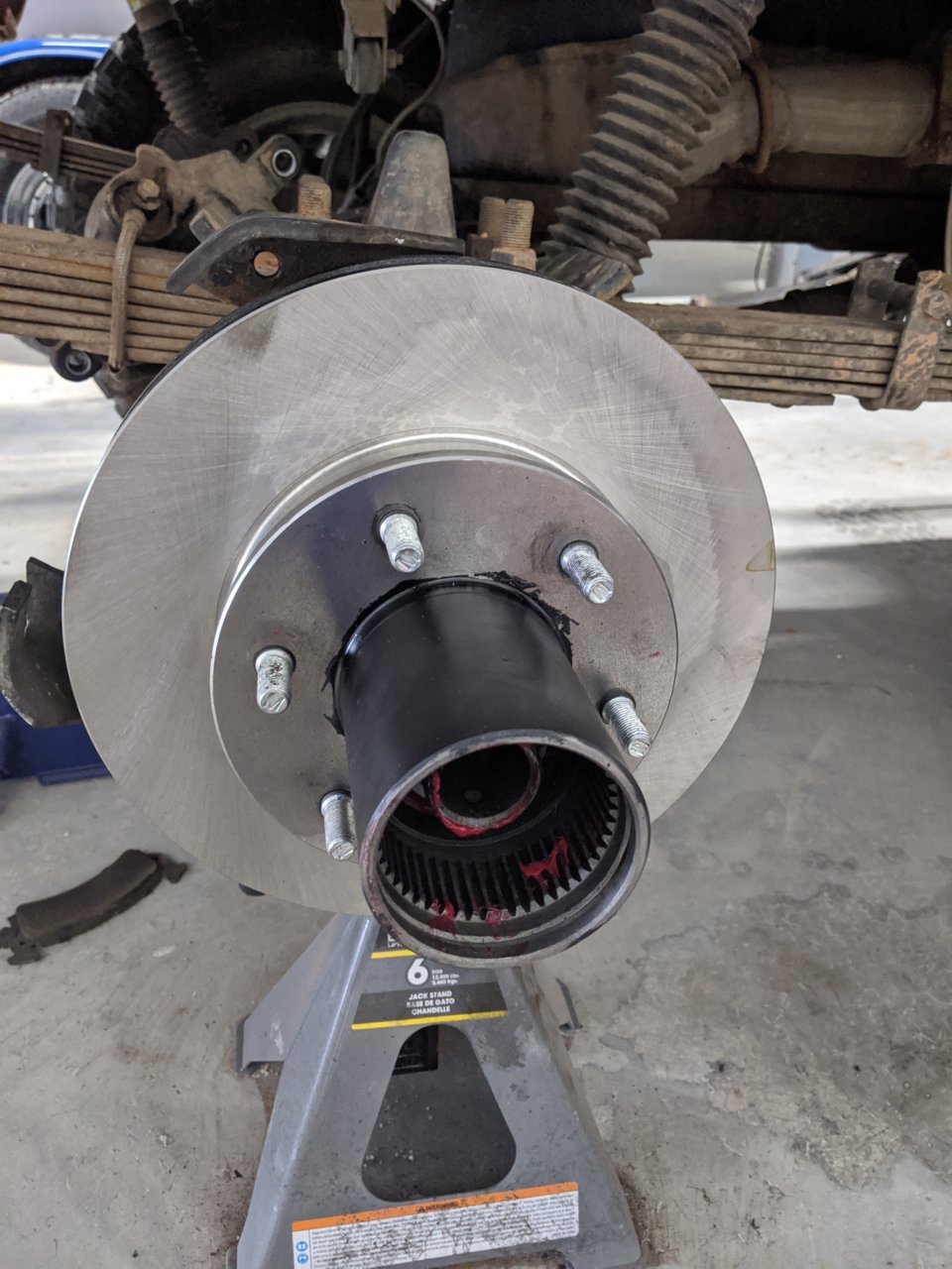

    Didn't have a ton of time this evening but I got the new studs in to the hub, packed the inner wheel bearing, installed said bearing, and installed the wheel seal.
    I also cleaned up the spindle and put a new coat of RTV on the back and installed it with 3 bolts while it cures

    Poking along. Forgive my lazy hub spray paint job. Last thing I need for the rear is the spindle nut set which is in the mail. I would reuse my old one if it hadn't turned itself into a jigsaw puzzle

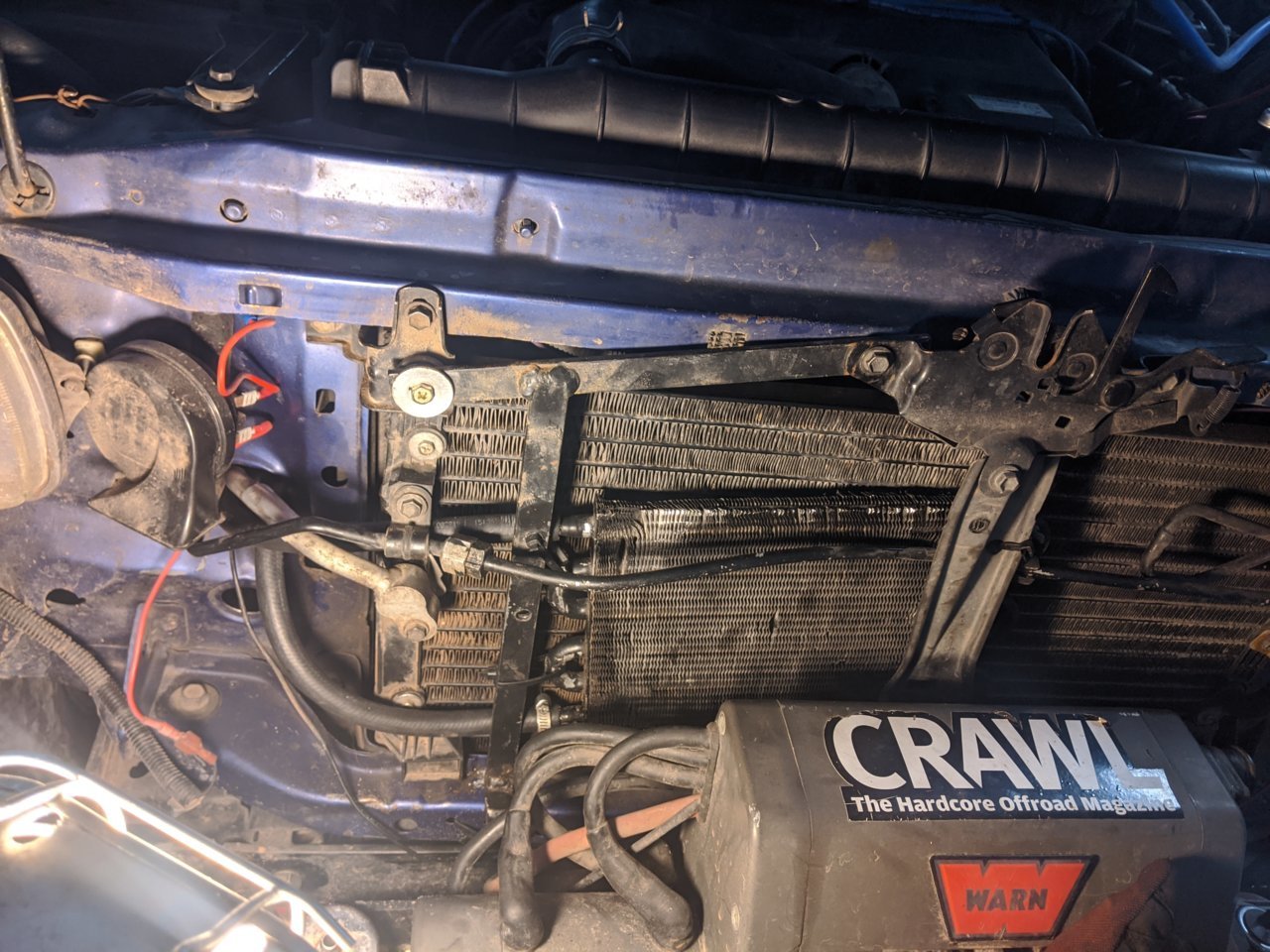

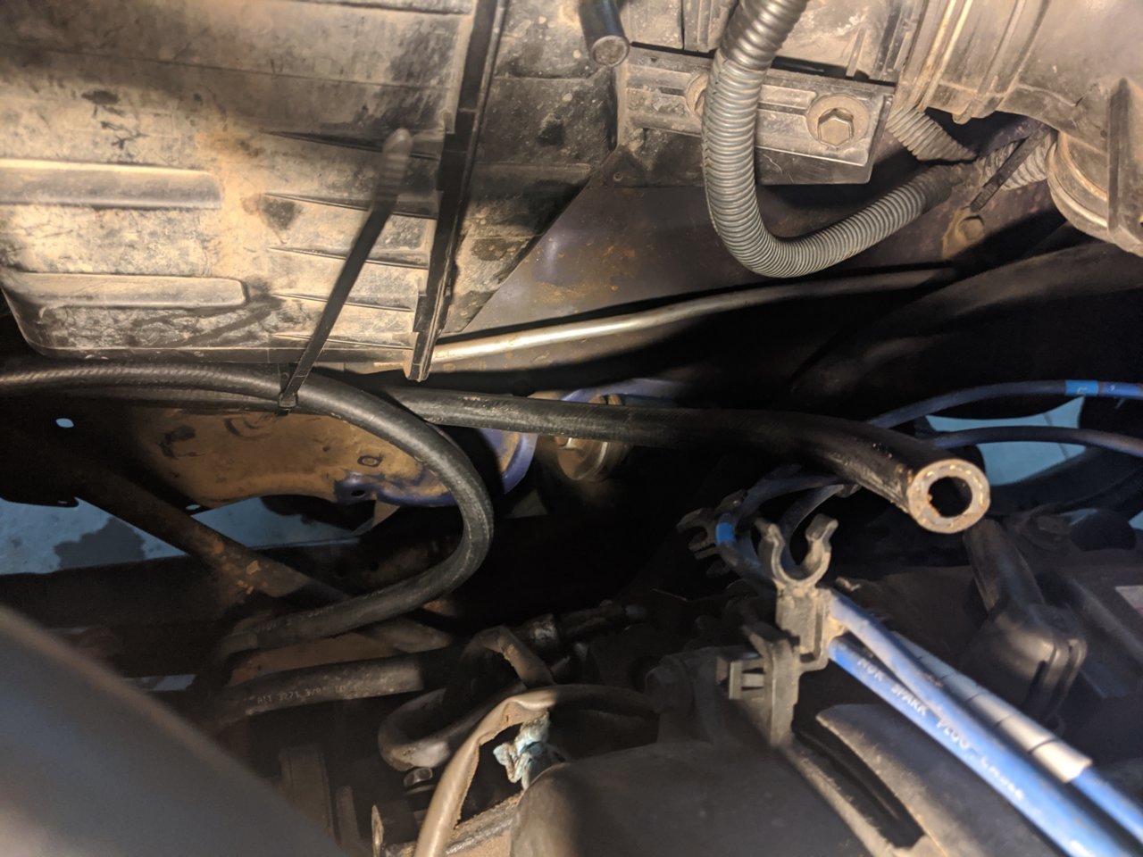

    Got the steering cooler remounted a little lower. Ran new lines and made sure that they have better radii than last time. I took a better look at the fluid that came out and it is dark and smells burnt but still has quite a bit of red to it --- I guess the pump failed due to non-heat related reasons :notsure:
