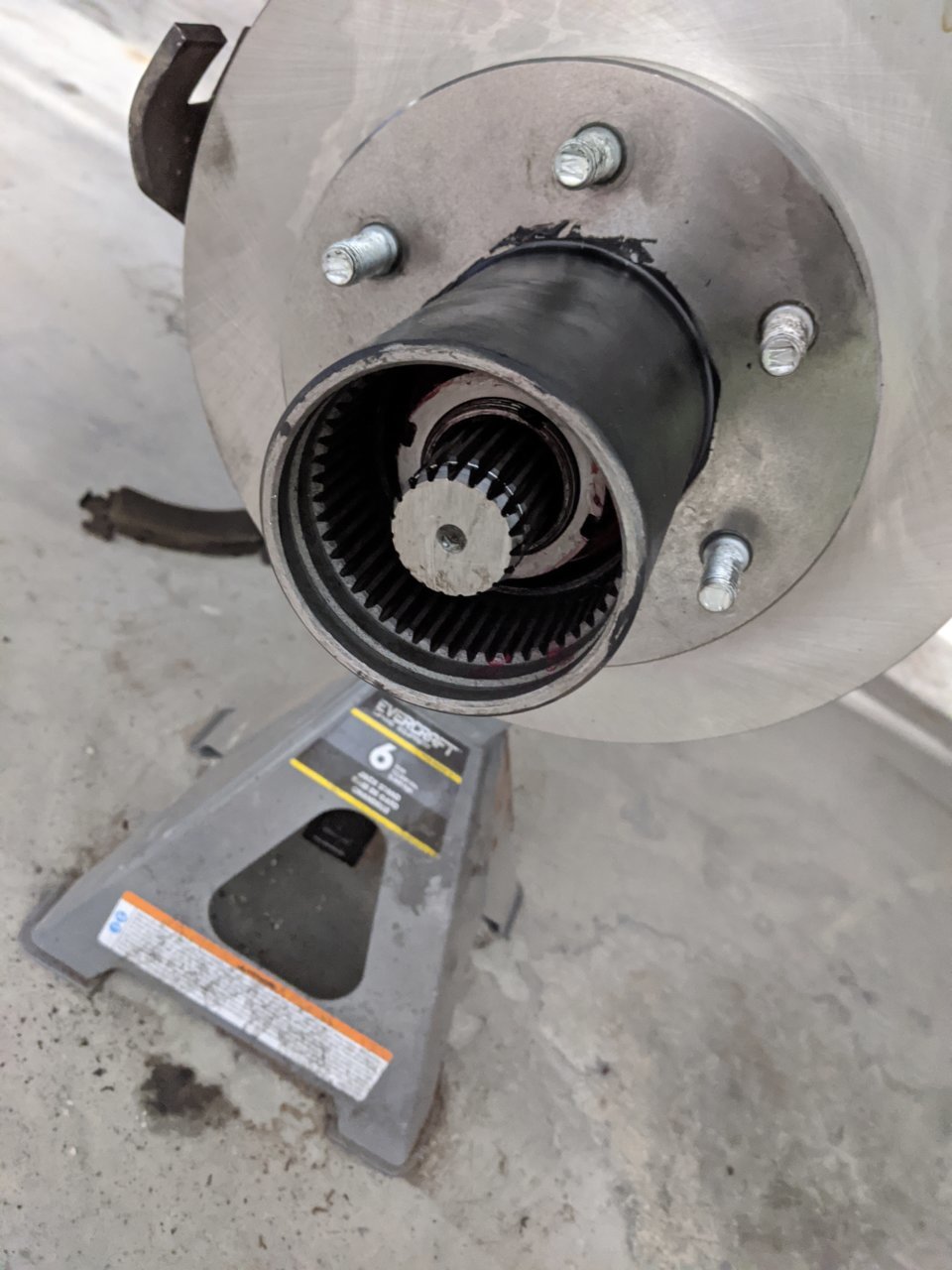

    Finally got 2 more spindle nut kits in the mail.
    The other drive slug was chewed up by the broken shaft. Even though it was superficial damage I switched to the spare I've been carrying.
    All together with fresh brake pads
    Littles, Deathbysnusnu, CGoss and 2 others like this.

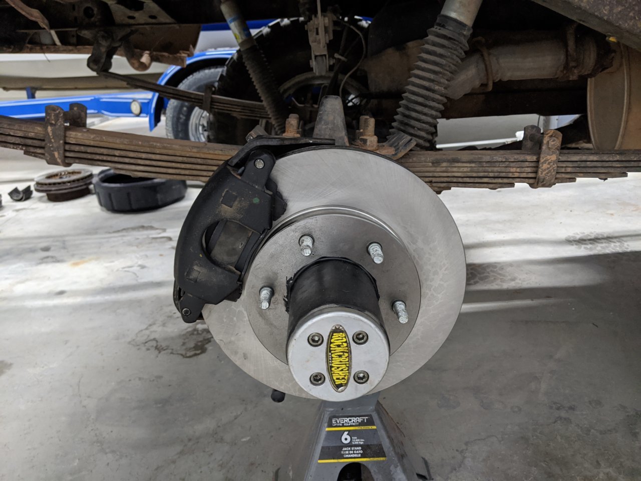

  5. Apr 23, 2020 at 9:35 PM
    #625
    Wulf
    Wulf [OP] no brain just damage
    Jan 30, 2015
    #147523
    61,935
    rock raisin
    New brake pads on the other side to match and it's back on its own weight

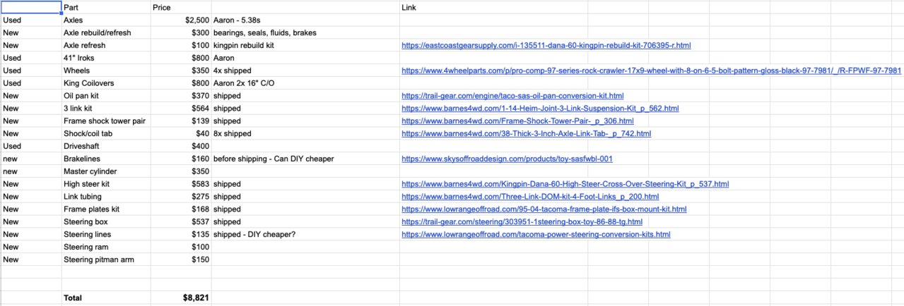

    I have been hung up on a lot different thoughts lately.
    I've been pretty pissed and discouraged after I blew up that RCV, elocker motor, and another power steering pump but that hasn't been the only thing. Before that it was the rear driveshaft coming apart, rear axles seals, wheel bearings, front CV, another PS pump, front CV seals, exhaust... :bananadead:
    It's not so much the money, it's just the frustrating feeling of investing so much time in a circle.
    Do I keep fixing it and doing """"the last repair for a while"""" and wheel it again to break something else again?
    Do I drop $1100 on those rear RCVs? Then worry about breaking my R&P and front CVs again?
    Do I drop $9k on the SAS parts and "be done" for a while?
    Do I sell the truck and buy a Jeep or Tacoma already on tons for the $9k I'd spend on this one?
    Go back down to 31s and 33s to slow the rate of breaking shit?
    Do I take a break from wheeling for a while?
    Do I go get the Jeep out of storage and chase my tail again with all of these issues on a vehicle that's been sitting 8 years?
    After a lot of nudging I'm gonna take it wheeling again but that doubt is always gonna be in the back of my mind

    So is that splined setup better or worse than the more common oe setup where the axle bolts to the hub
  14. Apr 24, 2020 at 8:53 PM
    #634
    Wulf
    Jan 30, 2015
    #147523
    61,935
    rock raisin
    The full float set makes it easy to do wheel bearings. No press or special tool needed. Also, if I break a shaft, the wheel bearings are still supported since they're independent of the axle shaft.
    It's also supposed to be stronger than stock.
