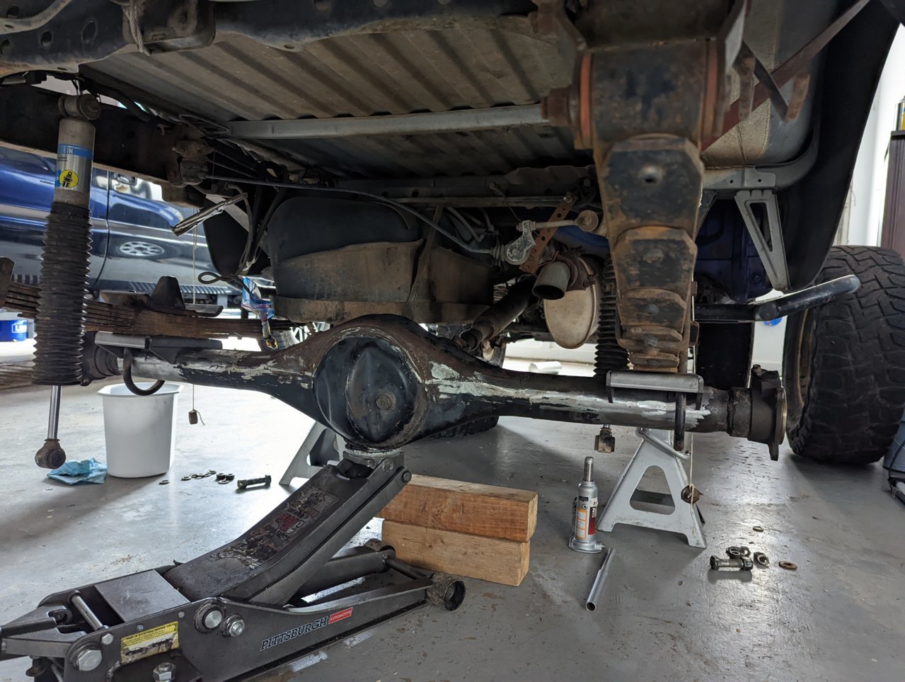

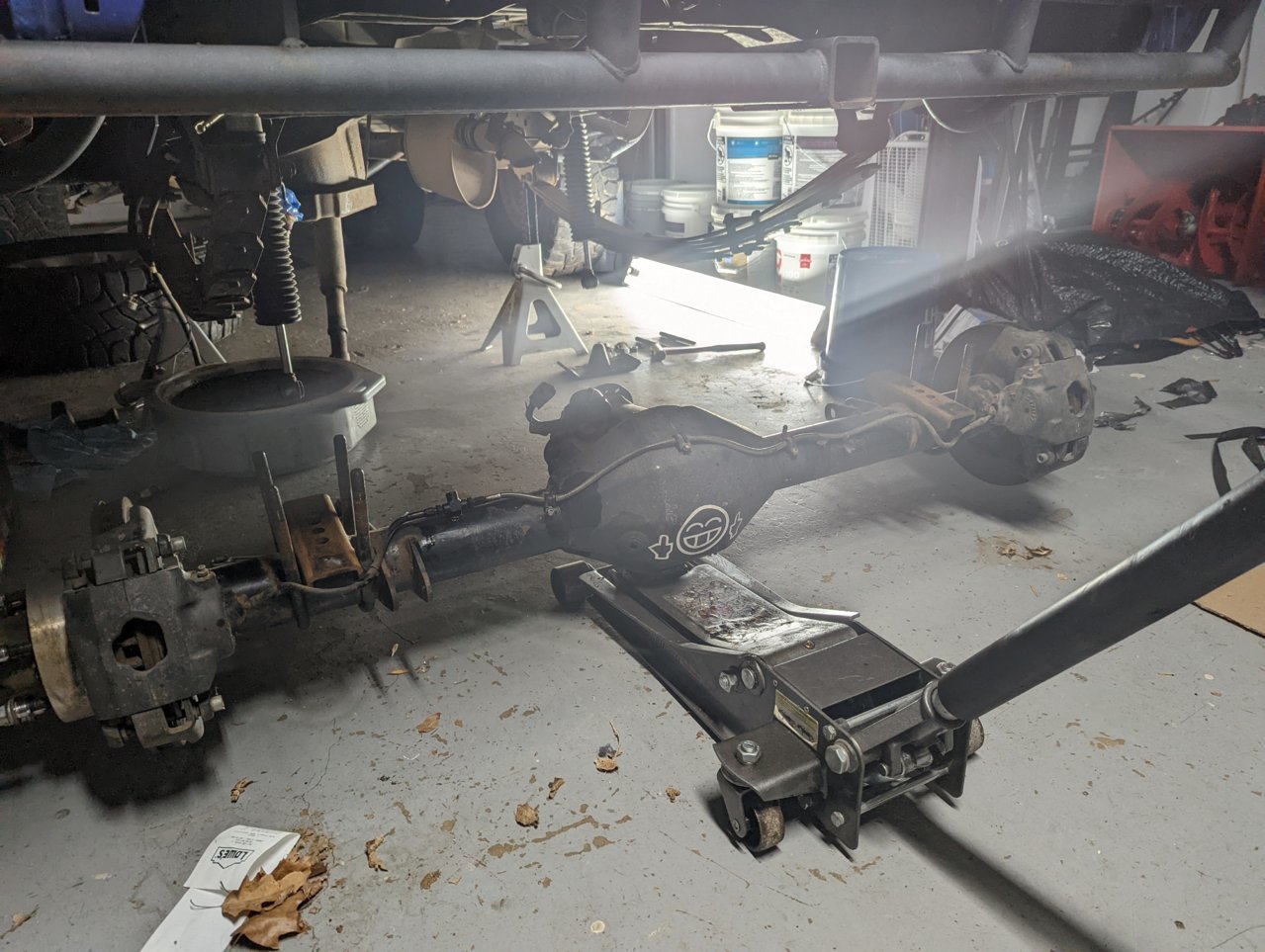

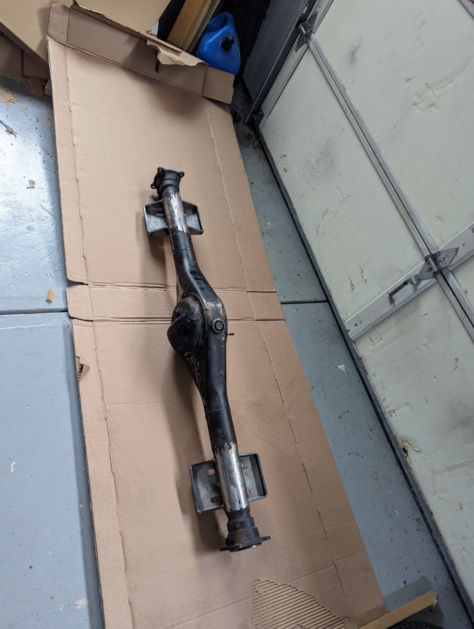

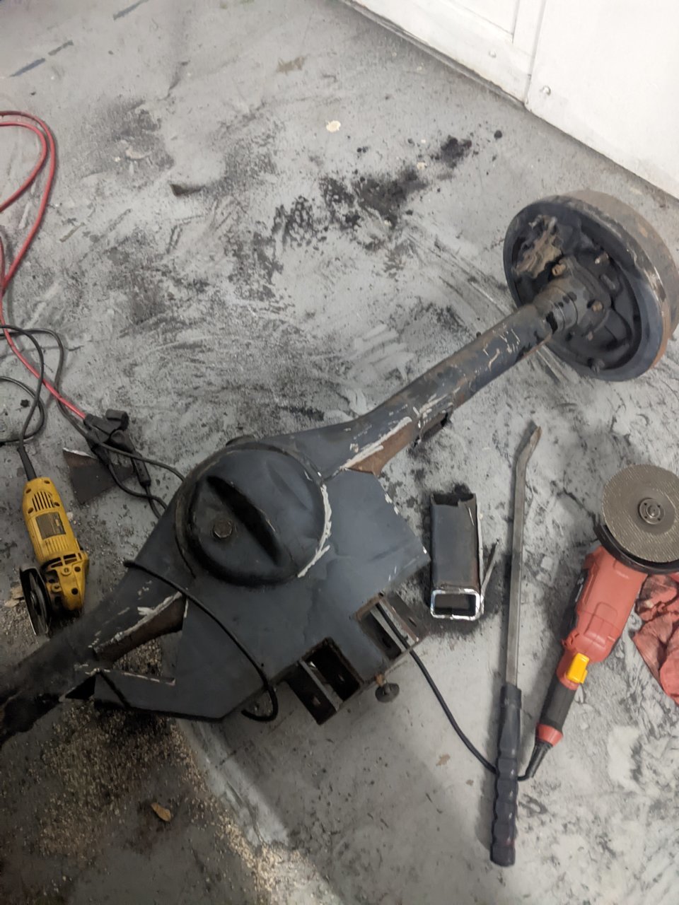

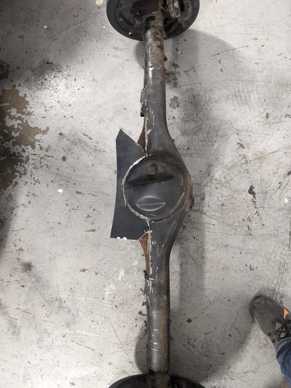

    Between the move and hurting my back again I haven't given the Tacoma any love since last summer. I did do a bunch of steering work on the crawler though...
    My buddy was cleaning out his shop and offered me this elocker housing with a jungle gym attached. Ive been poking at it here and there and getting it cleaned up. I have some perches to weld on so I can slap my third in and put it under the Tacoma to get rid of the disaster Diamond. I went back and forth on leaving the truss but said fuck it.

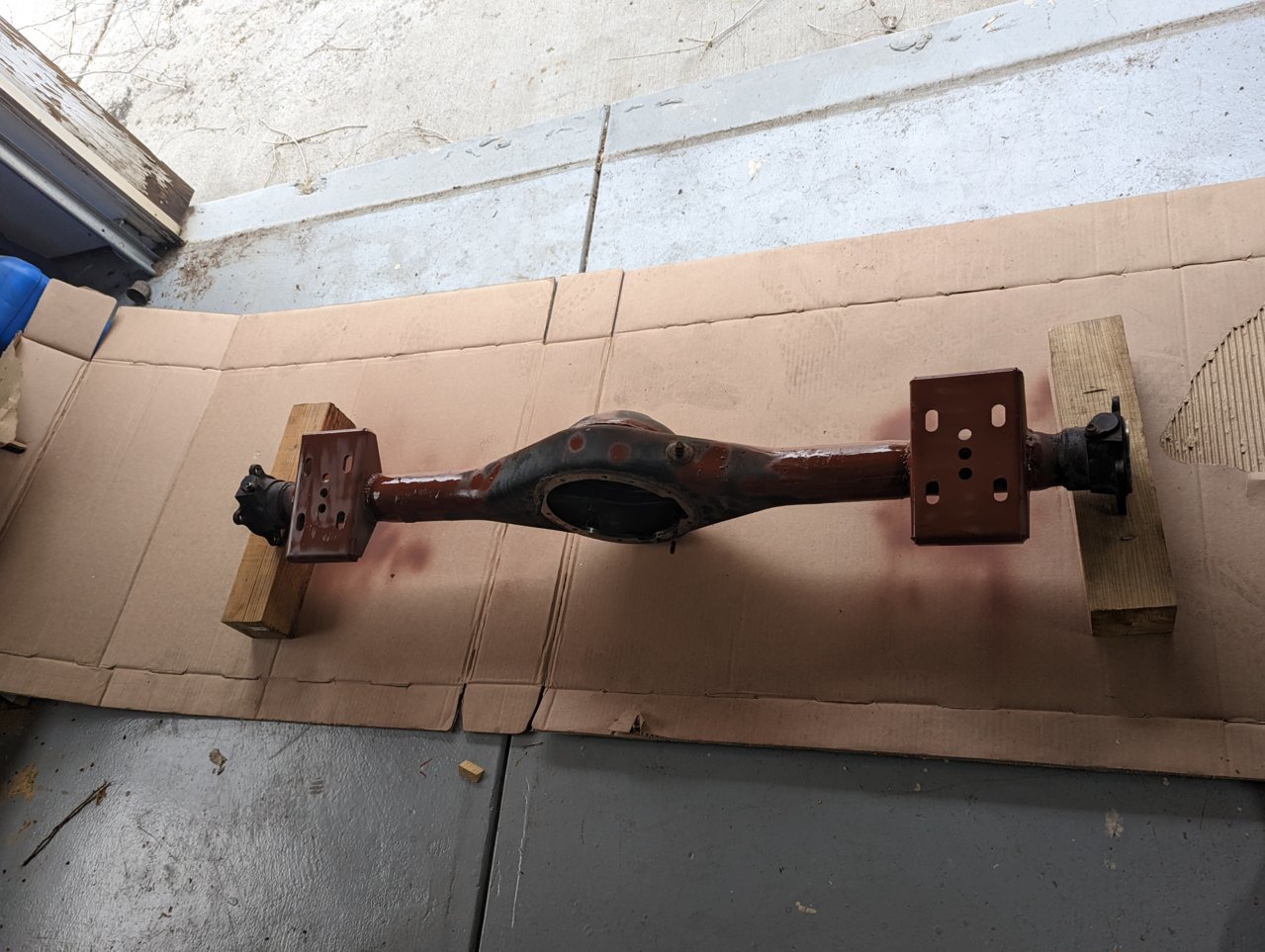

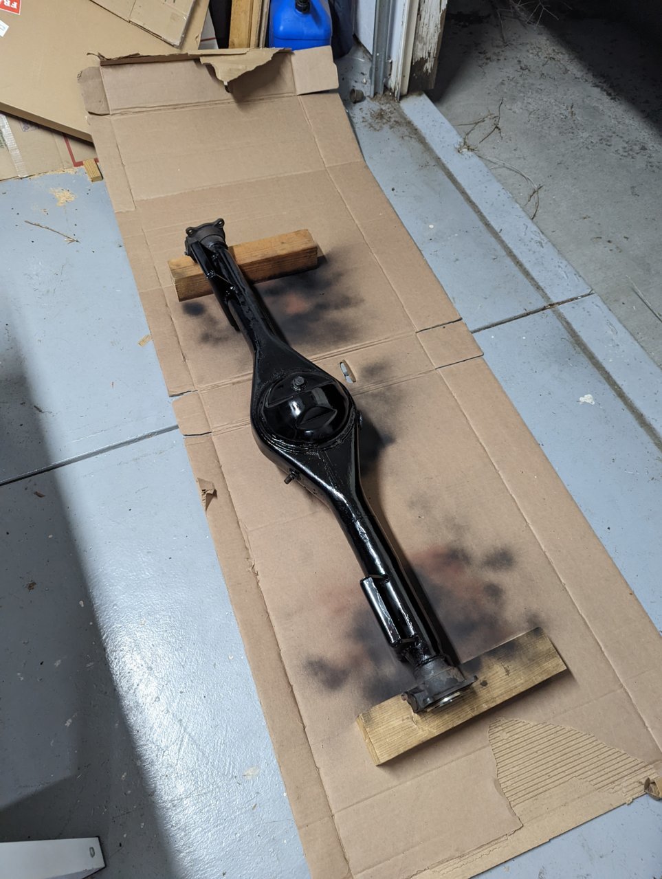

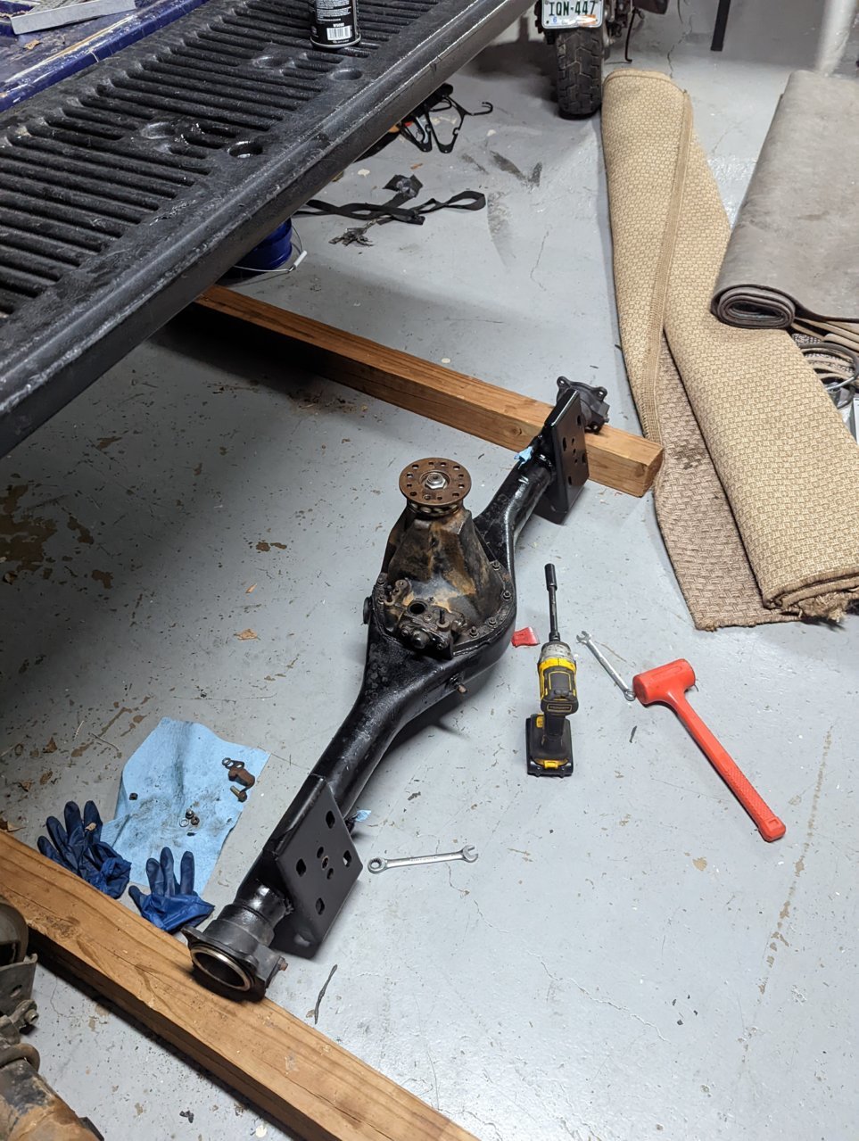

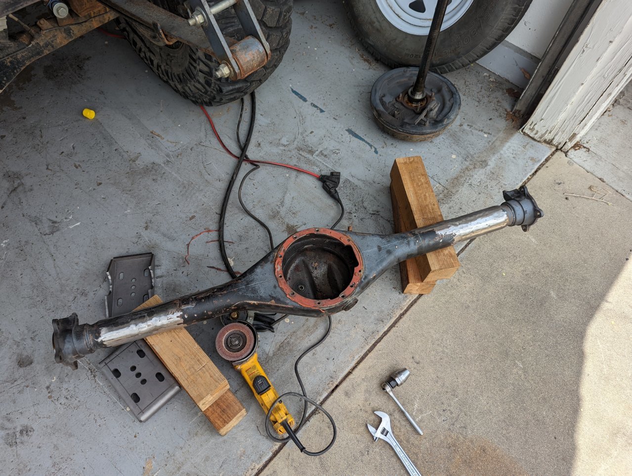

    An eternity of grinding later I decided the housing was clean enough.
    Goodbye garbage
    Mocked up the perches, set the pinion angle, and tacked the perches in place.
    Pulled out, welded, and rattlecan rebuild complete
    PXL_20220501_232607260.jpg PXL_20220502_003926347.jpg PXL_20220502_025002012.jpg
    I'm gonna have to relocate my upper shock mounts but I'll worry about that later.

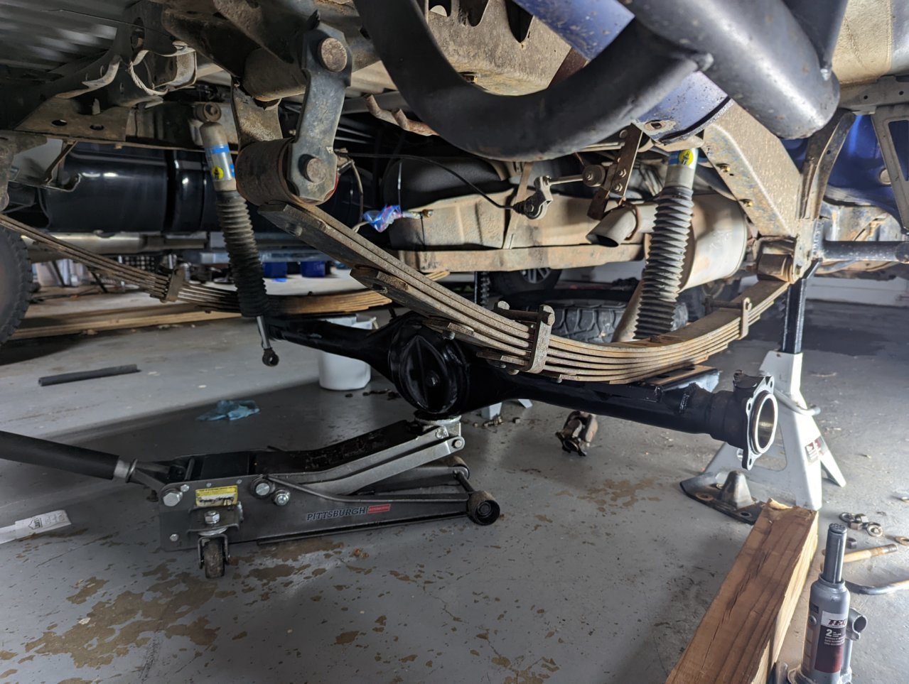

    cut the lower shock mounts off the OEM spring plates and welded them up before putting the third in and getting the axle ready to bolt in

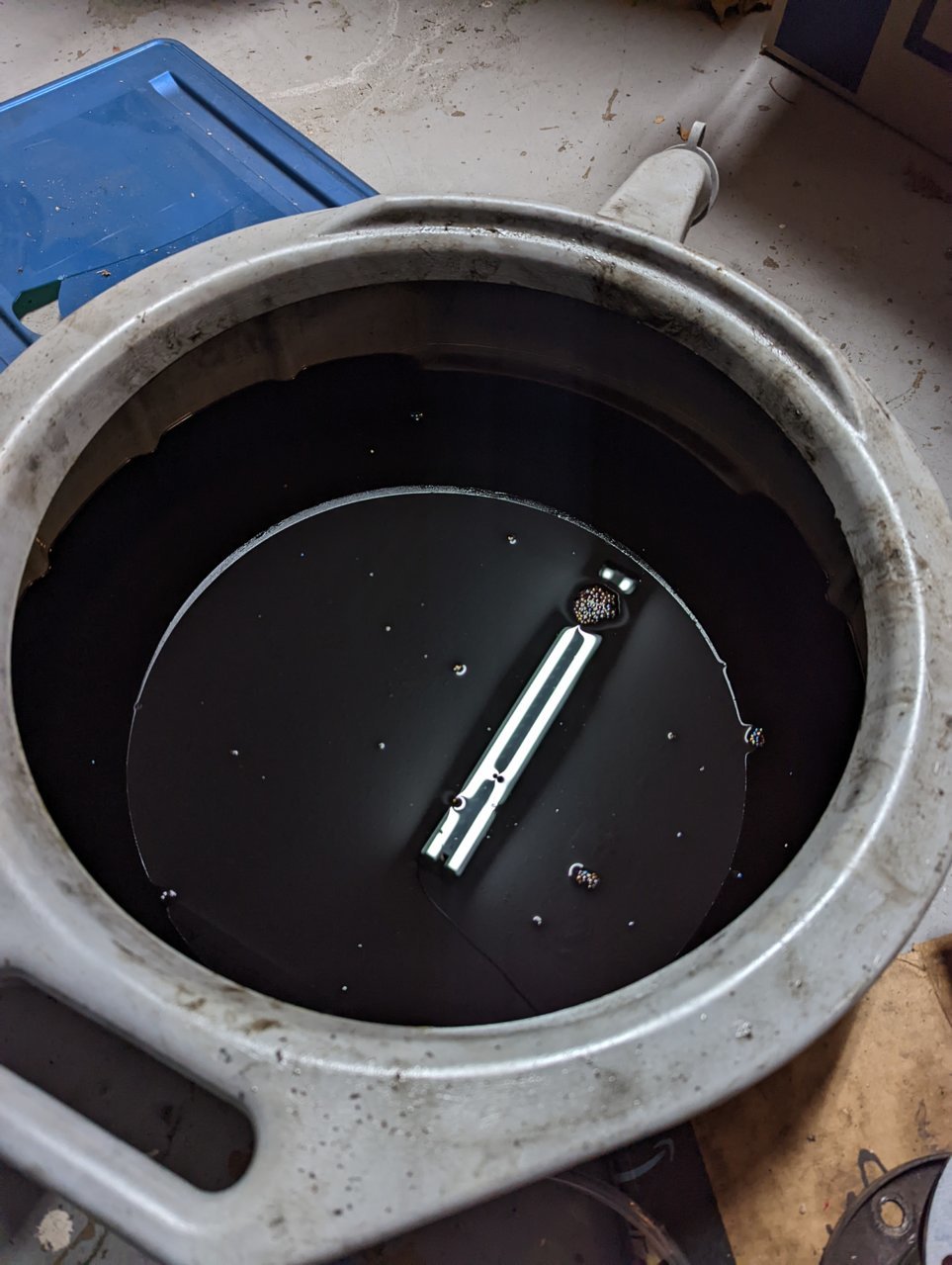

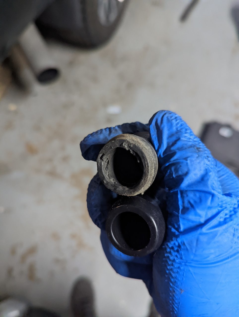

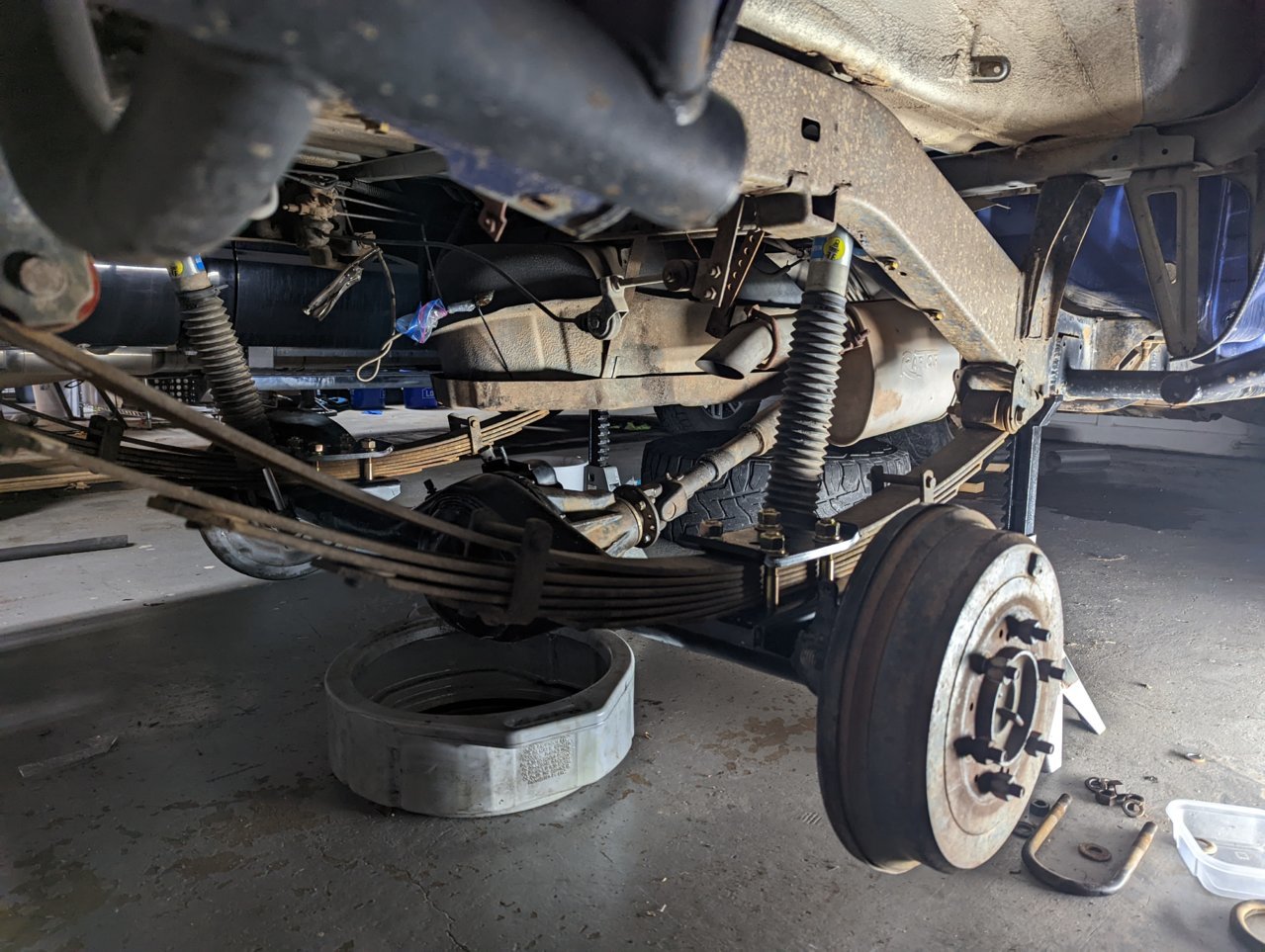

    The other night I bolted the axle in, torqued the third hardware, filled it with the 85W140 ECGS prescribes.
    Tonight I poked at some smaller stuff. I changed the lower shock bushings which were more beat than the picture shows from running a threaded 3/4" bolt for the shock mount on the old axle.
    Also did the 3,000 mi oil change. I should lower the interval or switch to hours to account for trail time lol
    Still got some grinding and welding to do. Also waiting on line and fittings so I can make new hard lines for the brakes.
    PXL_20220508_040925112.jpg PXL_20220510_012922481.jpg PXL_20220510_022714350.jpg
