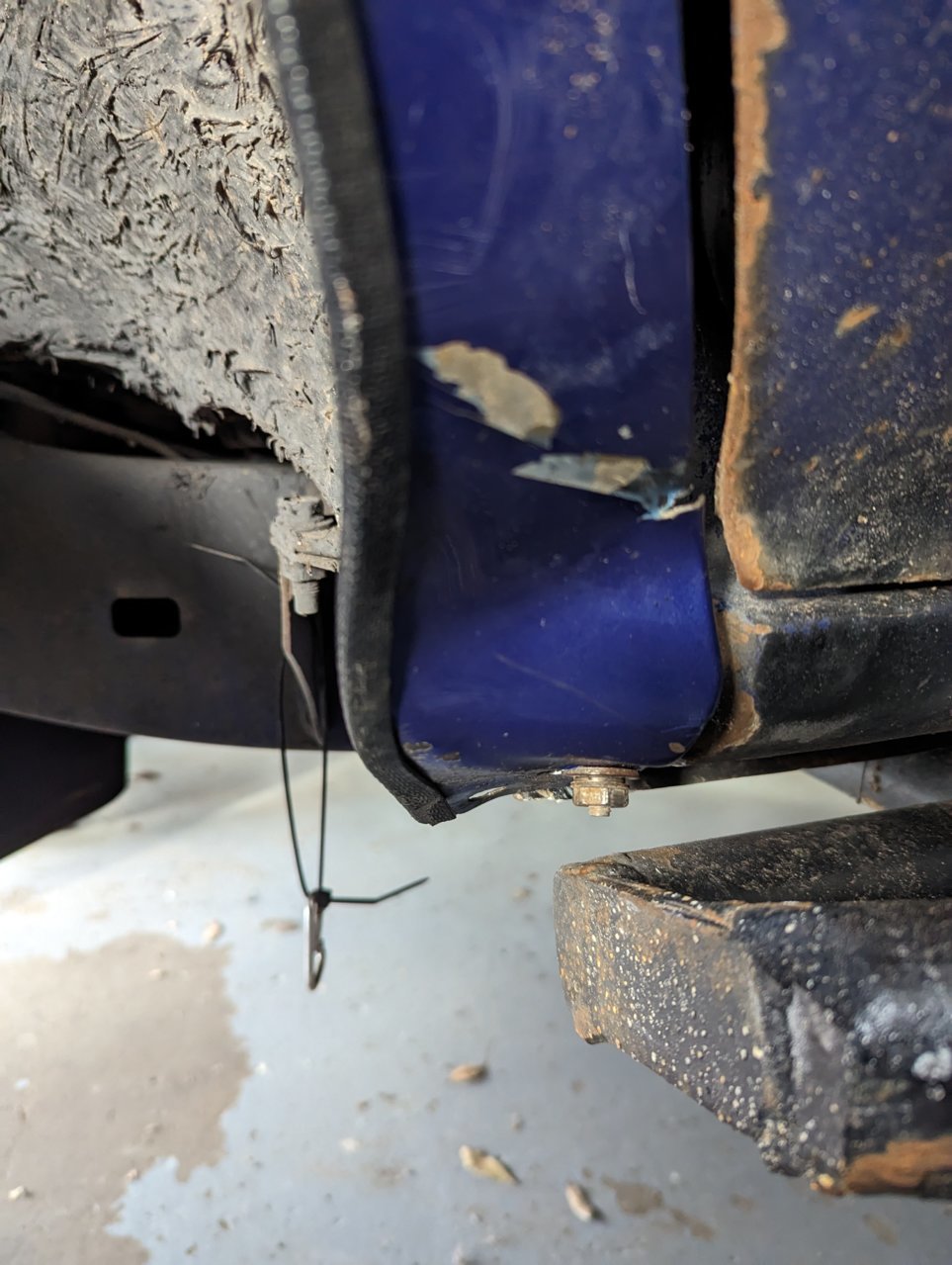

    Taking inventory of what needs to be done to make the truck less of a rattle trap. It turns heads for all the wrong reasons
    • I need to trim the front fenders near the bottom of the door and weld on a tab to attach them to the cab

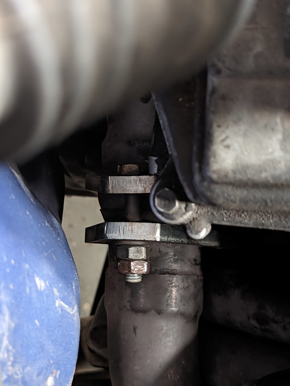

    • The hardware fell out of my ebay headers crossover pipe for the 3rd? time. This time I'll probably weld the hardware together so it can't rattle loose. The one bolt that couldn't fall out entirely sounds like a loose bolt in a hamster wheel

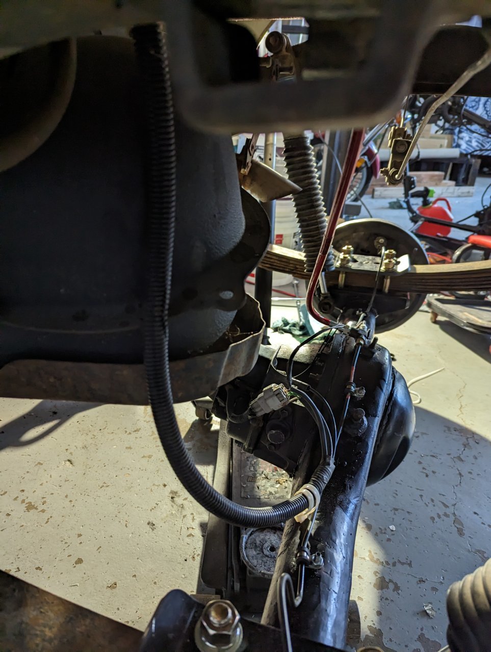

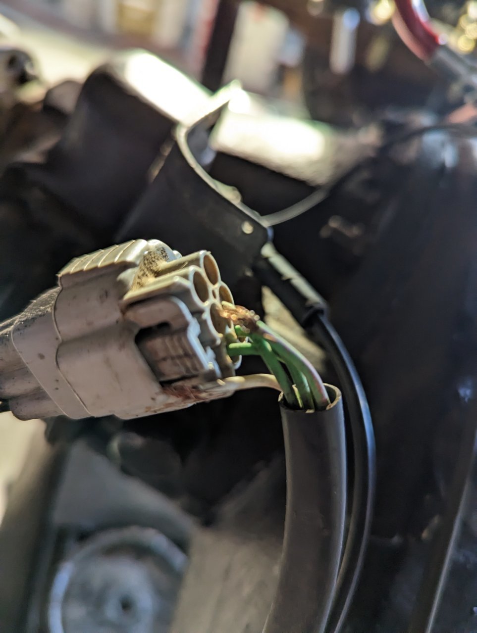

    The low range elocker harness is not well crimped and pulled wires out of the connector despite having plenty of slack at full droop

    Nice progress, but that harness is a bummer! You definitely expect more from a bought not built part, and it’s so annoying with crimped contacts like that.
    Nice to see the Taco getting back in action, tho!

    Yeah, I didn't want to bother with making a factory elocker harness work or making my own. It seemed like a pretty decent off the shelf option. Turns out half the shit you buy needs to be rebuilt anyways :homer:
    If I was confident that I wasn't going to explode the thin elocker side gear I'd just leave it locked full time.

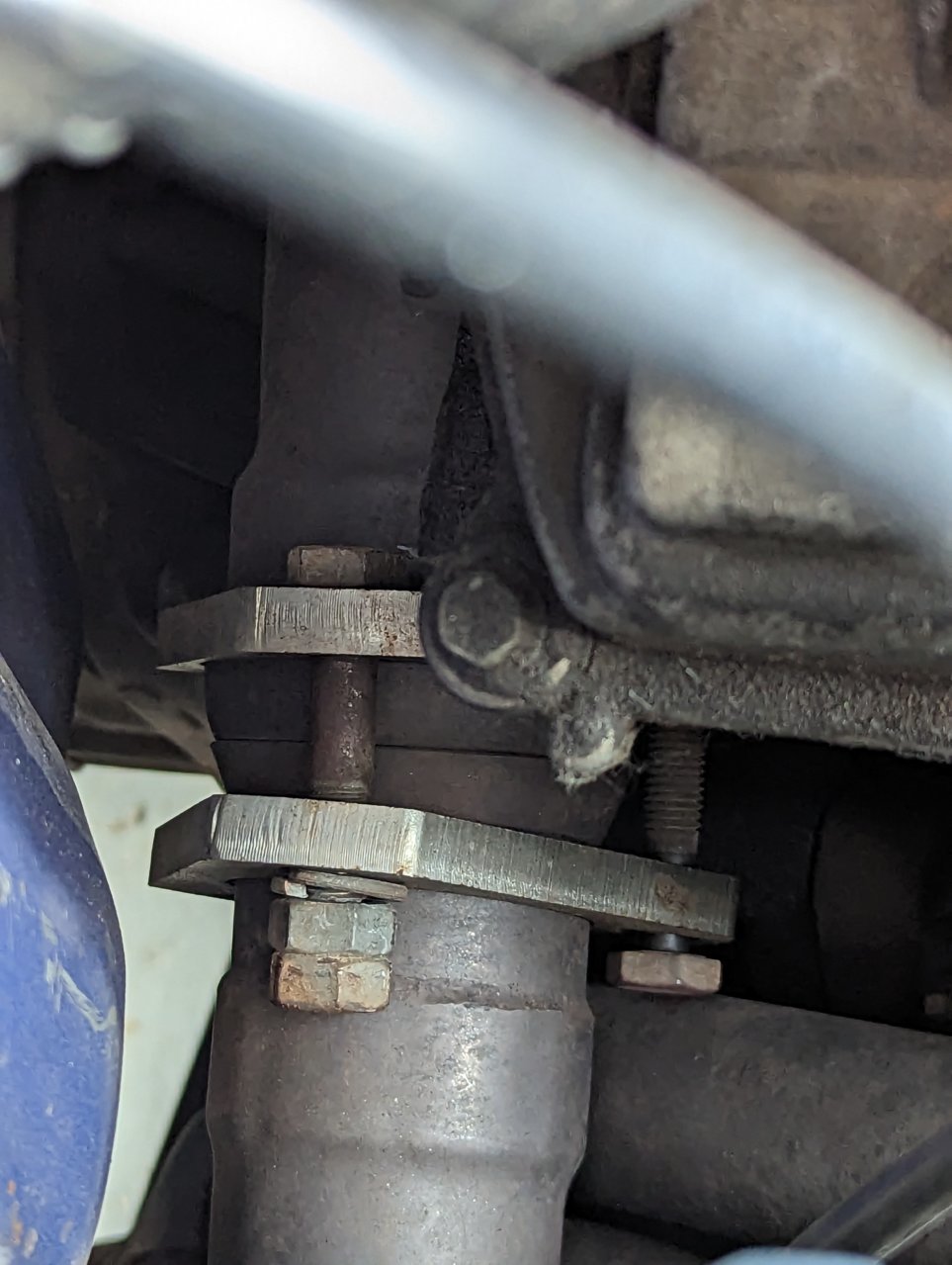

    Pulled the captured bolt out of the crossover pipe after some creative wiggling. The flange is welded on the crossover in an angle that requires the bottom right bolt to be tightened before installing. There's not really enough room between the head and the bottom right hardware to get it tight tight. This is the 3rd, 4th? Time it's come loose and fallen out.
    No more, 1/3 is enough, right?
    Probably still leaks like a mofo but it won't sound like a fork in the garage disposal while driving around anymore.
    Never buy ebay headers never buy ebay headers never buy ebay headers

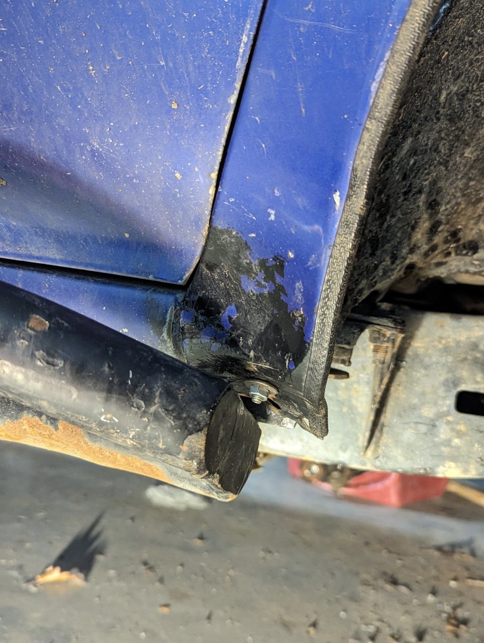

    I dug through my spare hardware and grabbed something to weld to the cab so the fender isn't zip tied to the cab mount at the bottom so it was attached somehow. Never got around to it before but the rattling is pissing me off now.
    Yeah it looks crooked but I promise it's square to the body :laughing:
    I need to do the pass side still

    Hacked out more of the same for the pass side

    Exhaust manifold bolt & spring kit?

    Maybe. I was checking out locking exhaust hardware kits the other day. the bottom right in the above picture is in a position between the crossover and the back of the head that makes it difficult to get it tight enough :/ i have a stubby HF service wrench ground down to fit in there that I've been using because this is a recurring problem. it's not cutting it for me haha
    I took the truck to an exhaust shop at one point and they suggested cutting the flange and rotating. it's not worth it, if I pull these out to rework them something else has to go in

    Drop bracket lift and booger welds
    I sent a self tapper into both sides and ran that for years now. A welded stud is prob a much cleaner option though. Always worried about how much corrosion is eating up that little hole

    I thought about it when I was dragging the welder around. I'll let you know if it was worth the extra effort next time my fender gets mangled at the mall :p
