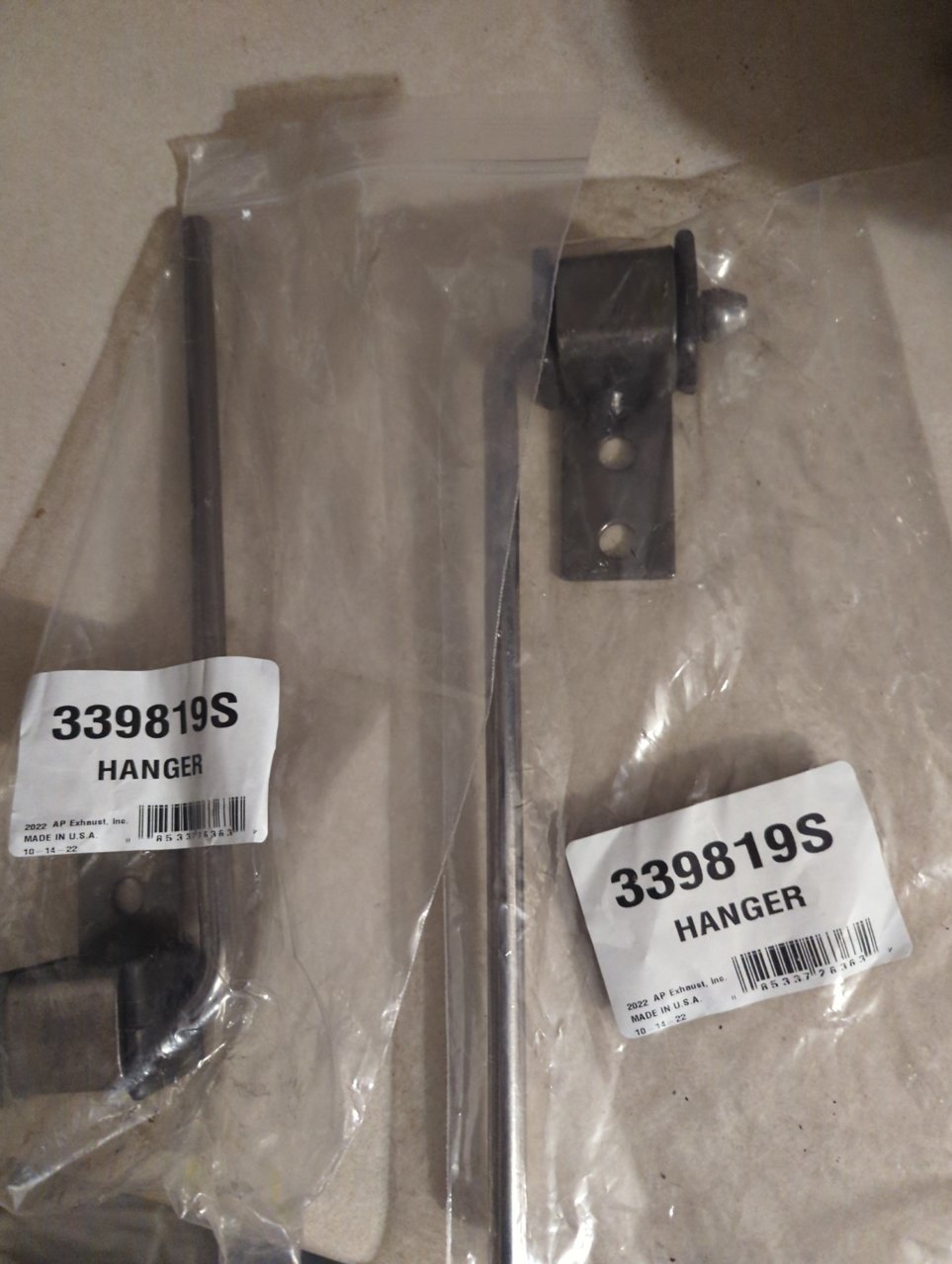

    Welp, the exhaust hardware is loose again. It uses 10mm fasteners but I couldn't find a M10x3" long hardware kit from Stage 8 catalog. I'll check again before I order but that 3/8 set is my best shot. Also poked at it and it looks like with some swivels and luck the annoying placement can be tightened from the driver side across the back of the engine.

  10. Jan 17, 2023 at 4:49 PM

    Never saw that type of fastener, give it a try- :thumbsup:
    Wulf[OP] likes this.

  12. Jan 17, 2023 at 4:55 PM
    #772
    Wulf
    Wulf [OP] no brain just damage
    Jan 30, 2015
    #147523
    62,006
    rock raisin
    I suspect it could be exaggerated by the exhaust vibrating, I'm planning to weld in another hanger after the cat and one near the tailpipe. It's currently connected with universal strap hangers which allow too much flex.

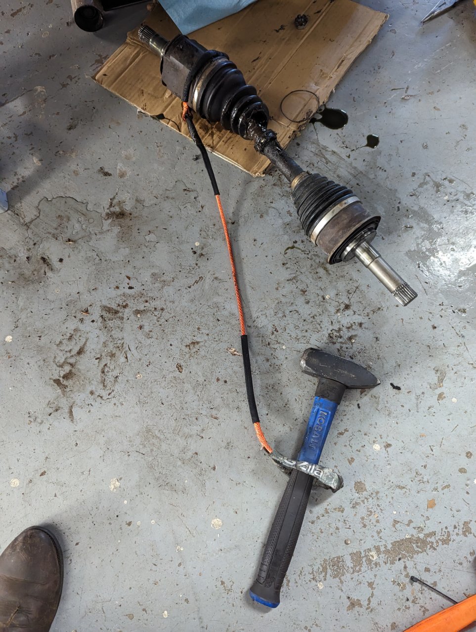

  18. Jan 24, 2023 at 10:58 AM
    #778
    Wulf
    Jan 30, 2015
    #147523
    62,006
    rock raisin
    Swapped out the CV with the torn boot for one of my OEM spares. It probably needs to be rebooted long term because I don't expect the OEM boots to hold out forever but hey, quick fix for now. I ended up having to pull the hub body apart when installing the new CV. I had put it together wrong in my haste last time :homer:
    The Gzilla CV removal tool is handy. No need to try and stick a prybar in there to yank the CV out with the skid installed.
    Poking away at other odds and ends. I begrudgingly dropped the skid plate afterwards since I'm due for a diff oil change. I forgot how I filled it last time but a hand pump ain't it for the 85W140 ECGS prescribes.
    Also noticed my super custom and totally awesome ARB twin mount ripped off the inner fender so I'll need to rework that too. It was supposed to just be a quick fix for a Moab trip that never got reworked so it's not entirely a surprise
    mtnkid85, jubei and det107 like this.

    Never heard of the Gzilla thing before, had to google and that's a pretty ingenious idea!
