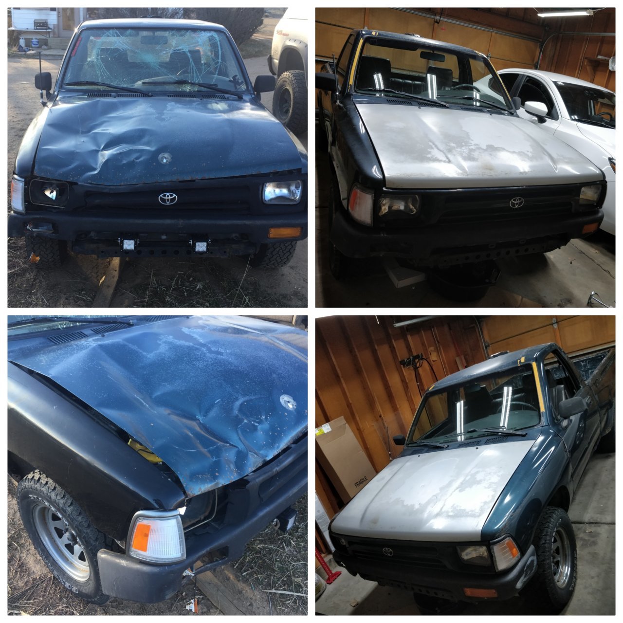

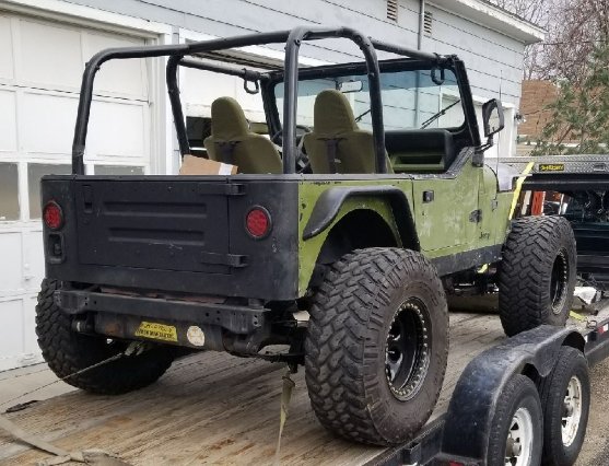

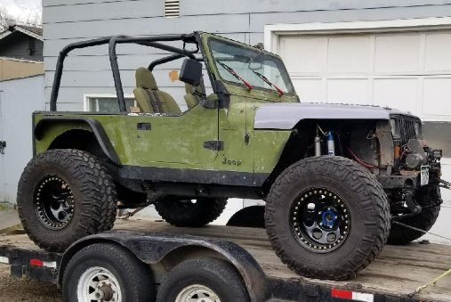

    Posted the little pickup on Craigslist at 9pm last night, fielded a half dozen calls and about 30 texts and it was gone this morning....
    Made some bucks and made room for another project :anonymous:
    In the meantime I've ordered some LEDs for the taco dash, some stainless front brake lines, and a new passenger caliper.

    No, I picked up a different one from U Pull N Pay. Had to do a lot of finessing with a BFH to get the hood support and fenders back in place so the hood would fit and so I could put a headlight in

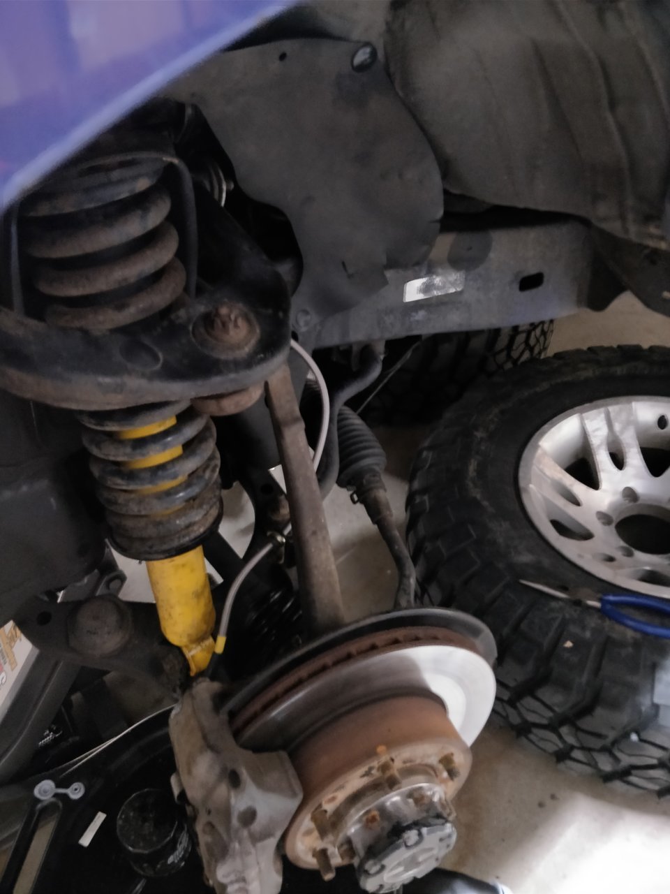

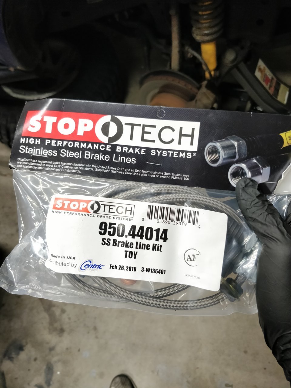

    My passenger caliper was stuck and needed to be replaced. @RockAuto had a deal on braided stainless brake lines for $35/pair so I went ahead and did those too. I should have done both a LONG time ago.
    I have been driving my car less and thinking about selling it and the taco to upgrade to a 3/4 ton pickup. Not sure. Just growing tired of both. The Tacoma only needs a new throw out bearing, headers fixed, muffler rewelded, rough idle diagnosed, dash lights fixed, seats replaced....:rolleyes:

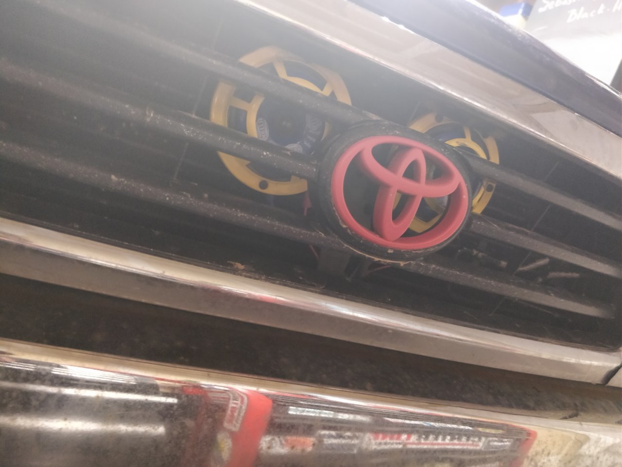

    Fixed the horn (again). Looks like some water got in one of the connections and corroded the aluminum wiring that came with the Hella horns so I ran some new wire and made sure to heat shrink and electrical tape the connections. It's tucked pretty well now.

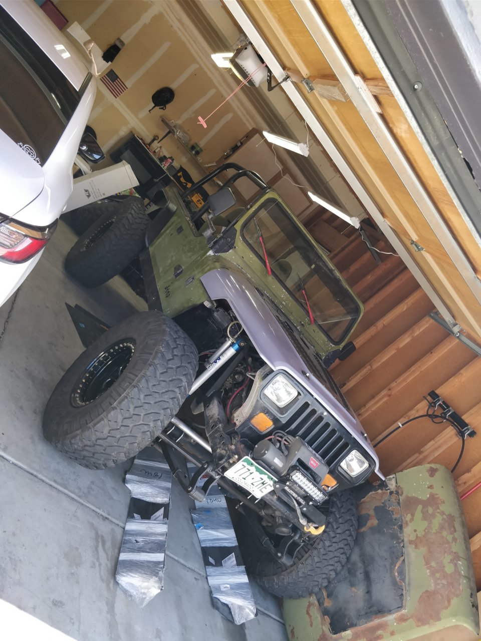

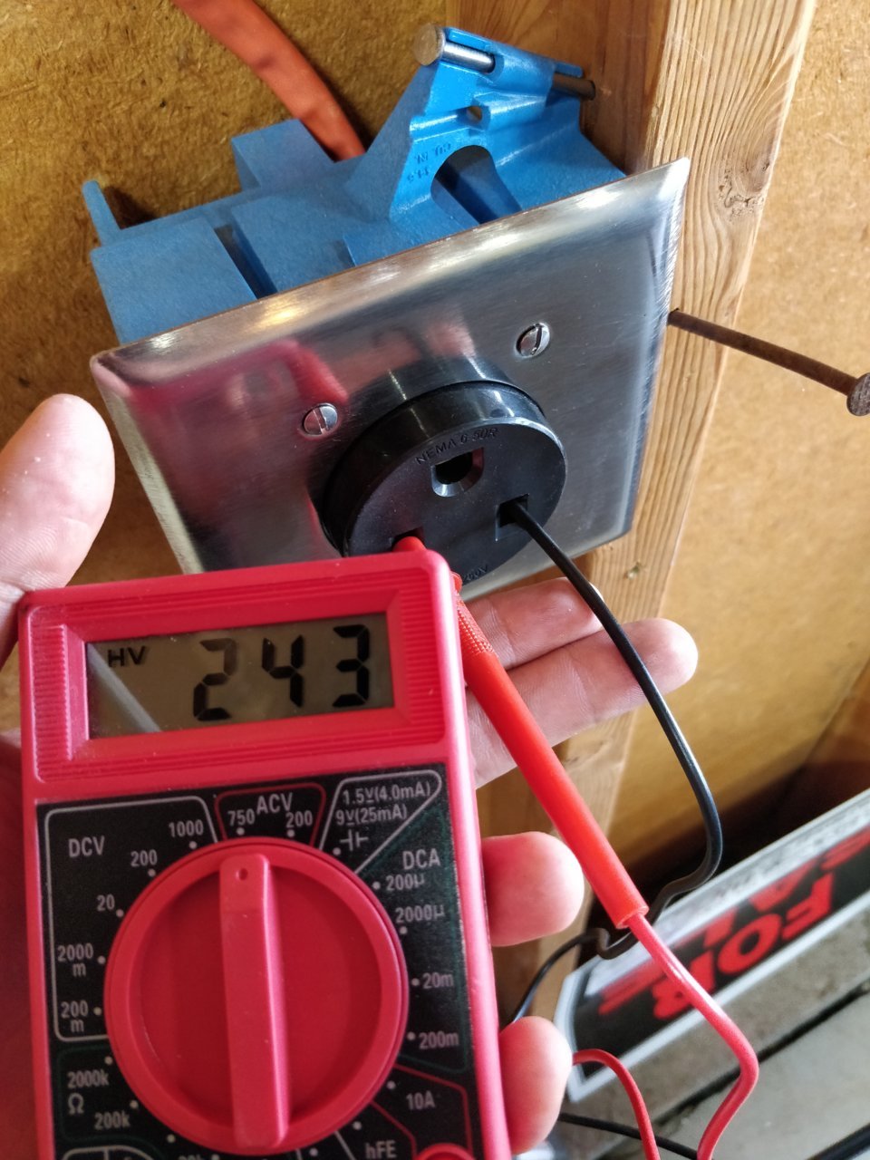

    After a brief intermission for work travel I just finished wrapping up my 240v outlet install in the garage for my welder.
    I need to rework the exhaust on the taco but I also have my eye on one of those CBI DIY front bumpers as an upcoming project...
    HUGE thanks to @Martyinco for providing advice and fielding all of my dumb questions along the way :drunk:

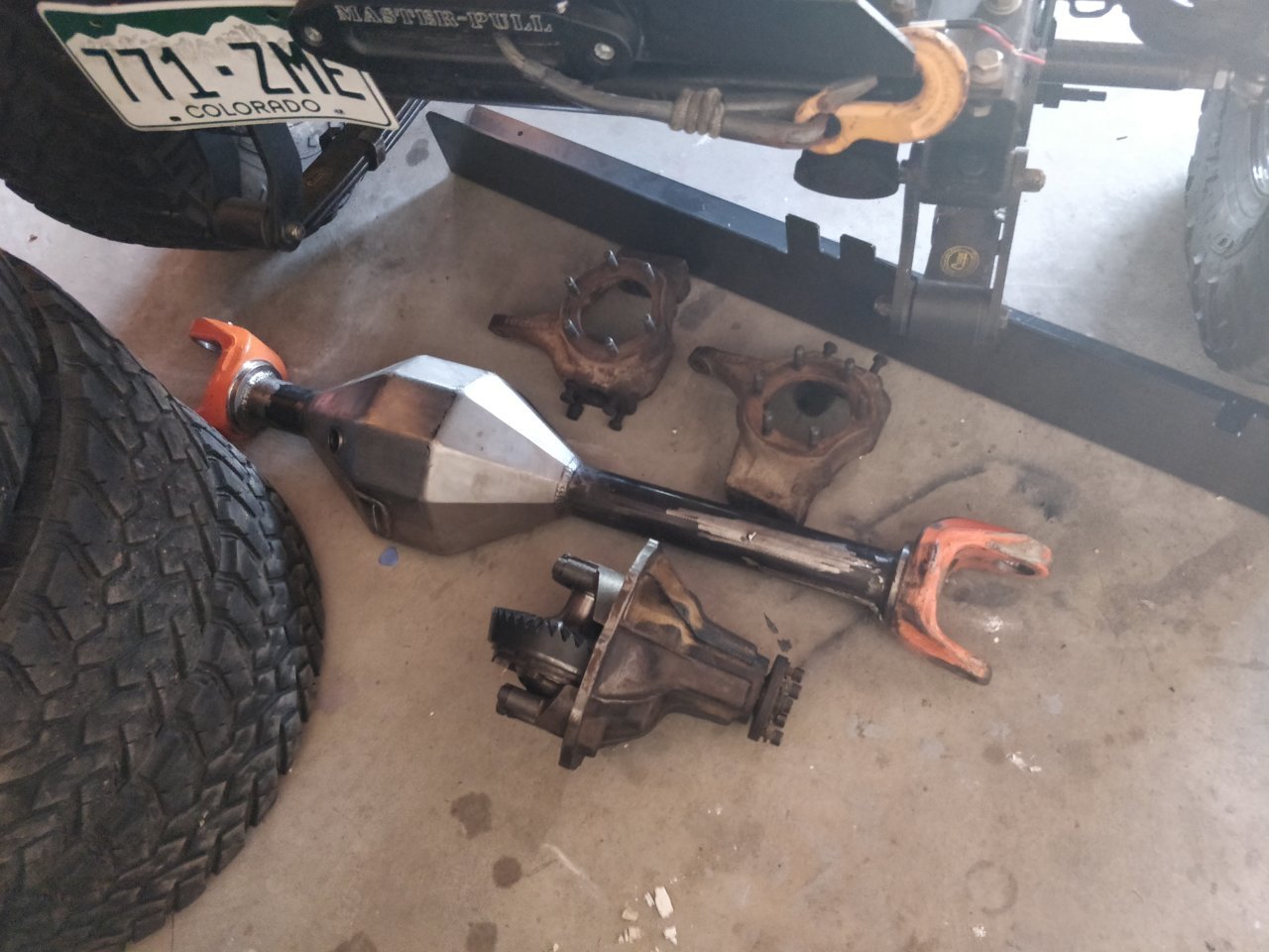

    Alrighty, this build now has some direction. Just picked up this Spidertrax 609 custom housing which takes a 9" third and Dana 60 knuckles. I also got a high pinion third with a Detroit and 4.56 gears. End goal is a low SAS on 35s-37s.
    Oh, and I picked up some 33s (295/70/17) to get me through the summer wheeling season :anonymous:

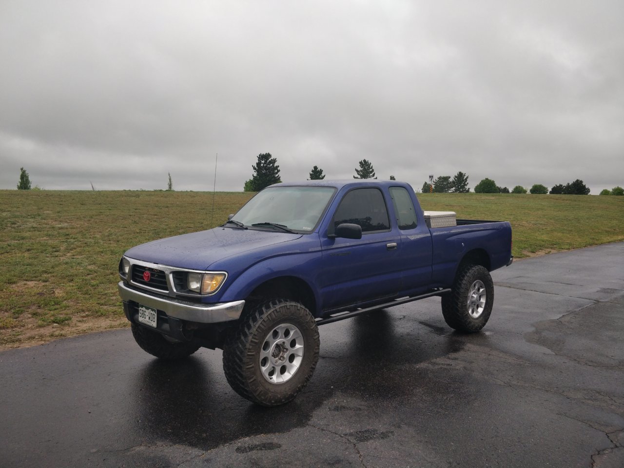

    Installed the new wheels/tires for summer... now if the weather would just cooperate :rolleyes:
    295/70R17 Nitto Trail Grapplers on 2010 4runner Trail Edition wheels.
