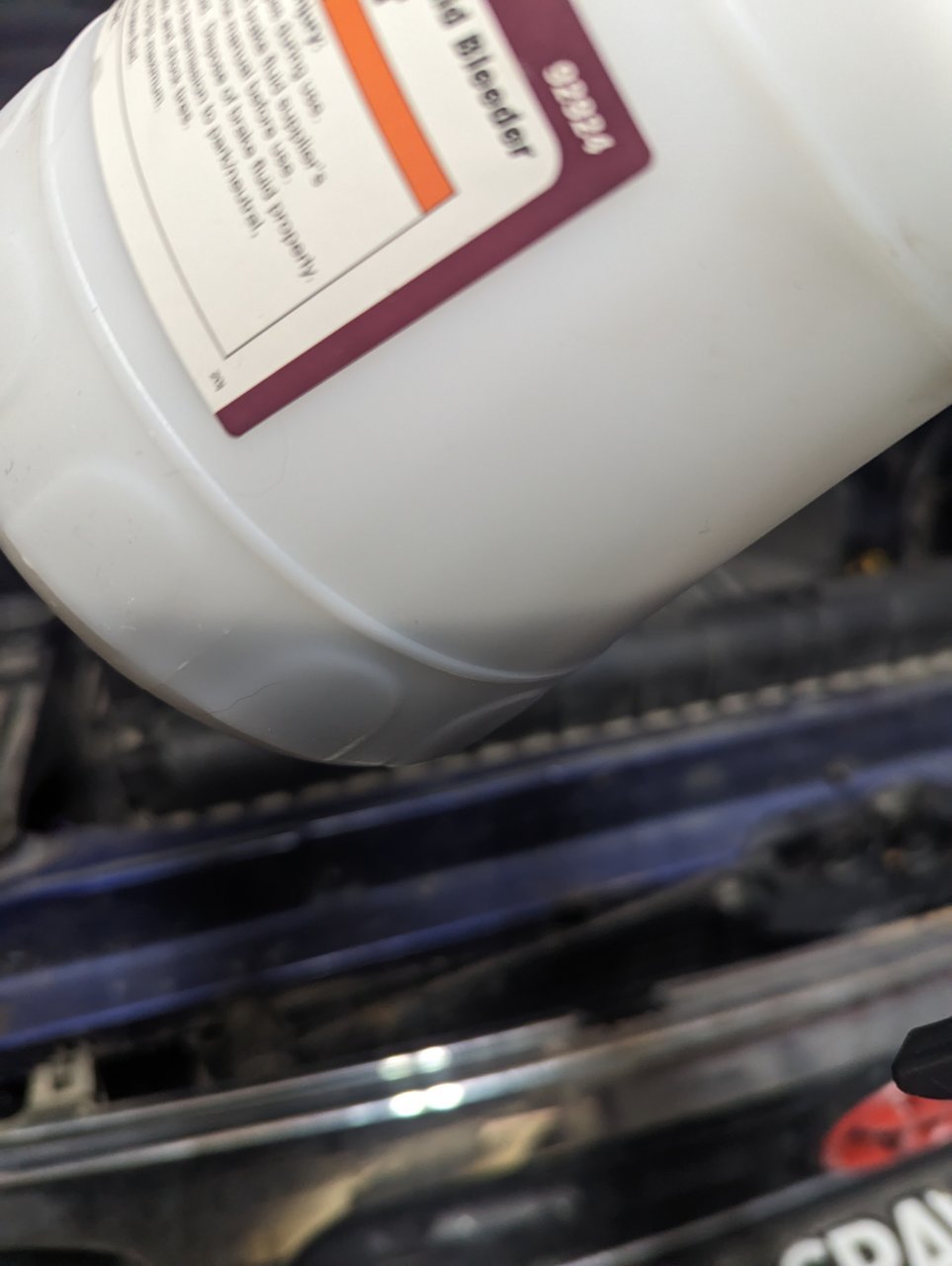

    I forgot what a bitch this clutch was to bleed the first time. I have been doing the one person bleed for years but had to pick up a pneumatic bleeder.

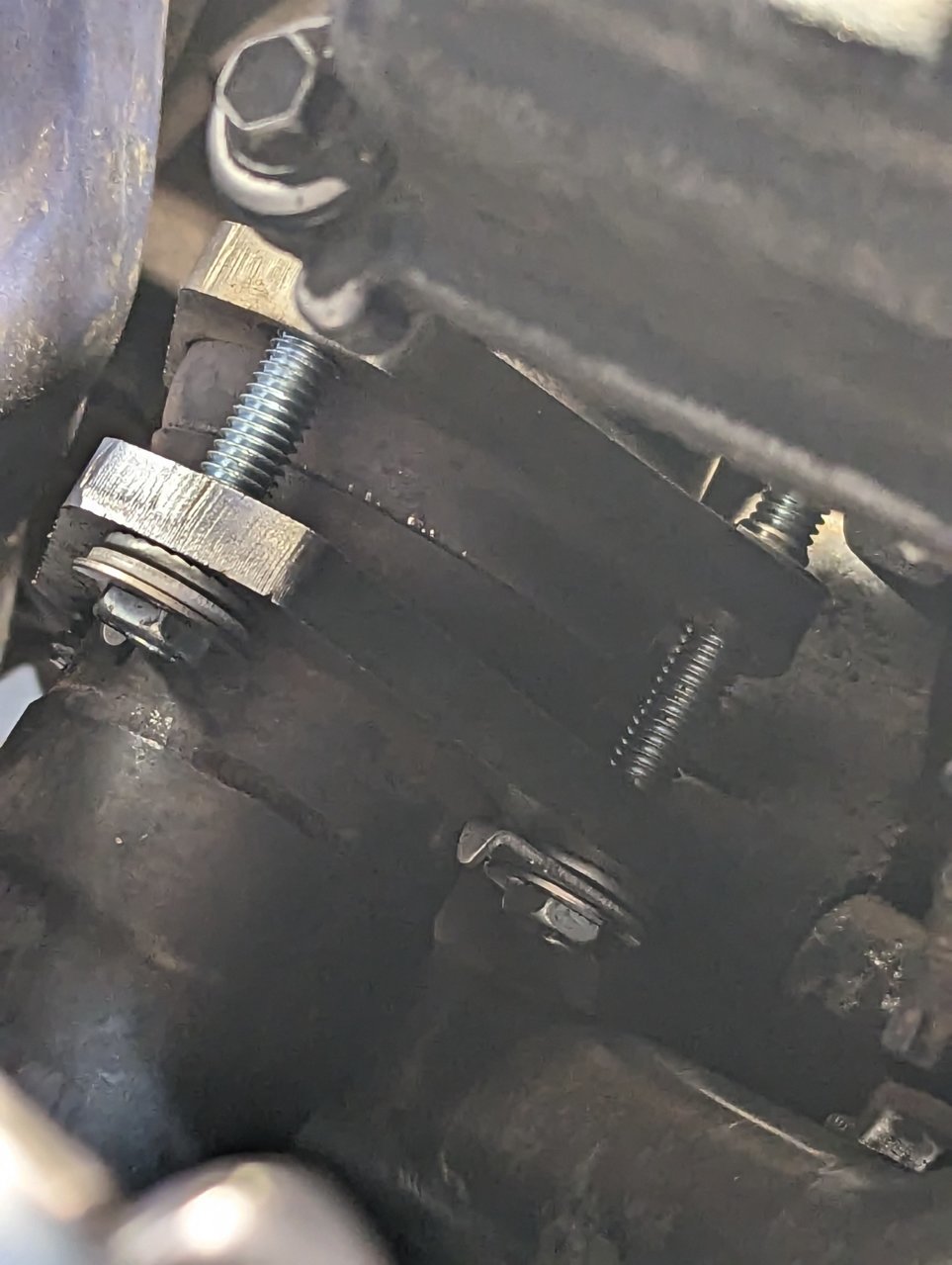

    Got the Stage 8 locking fasteners in.
    Spent way too long getting the bottom right installed but I was victorious in the end. Pictures really do not convey how little room there is to stick your hand in there and line up the nut on the backside. The angle of the tube means you cannot install the bolt from the other direction either. Great design by DNA. Anyways the Stage 8 stuff is nice. When facing the flange the tang didn't give more than a mm or so of engagement so I flipped them over. Should be good to go for a while, at least at this connection.

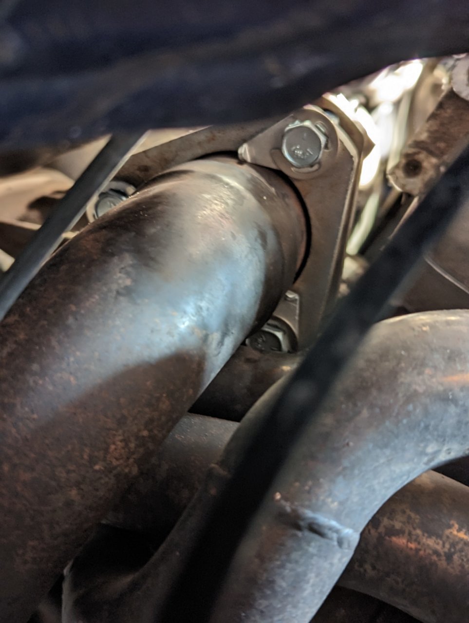

    With the exhaust hardware in place and the fenders bolted up the truck is much less of a rattler POS. I've been enjoying getting groceries more, at least :D

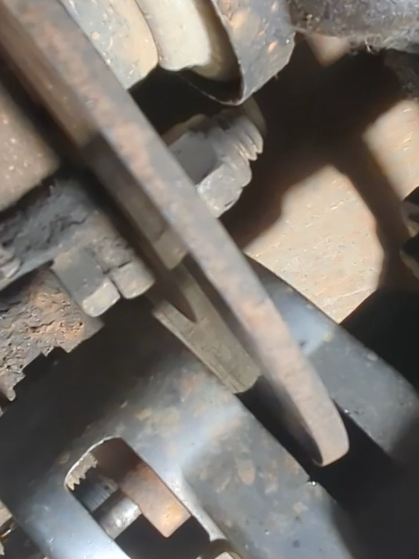

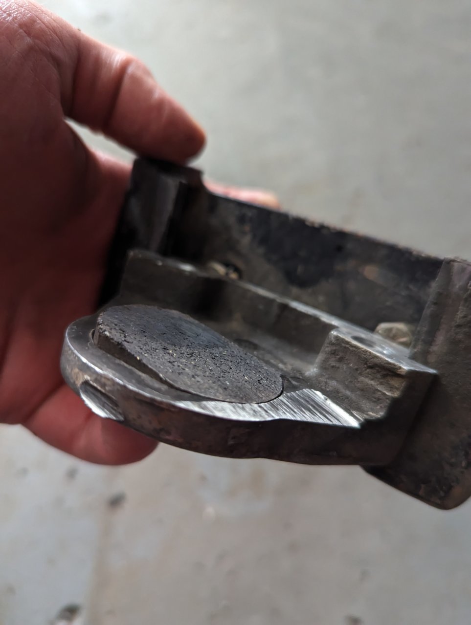

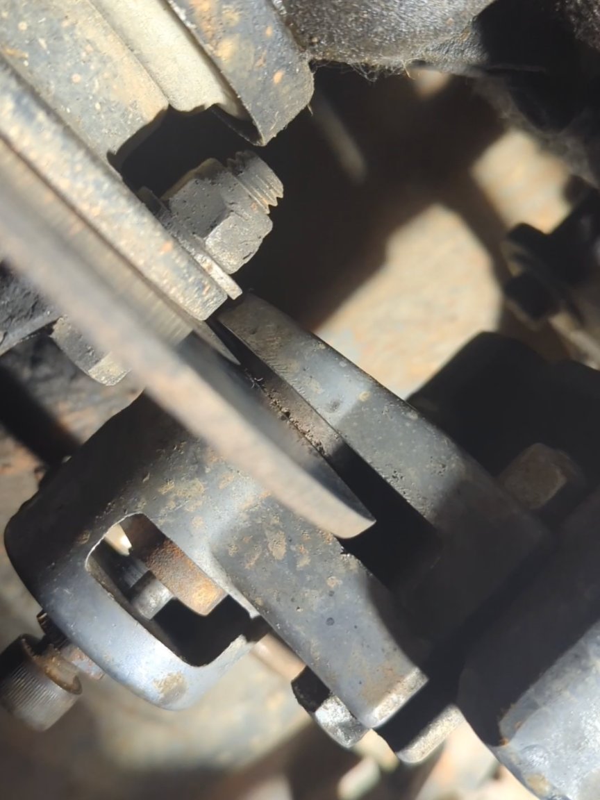

    The last major annoyance is the tcase brake. The inner pad fell out a long time ago and it's been bouncing around since. The remaining pad isn't looking too hot either.
    I think I'm just going to slap on a cheap caliper from Amazon in the meantime but I'd love to pull off the whole setup, take some measurements, and see if we can't find a way to make a better caliper setup fit under there.

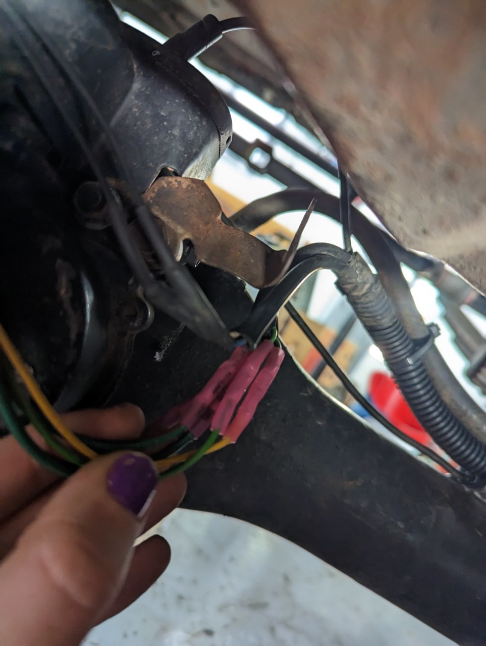

    Not a lot of pics to show but I've been poking at all kinds of stuff that really annoyed me about the truck in preparation for summer. This truck can be a lot of fun to drive and I've been missing it quite a bit... Little things that needed R&R included my window cranks, slider latch, seatbelt, ans the tiny manual mirrors which were replaced with the updated chrome foldaway ones. I also put on a fresh set of KO2s I picked up for a deal from a buddy.

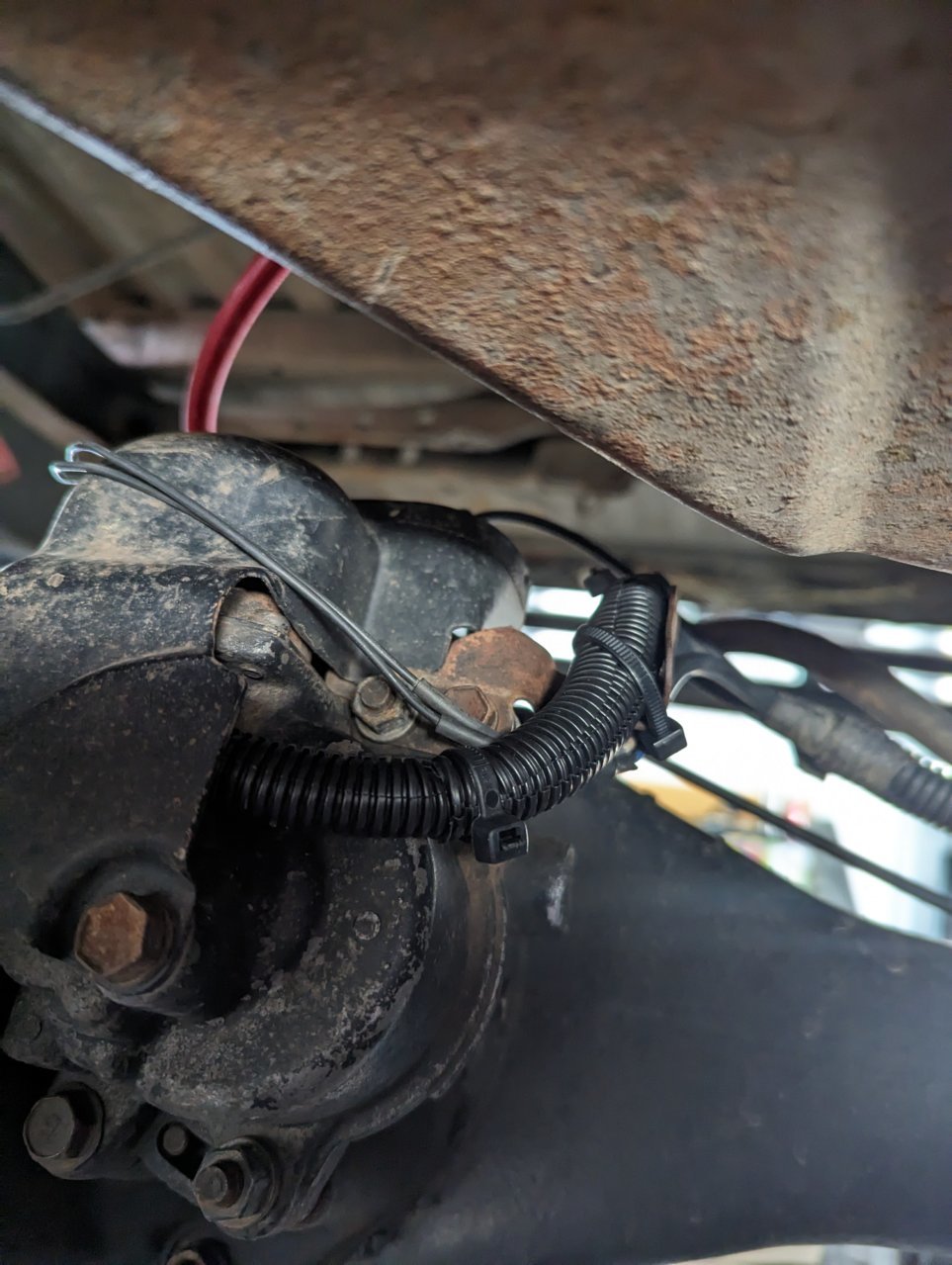

    The low range elocker harness has been a thorn in my side since the very first off-road trip. After having it pull wires out of multiple pins multiple times I deleted the connector with heat shrink adhesive butt connectors. Not really concerned about water intrusion, when I stripped the wires back they were already corroded from water intrusion that happened with the LRO harness connector. Gotta make sure to add corrugated tube and zip ties to hide your sins make things tidy :)PXL_20230430_205435923.jpg PXL_20230430_210236728.jpg

    The heat shrink but connectors are pretty clutch for that kind of stuff. That or the solder tubes that you just hit with a heat gun

    damn, I didn't know that was a thing! Those look really neat... I'll have to order some to keep on hand. Is there a brand you'd recommend?

    I just got whatever Amazon kit had the most reviews. No problems so far

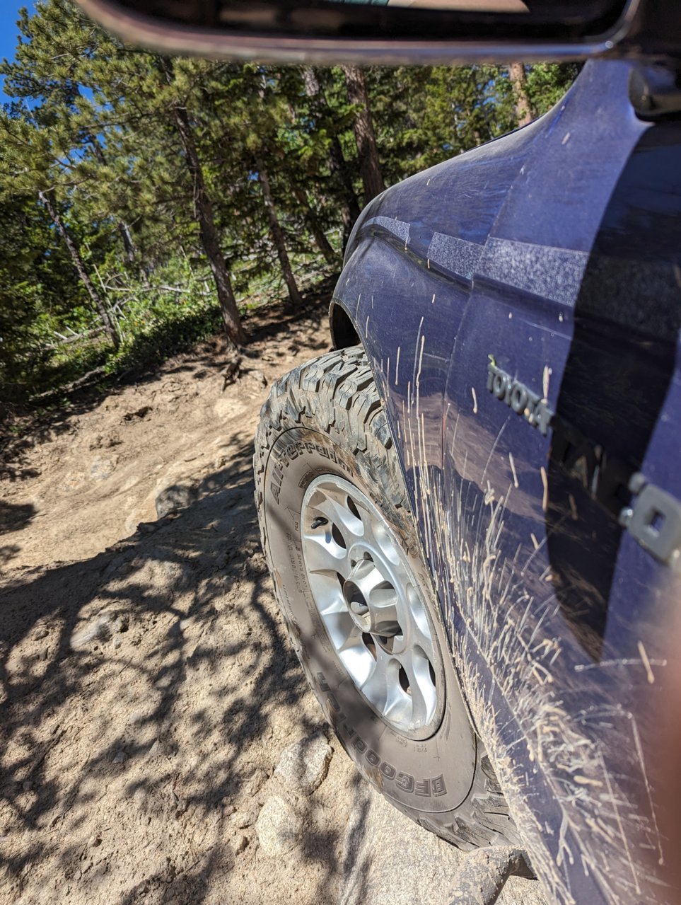

    Went back out today and ran a couple more trails (Ironclads/Bunce/T33). Even stopped for some poser pics this time :p
    PXL_20230703_165834360.jpg PXL_20230703_163908386.jpg PXL_20230703_163803832.jpg PXL_20230703_163814830.jpg PXL_20230703_162055489.jpg
    The truck is running great. I'll need to shake down the front end because I have a pop in the steering now but I knew I'm already due for new TREs at a minimum and carry them with me
