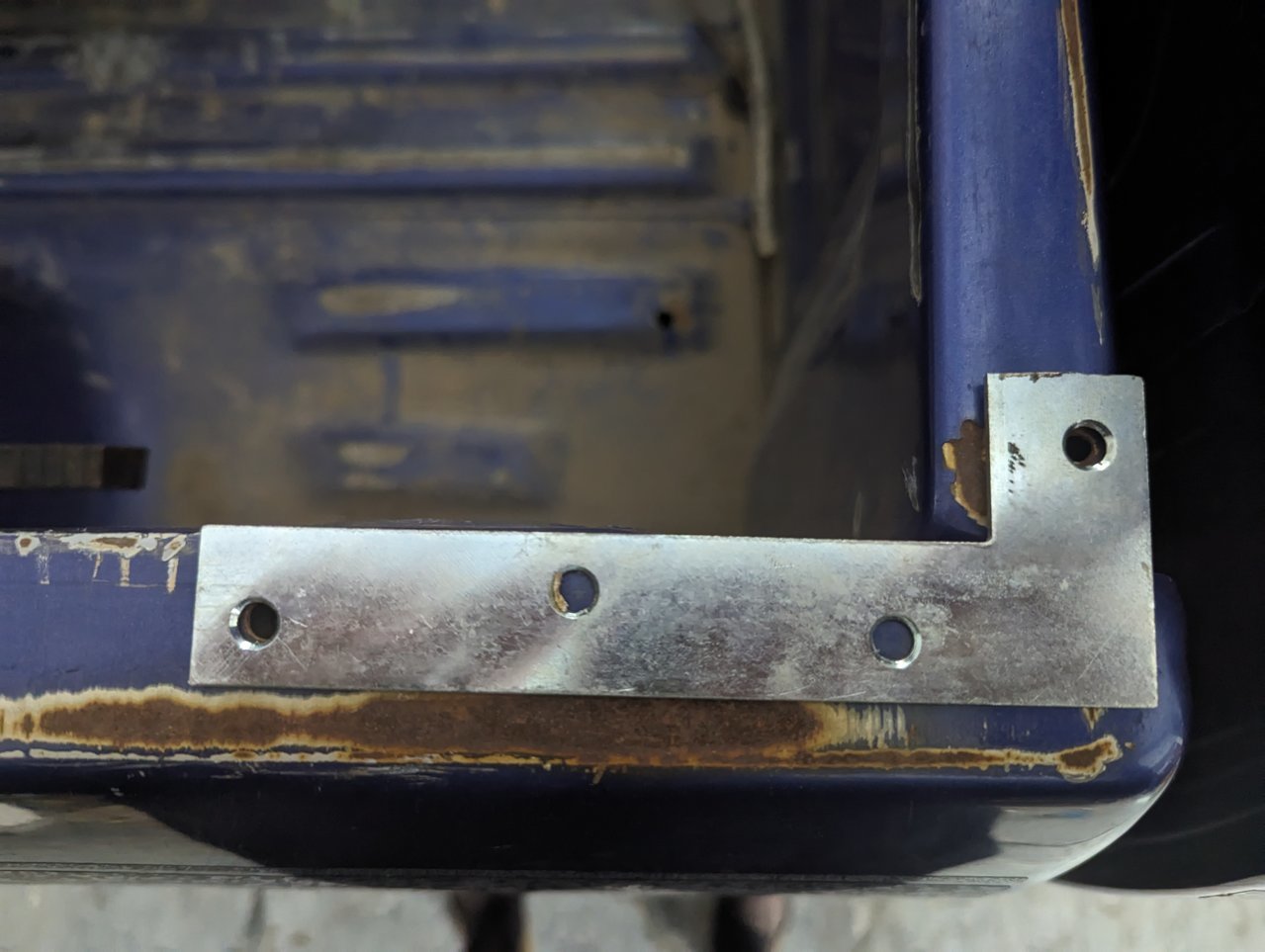

    The answer is a mixed bag. I suspect it's been cracked for a long time and I didn't notice. This bed has other repairs on the opposite corner from the PO as well (if you look closely the Bondo on the bedside in front of the driver taillight is falling off). It looks like the PO knew about it and probably had repaired it once because I pulled a random diy shelving bracket out to hold the corner together to help weld it and the holes lined up with ones in the bed.
    That said I have had a hilift mounted on that same bedside off and on over the years, as well as having had an over the rails toolbox in the past. Combined with a 35" spare in the bed it's been in for a lot of abuse.

    Ah, so the crack was at the front. Think the bed stiffeners would make a difference with a cross-bed toolbox?

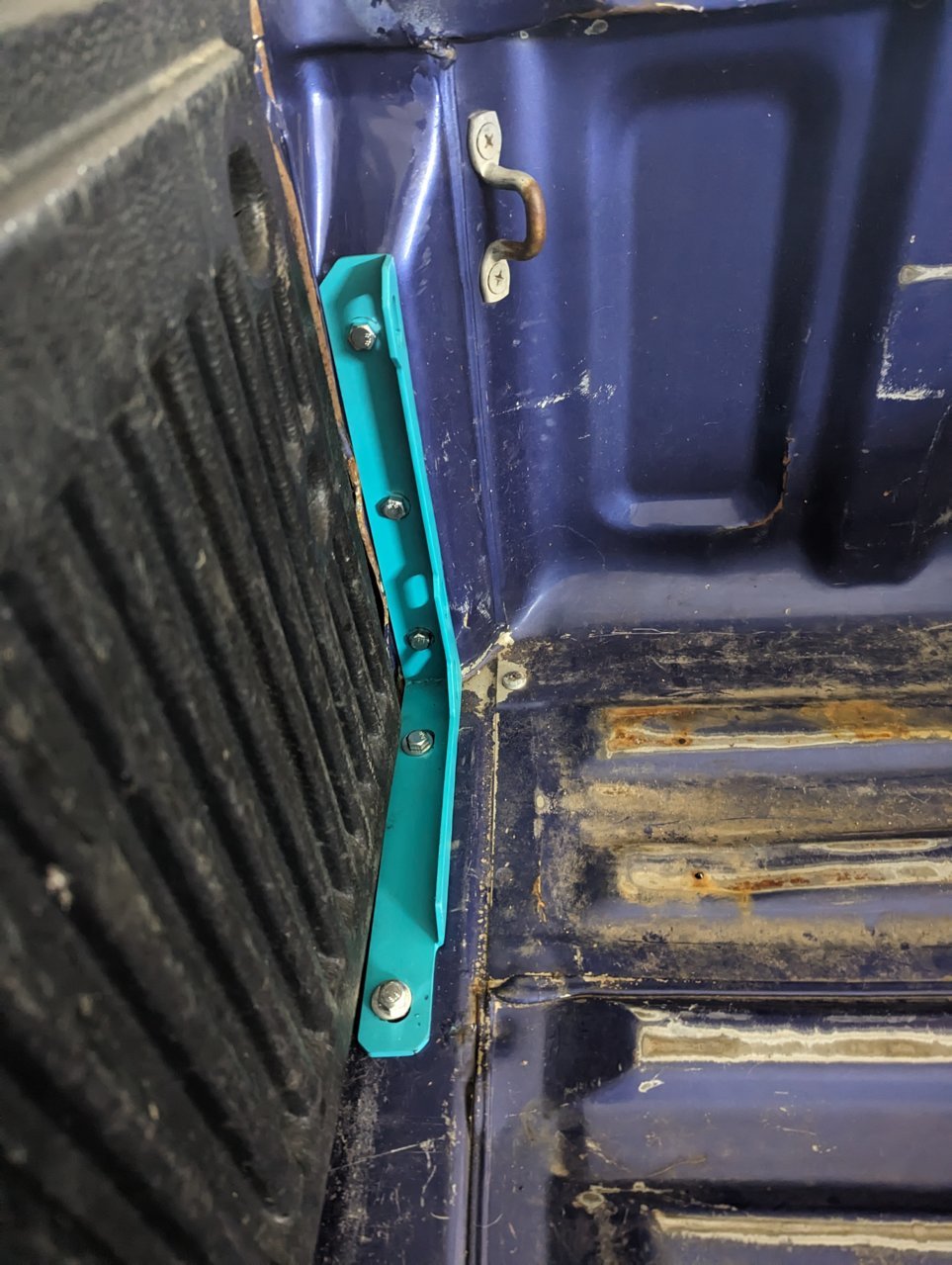

    yeah, I think so. Adding bed stiffeners at the tailgate increased the rigidity of the whole bedside a decent bit. The before/after of how much I was able to flex the bed side with my own body weight was noticable.
    I think that gusseting the front bed corners as well will help though I'm worried that will just result in the bed cracking somewhere else lol

    I don't think I posted pics in this thread but these are what I installed thanks to @Kwikvette
    Prior to installing if I grabbed the corner above the taillight I could flex the bed about 1/8" in toward the tailgate or away from it. Now It's much less

    Maybe bracing the whole bed rail would help in your case...

    oh yeah, capping the bedrails with angle iron would do a lot to help hold things together. I've been going back and forth on getting a used bed to replace mine since is smashed but it looks good enough from 20 feet away lol.
