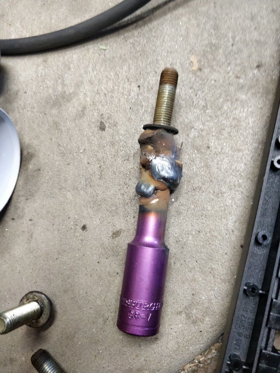

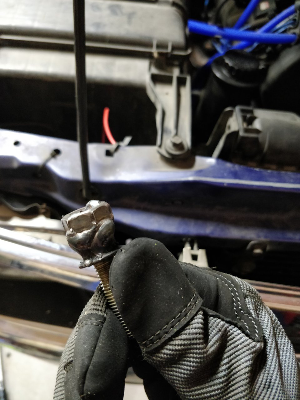

    The hub bolts were pretty well seized and I stripped a couple of them backing the nuts off. Then the cone washers wouldn't budge.
    Then the front 2 lower ball joint bolts were frozen solid and stripped. I broke a pair of HF vice grips and rounded off an Irwin bolt extractor.
    I got one out by welding a nut to it. I welded a nut to the 2nd and the nut actually cracked and broke so I decided to call it for the day :bananadead: at this point there's no rush since I couldn't find the hub studs anywhere in town and have them on order from Marlin

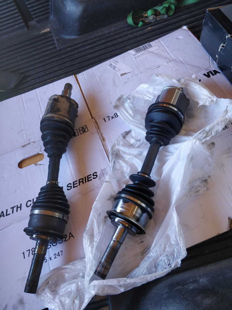

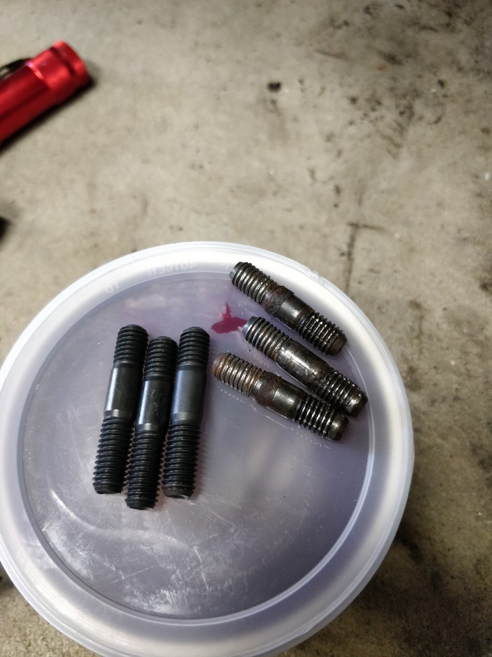

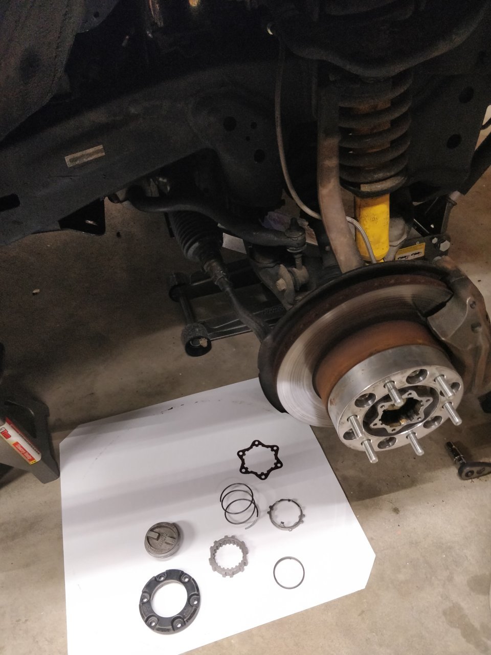

    Parts from Marlin were delivered Friday so I finished up the CV swap yesterday.
    Ended up having to sacrifice a socket to get the other LBJ bolt out as well.
    I replaced all 6 hub studs since I stripped several during removal.

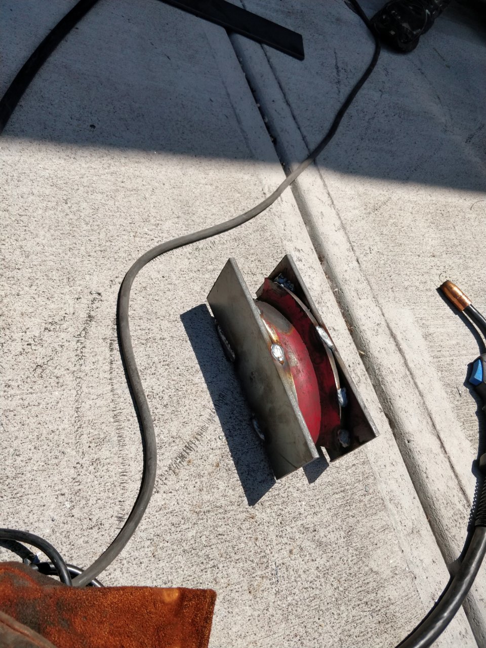

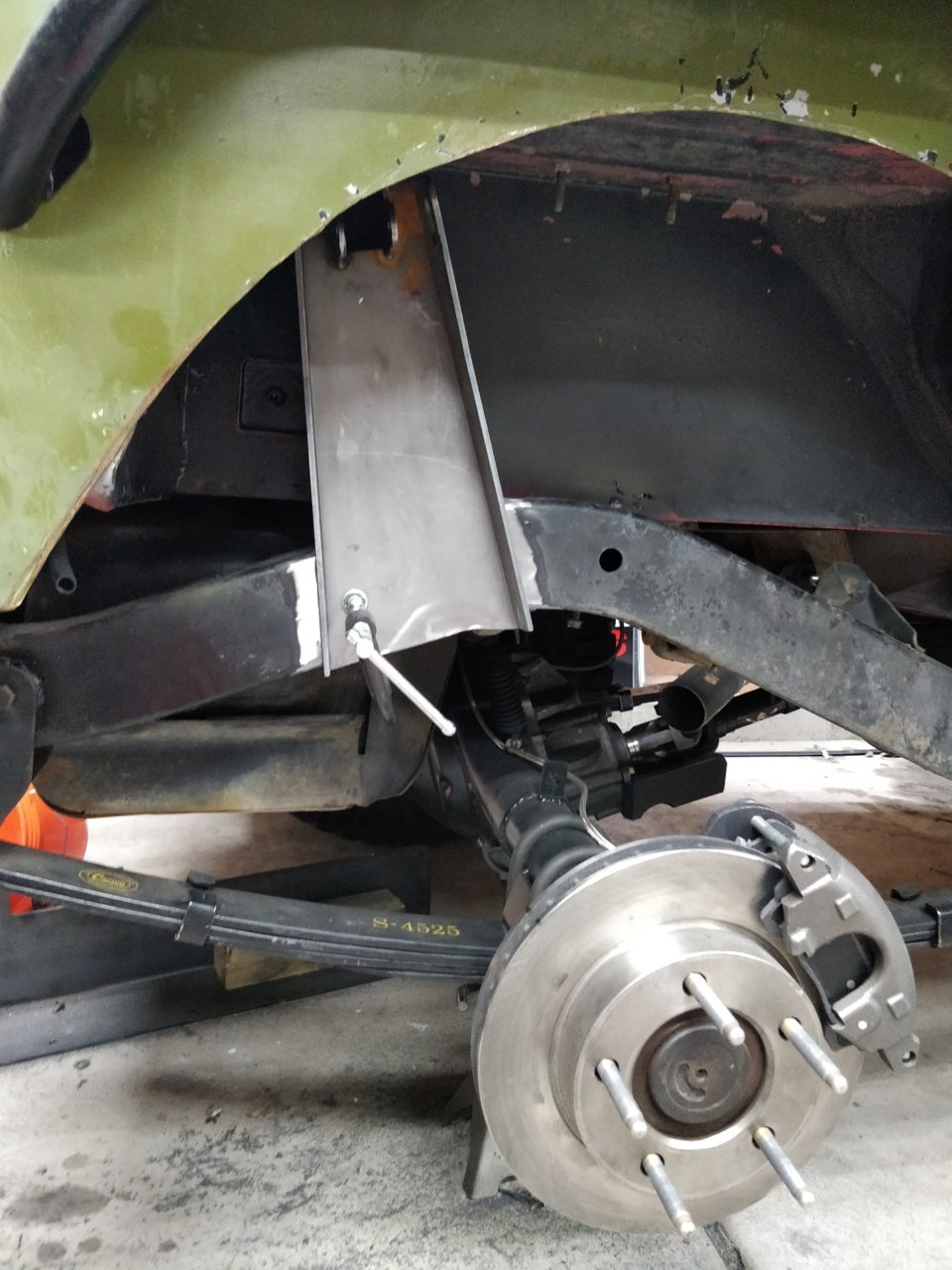

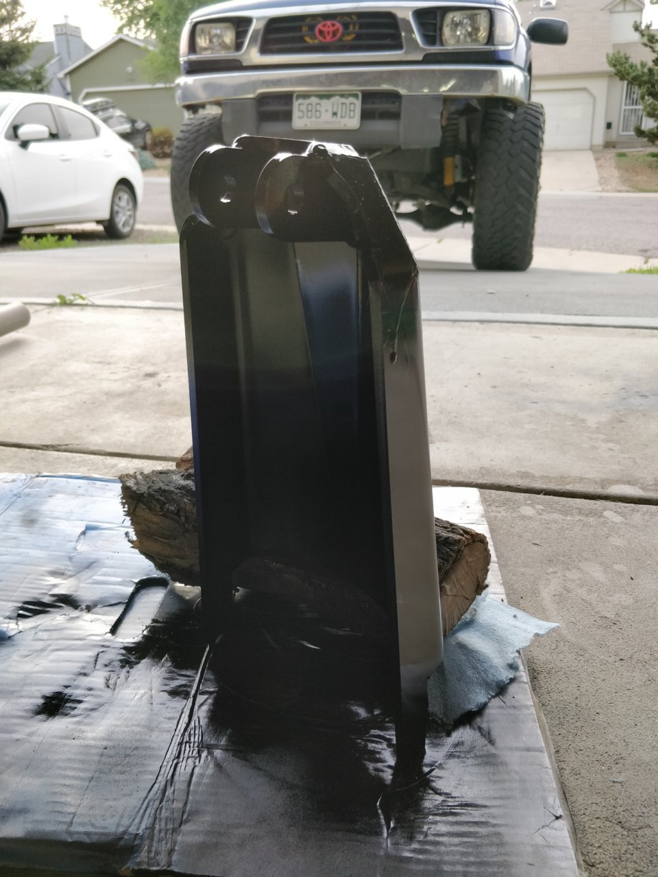

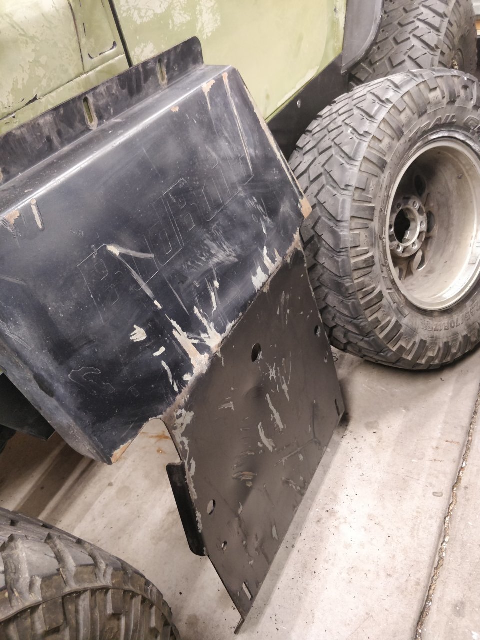

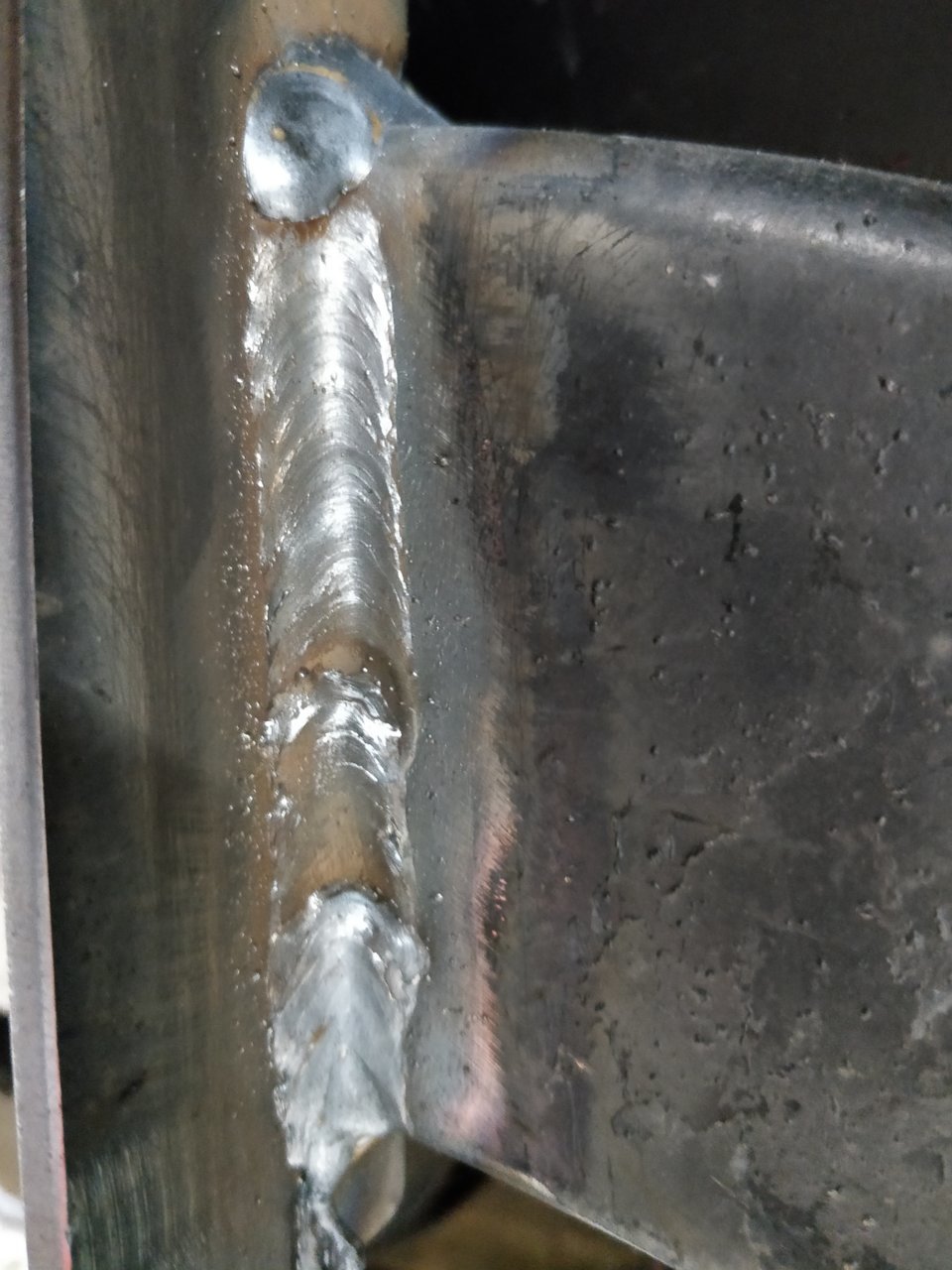

    I also dedicated some time to the YJ crawler this afternoon. I cleaned up the remnants of the factory shock tower and fitted up the new one from Barnes4x4 before welding it up.

    Spent most of this weekend in the garage. When I did the CV on the taco I must have messed up the inner axle seal because it immediately started puking gear oil. After waiting all week for the part I tackled it yesterday. I'm surprised it didn't leak before because the seal was actually installed backwards by whoever worked on it last :rolleyes:
    Painted the hub face to make it pretty while everything was apart. Instead of using grease I lubed all of the hub internals with 75-90 gear oil (since that's what I had on hand for the diff) and it moves much smoother than it did with the grease.

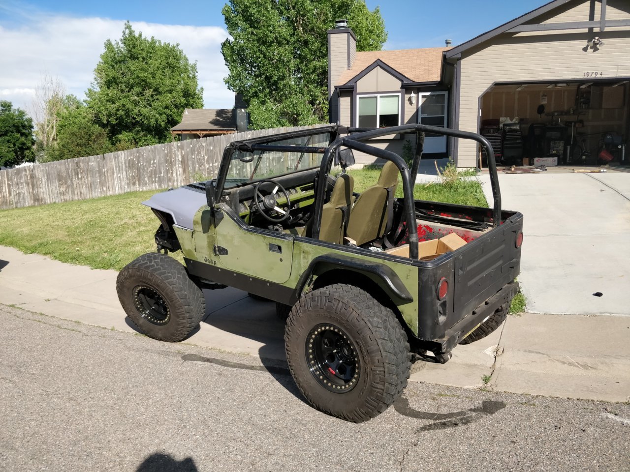

    In other news I did the VSS wiring to connect the speedo on the Jeep...oh and I just flexed it out so I could figure out where I need to weld up the rear shock mounts

    Trying to get this shit wrapped up and out of my garage so I can get back to working on Tacoma stuff. I always make a little less progress than hoped :annoyed:
    Shock is not fully installed yet

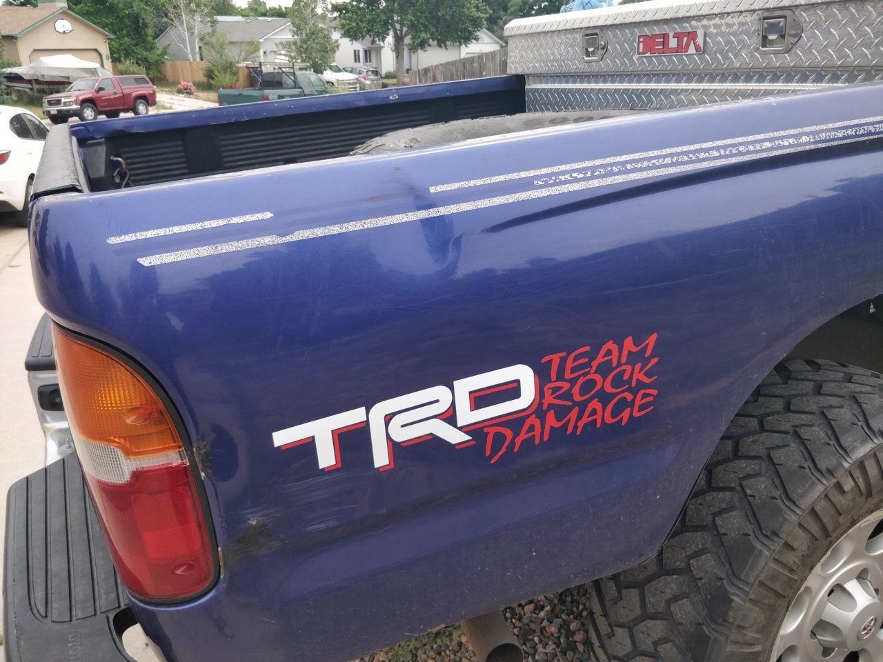

    I've been learning how to work with vinyl so I made up my own bedside decals this mornifn when I couldn't sleep

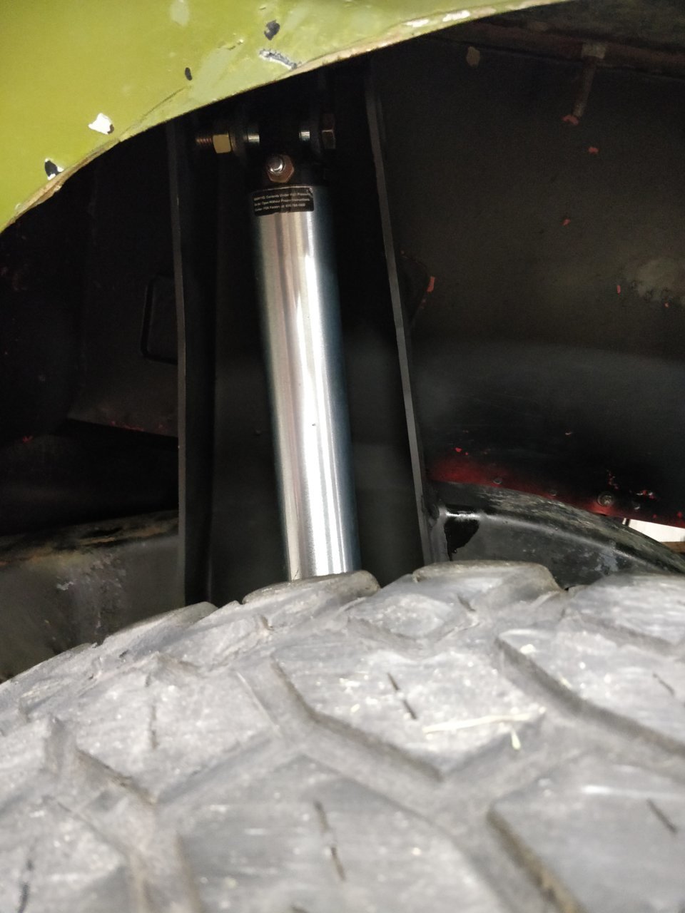

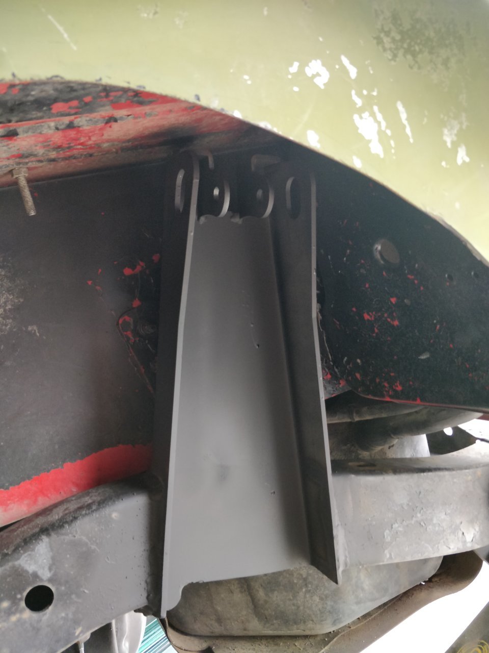

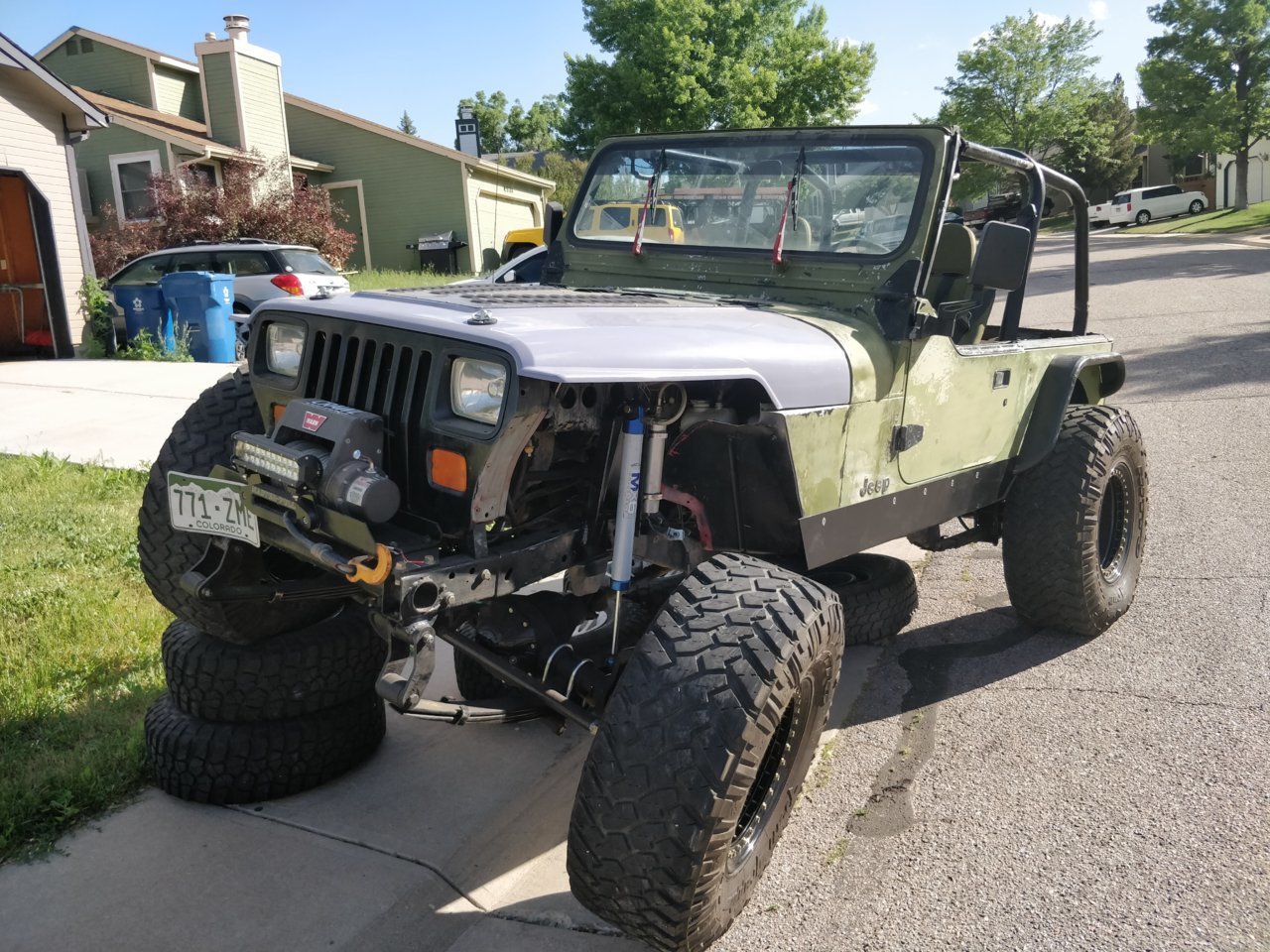

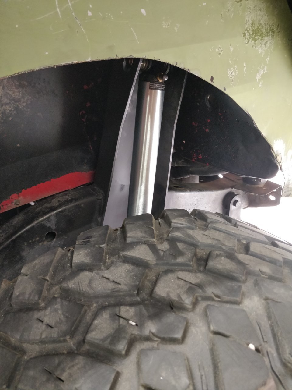

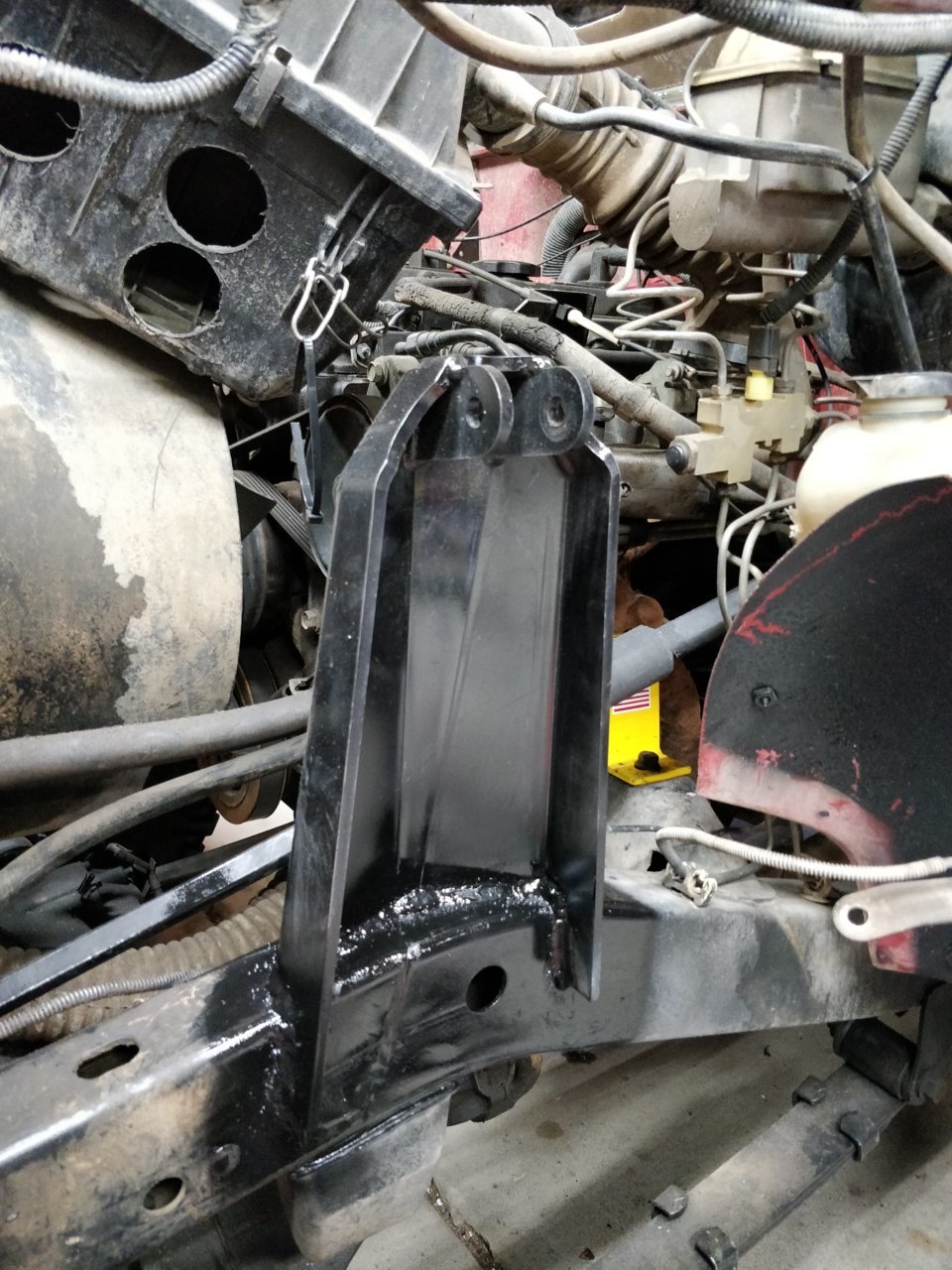

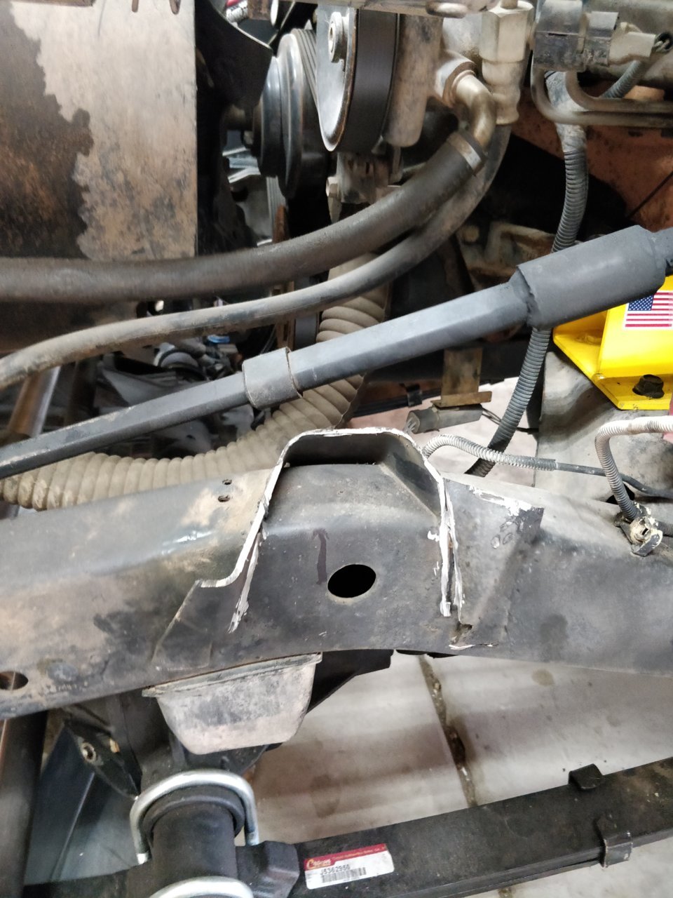

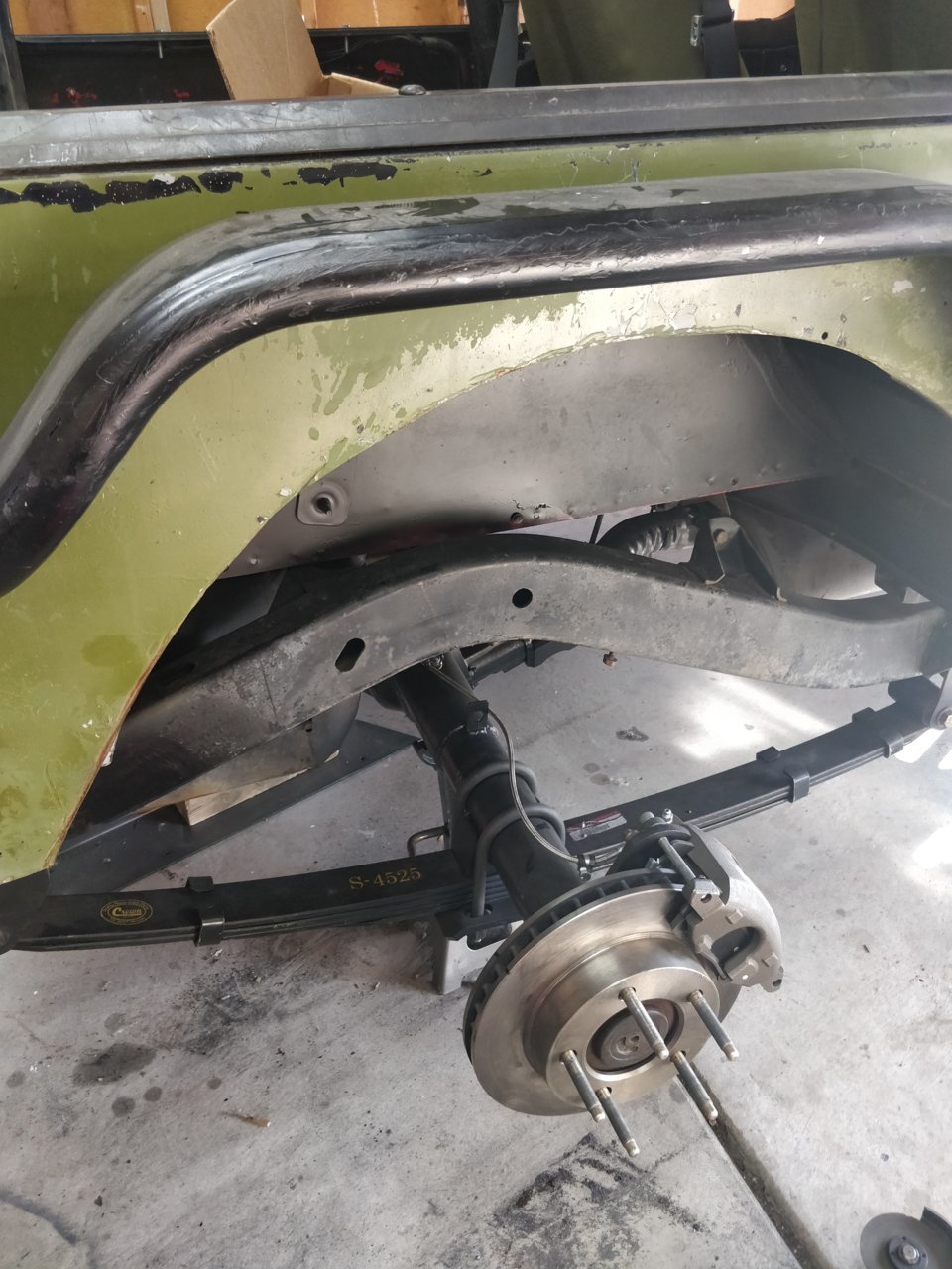

    Got the left rear suspension all finished. Running fox 2.0 shocks on the rear.IMG_20180616_172851.jpg

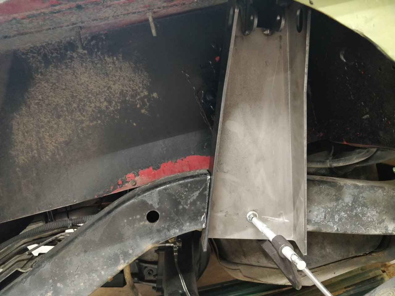

    Then it was on to the other side.
    Still need to weld the the back and bottom of the tower and do the axle side but that should be the last of what's keeping the Jeep off the road :rolleyes:

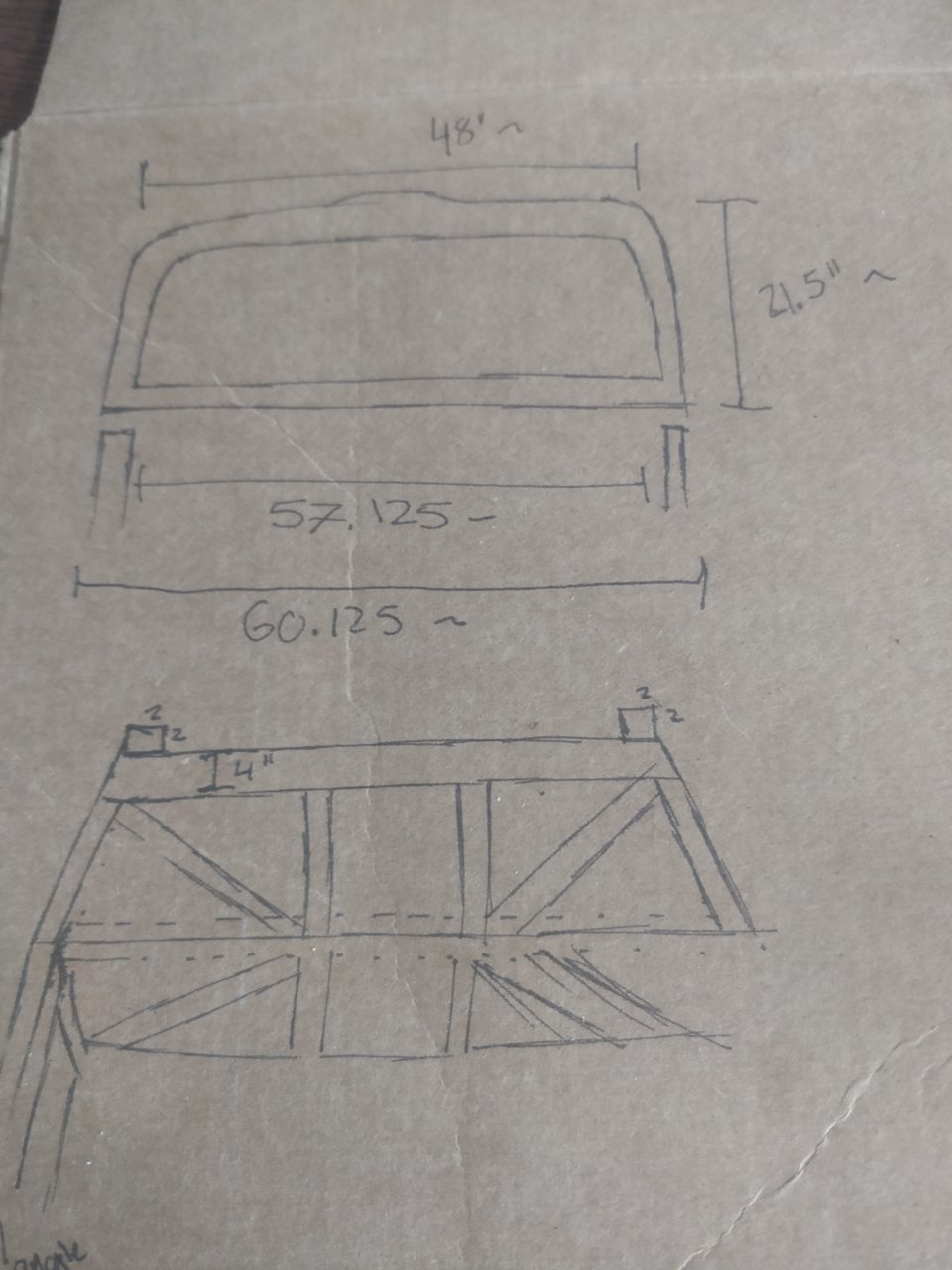

    I've been thinking about building a headache rack for the truck. I picked up some 2" square tube for it already.

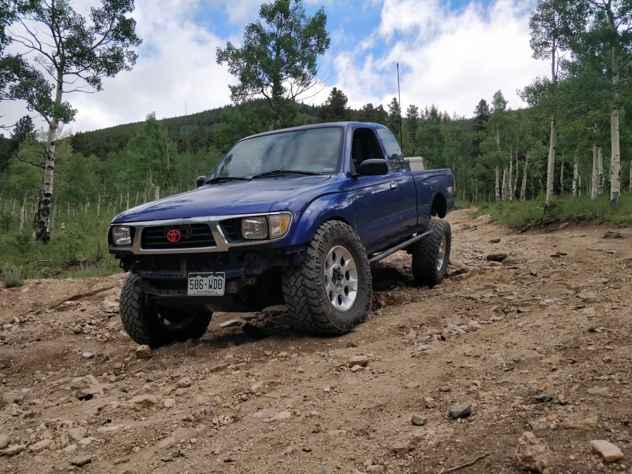

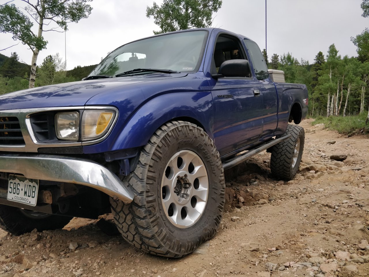

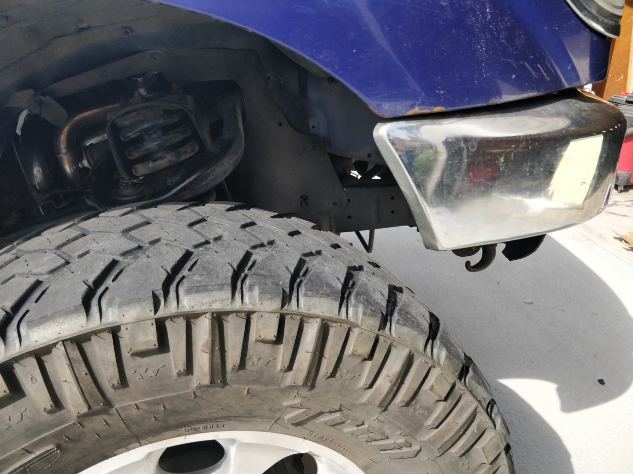

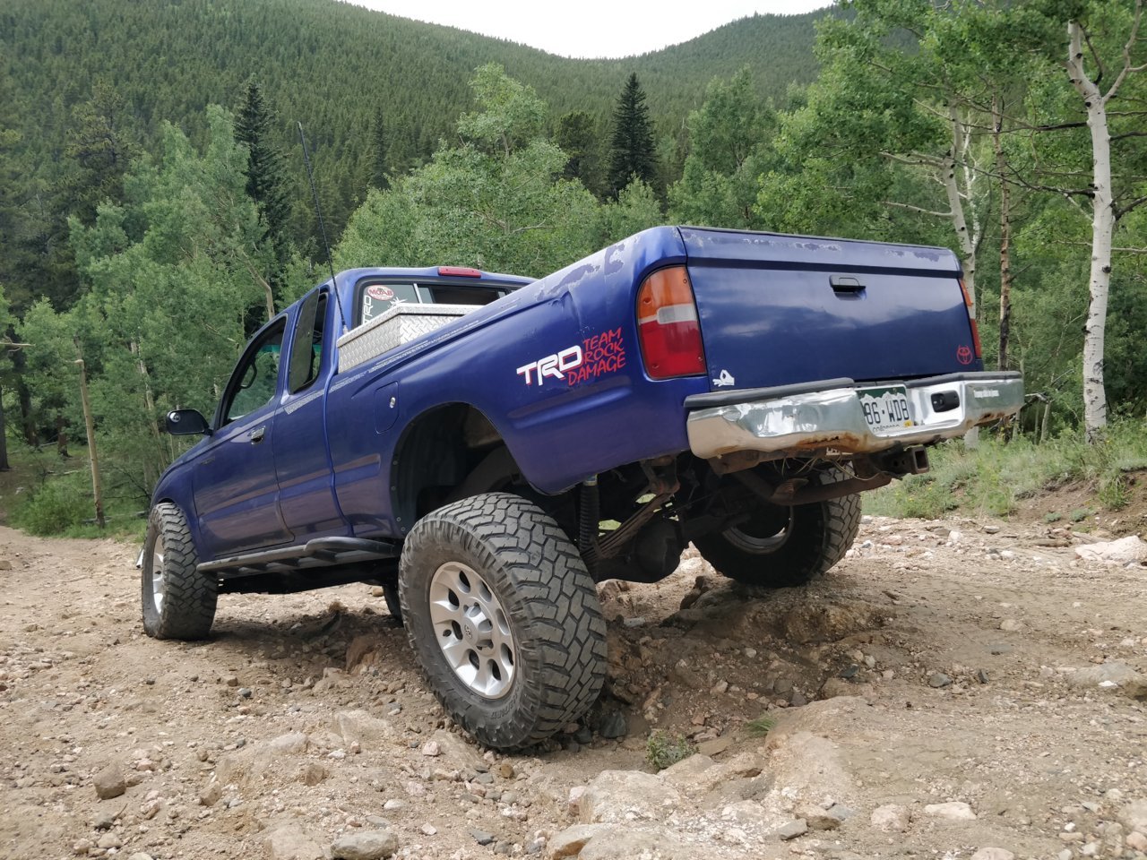

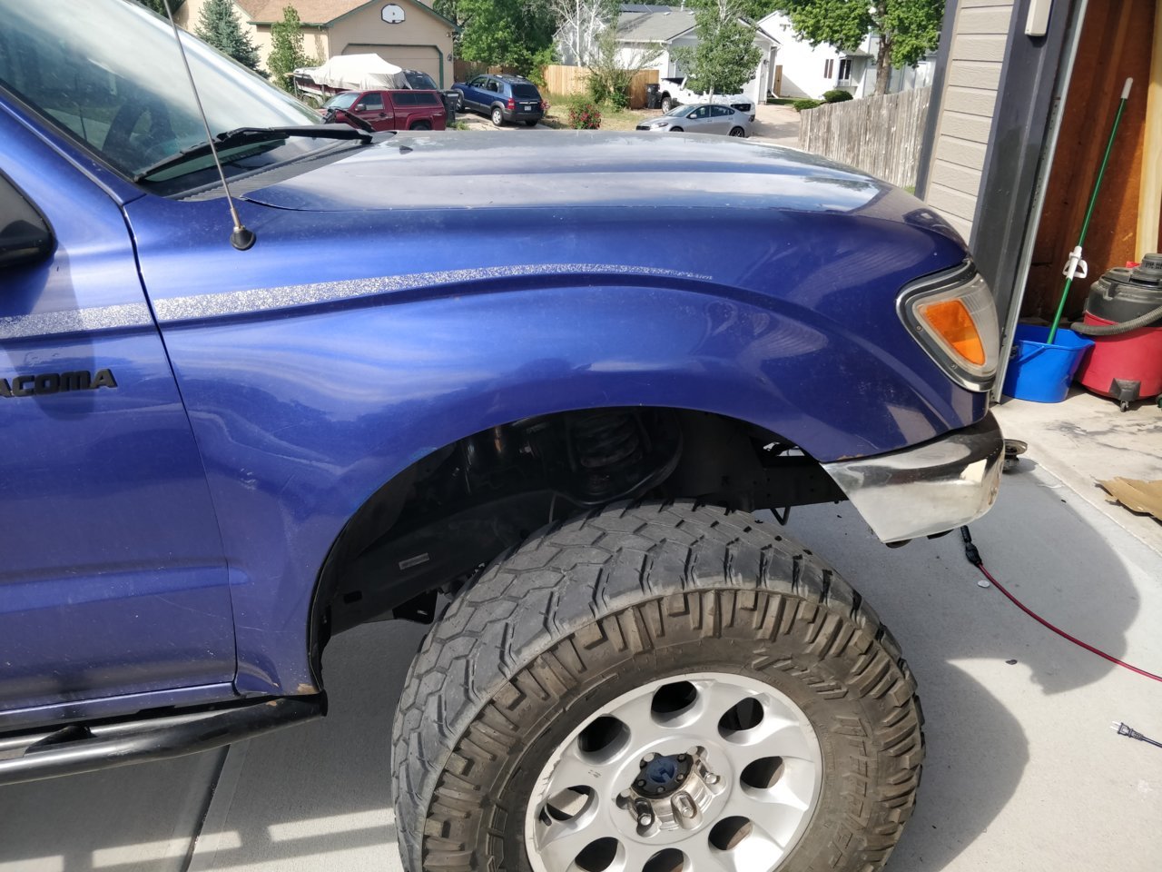

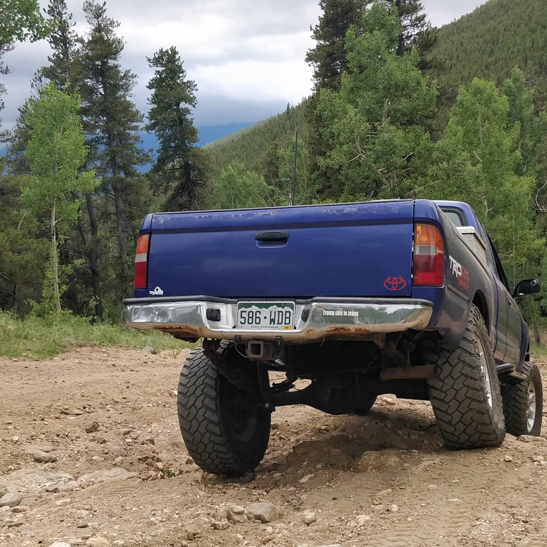

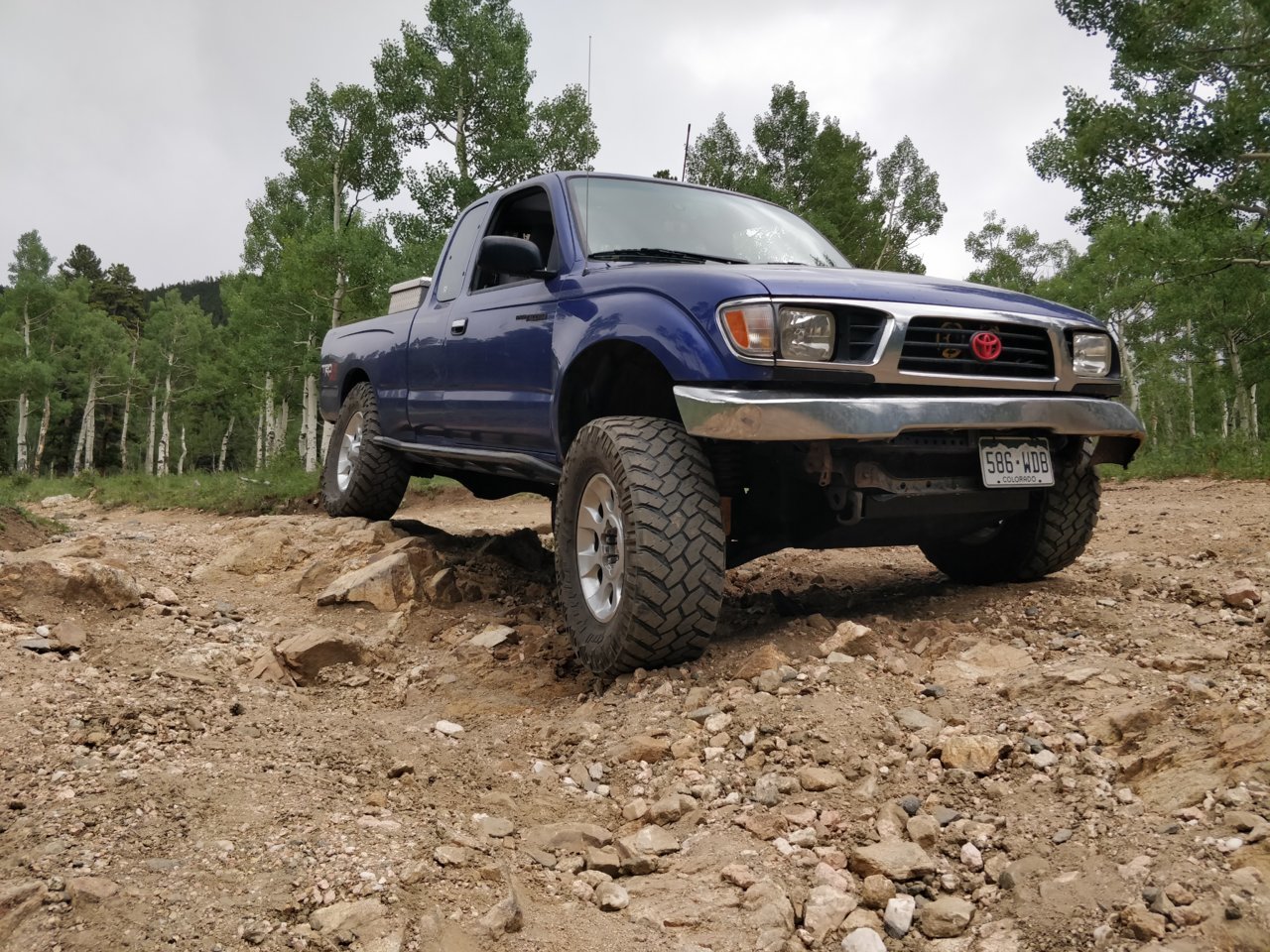

    Ran Slaughterhouse Gulch to shake the truck down for summer wheeling. never had rubbing issues this bad before but I disconnected the swaybar and didn't think to check.
    Oops :bananadead:
    Still had a good day on the trail :)

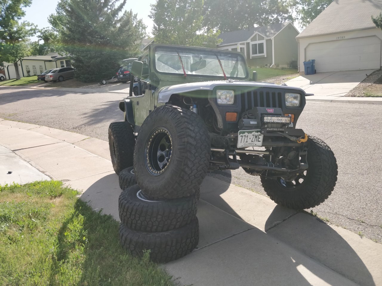

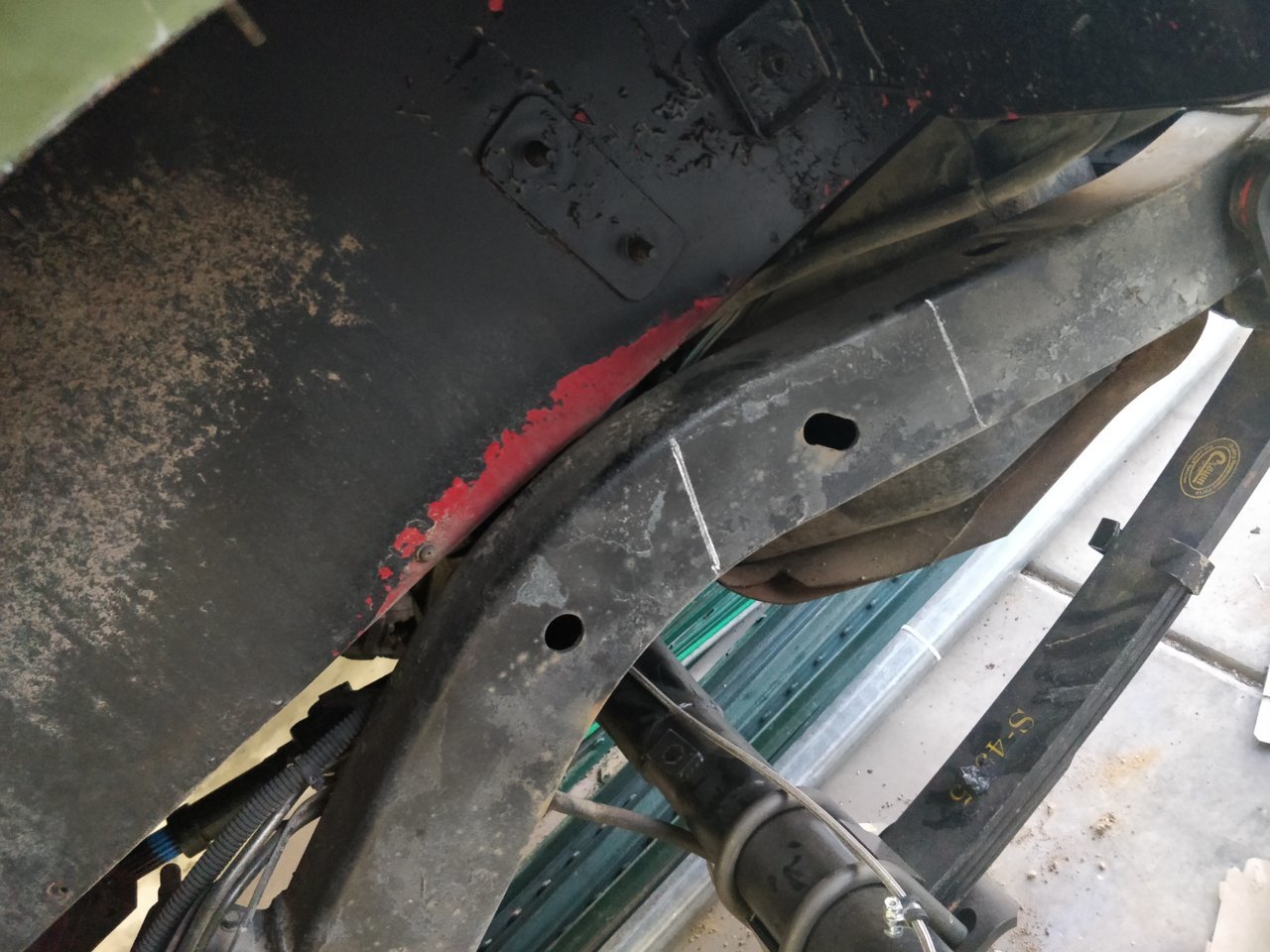

    Started mocking up the winch placement so I can start building my bumper. The 1st option puts it in front of the grille but pushes it out further.
    The second keeps it lower and closer but would require cutting the grille to get it as close as I would like.
    I'm inclined to go with the first since it gives a better approach angle even if it's further out.

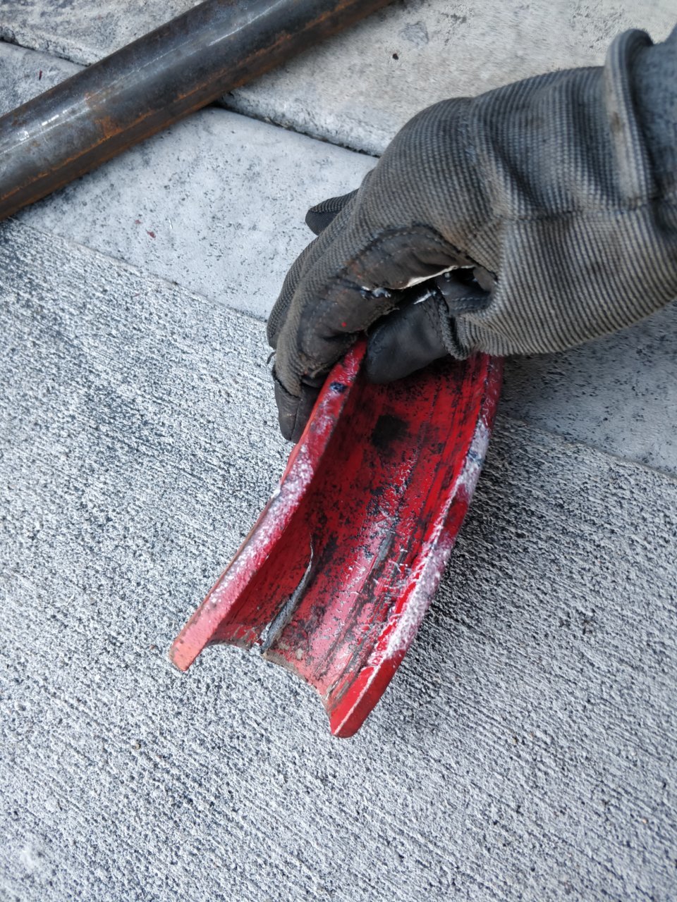

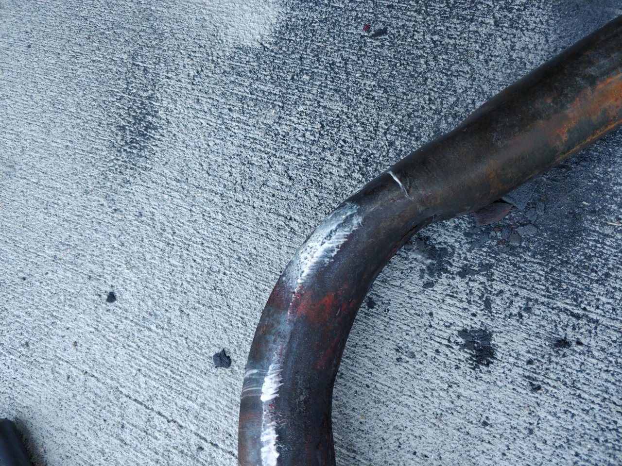

    Borrowed a HF pipe bender from my neighbor, managed to break the die. I went slow and used a lot of lube and the bend actually didnt kink until the die broke

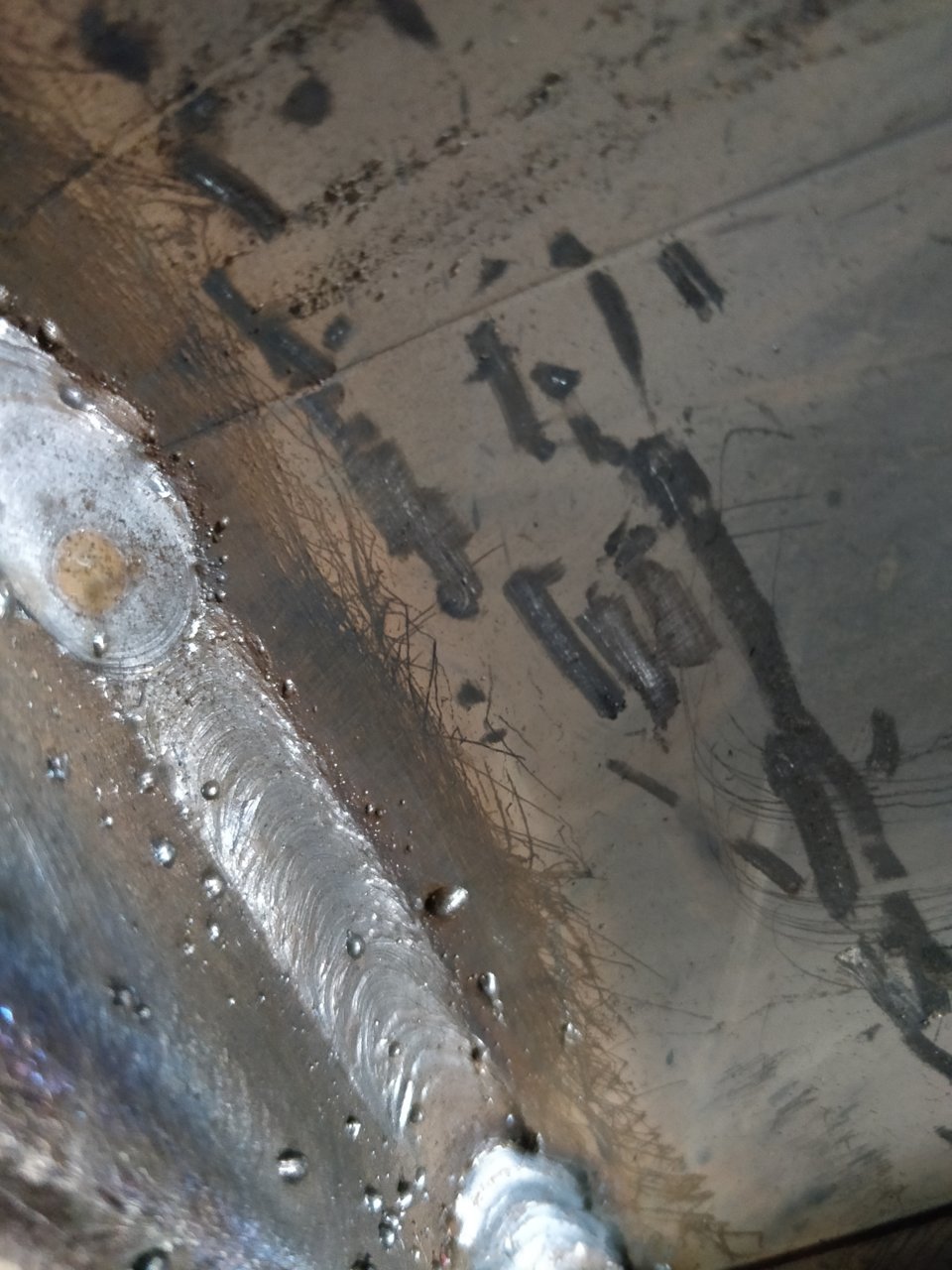

    Dog woke me up early so I made a few welds but didn't do too much. It's still a bit too early to run a grinder :angrygirl:
