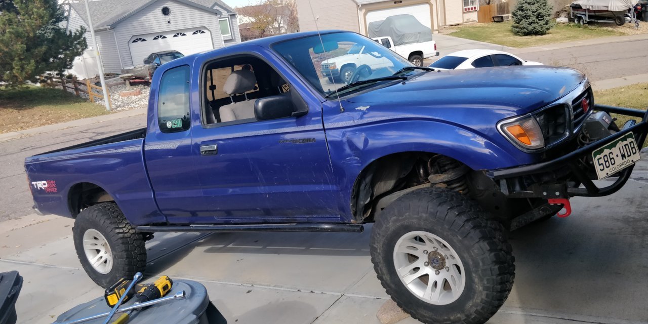

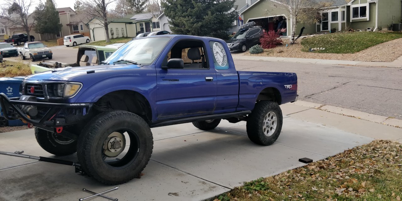

    Spent most of today in the garge and got a bunch of random stuff done before a trail run tomorrow.
    Swapped back to the good set of 31s since winter is just about here and having tread is nice. For winter wheeling.
    Played around with a 35, looks pretty good. Tubbing will be necessary

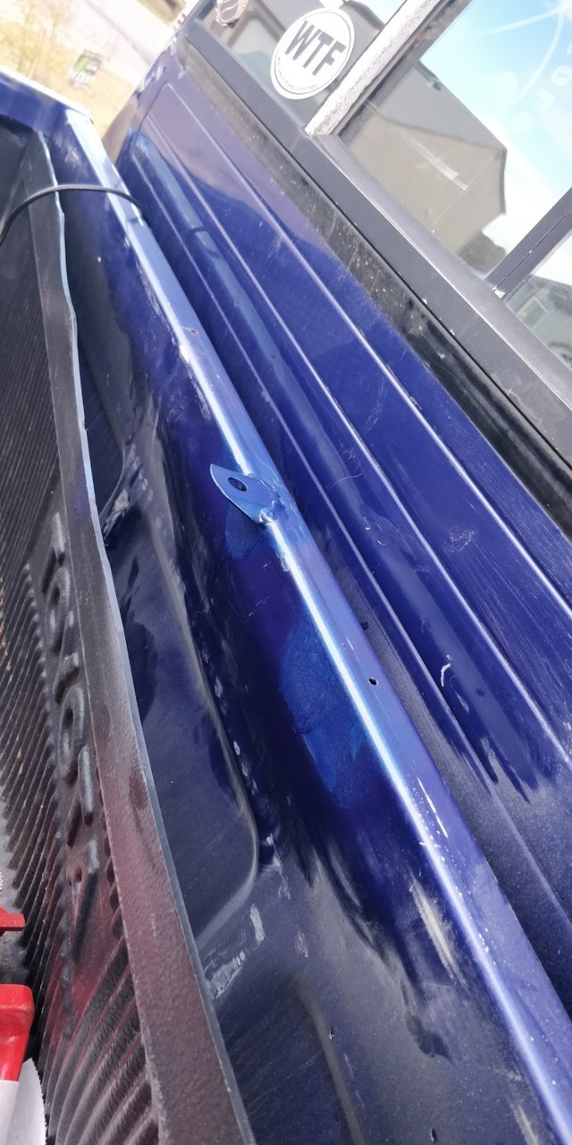

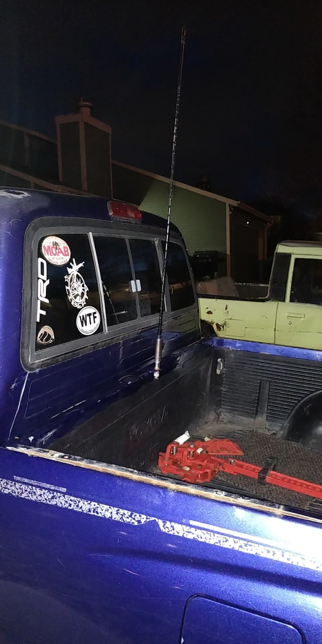

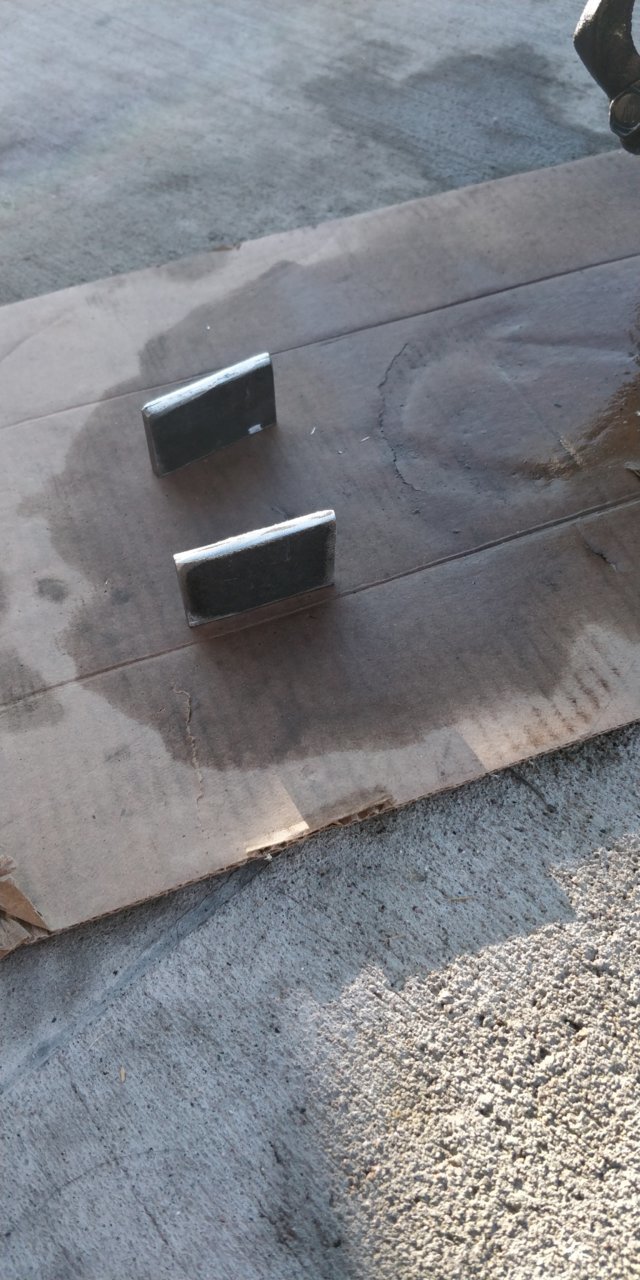

    My CB antenna used to be mounted on the toolbox, which I was never fond of. I welded a tab to the bed to mount it and got it installed after some paint.

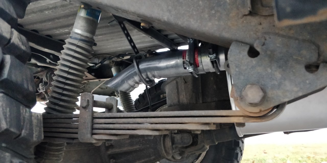

    My muffler was rattling so I replaced it with a Flowtech raptor. I also went with a turn down and got rid of the pipe coming out behind the tire. I won't miss dragging it on rocks.

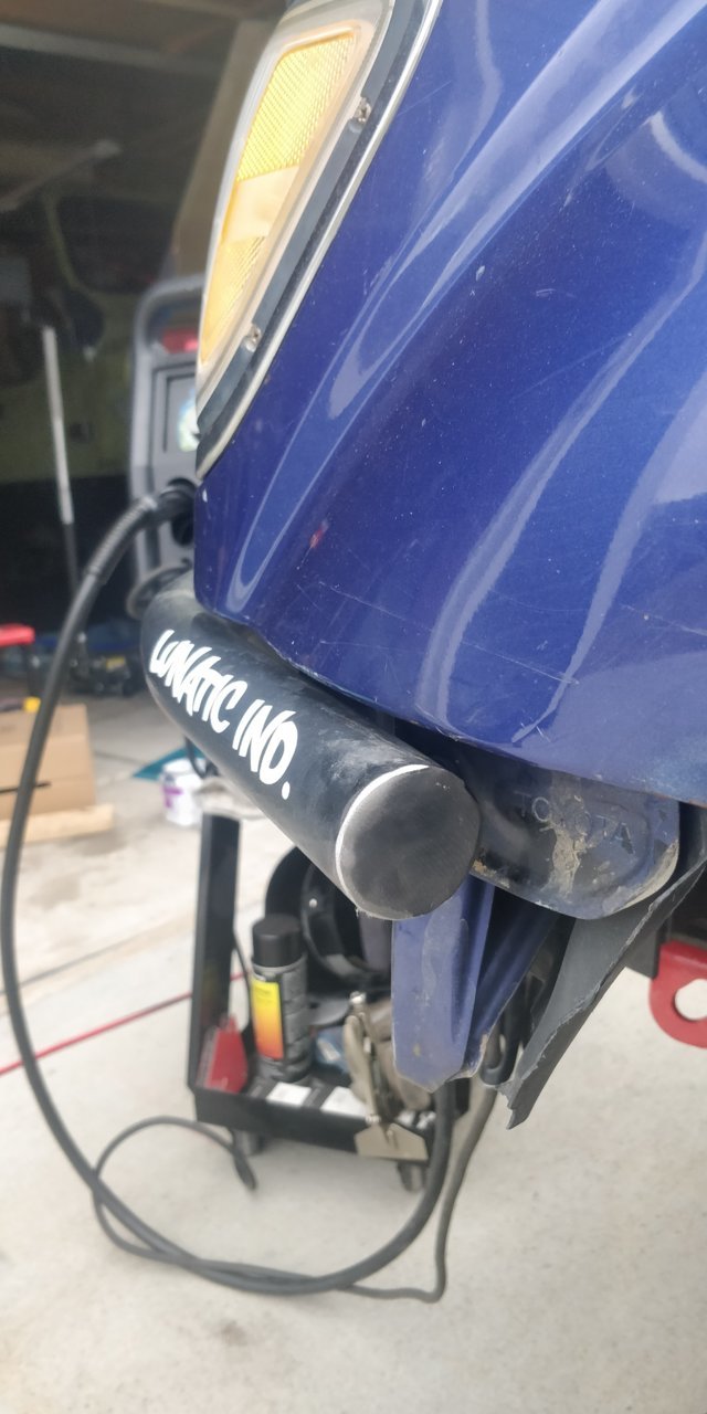

    I also capped off the open ends on the bumper to give it a more finished look.
    While I was rolling around under there I greased the rear u joint and the driveshaft and I didn't hear the random ping and clunk that I was getting on my test drive. Greasing the driveshaft must have been long over due

    I am really digging the new exhaust setup. It has a nice tone and is audible under acceleration but isn't annoyingly loud while cruising. Not sure if the last muffler didn't have enough backpressure but with this setup it seems like I have a bit more power at low-mid RPM without sacrificing anything at higher RPMs :)

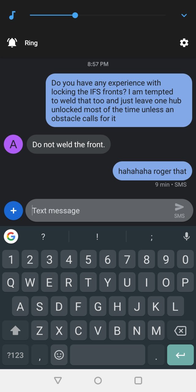

    I also have a buddy who is an experienced fabricator and 4x4 builder and have been picking his brain... I thought that this was a funny exchange

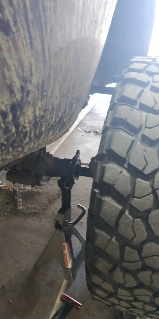

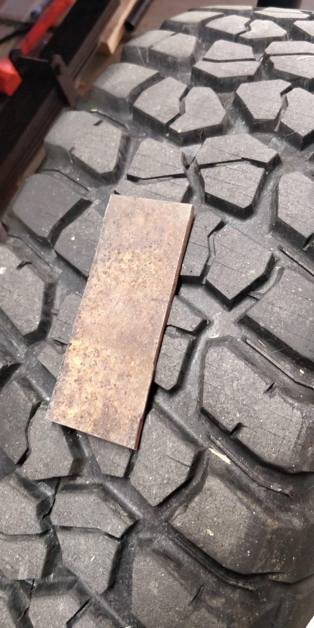

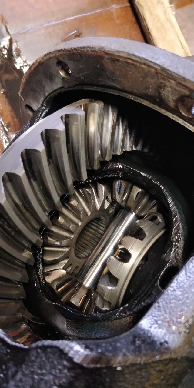

    Today I pulled the rear third to give it a little love ;)
    Gears looked good, they have some wear but no chipped teeth or cracks.
    Found a scrap piece of that Colorado 1/4" steel that would do the job nicely.
    I need to get it all put back together if I want to make the group run on Saturday :boink:

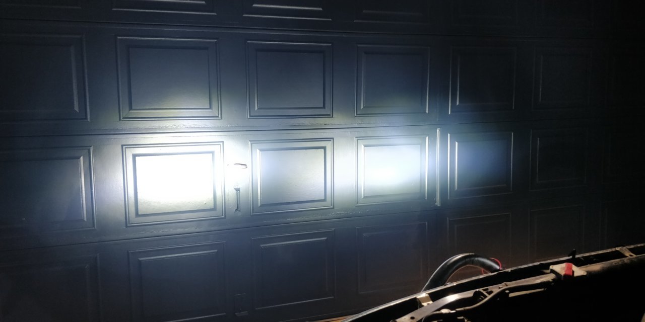

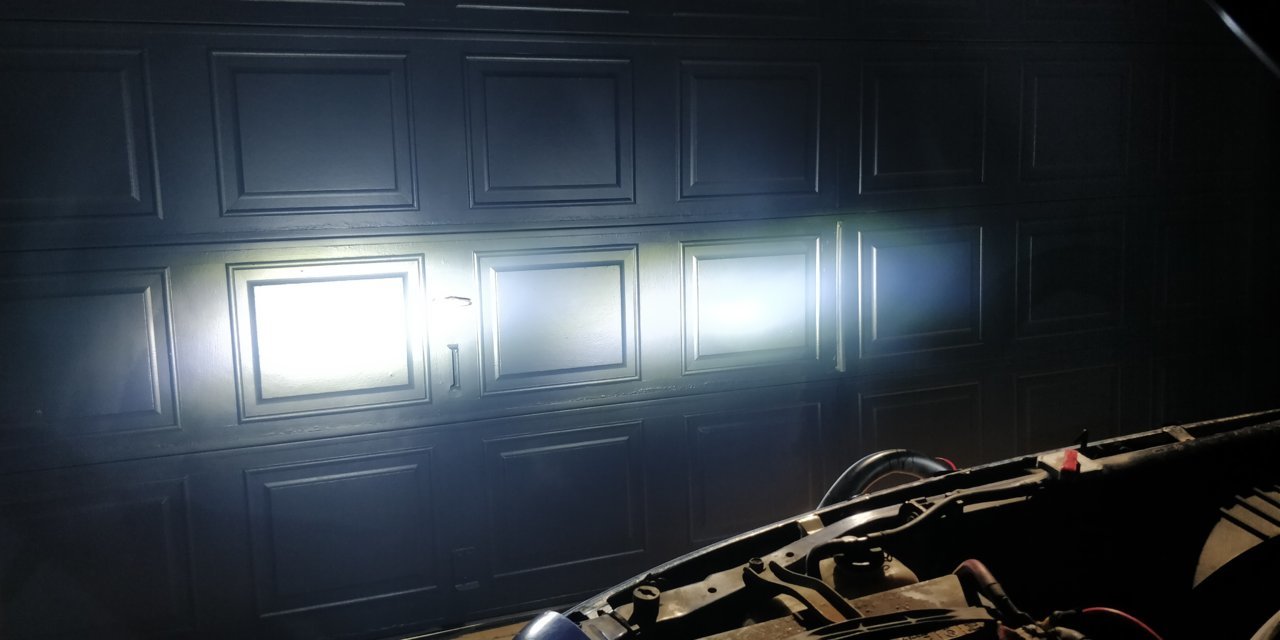

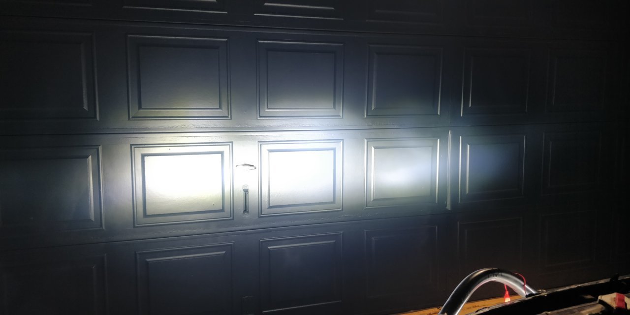

    I reinatalled my aux fuse box and tried to wire up the light bar last night. I ran a positive wire from the fuse box to the lightbar and tried to use the switched ground in the passenger headlight plug (I'm running a relay harness so it's unused) to trigger it when the high beams are on. That works but I think I'm going to scratch that idea and just run a switch because when the high beams are off the lighbar is still getting a connection through the plug and has a very faint glow.
    Low beams only
    High beams
    High beams with light bar

    Yeuhp. Kind of funky but the high/low beams are both powered and the one which is actually on is determined by the switched ground
