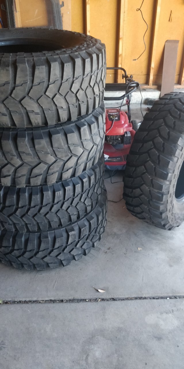

    rock raisin
    Picked up some 35x12.5R17 Trepadors. time to start considering 17x9s. Not sure if I will just get steelies or if I'll splurge on some SCS

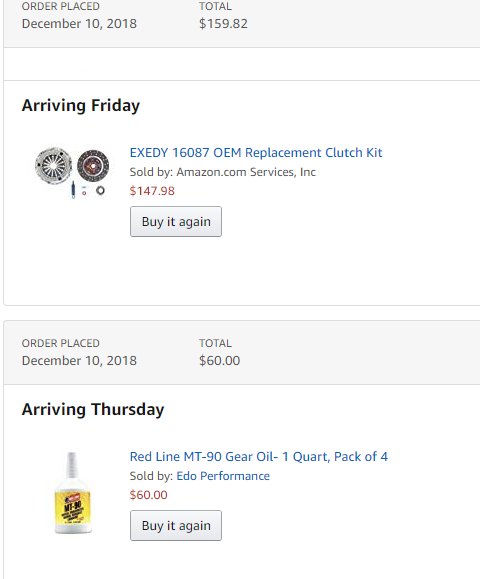

    rock raisin
    When I purchased the truck the throwout bearing was chirping. About 5 years ago I had the clutch replaced...after a while the chirp came back and it has continued to chirp for years. As of last week it's making a growling/grinding noise when the clutch is disengaged between gears so I just ordered stuff to replace the clutch again.
    Not gonna tear it all the way down and not replace the clutch when it's not substantially more expensive than the throwout bearing alone :annoyed:

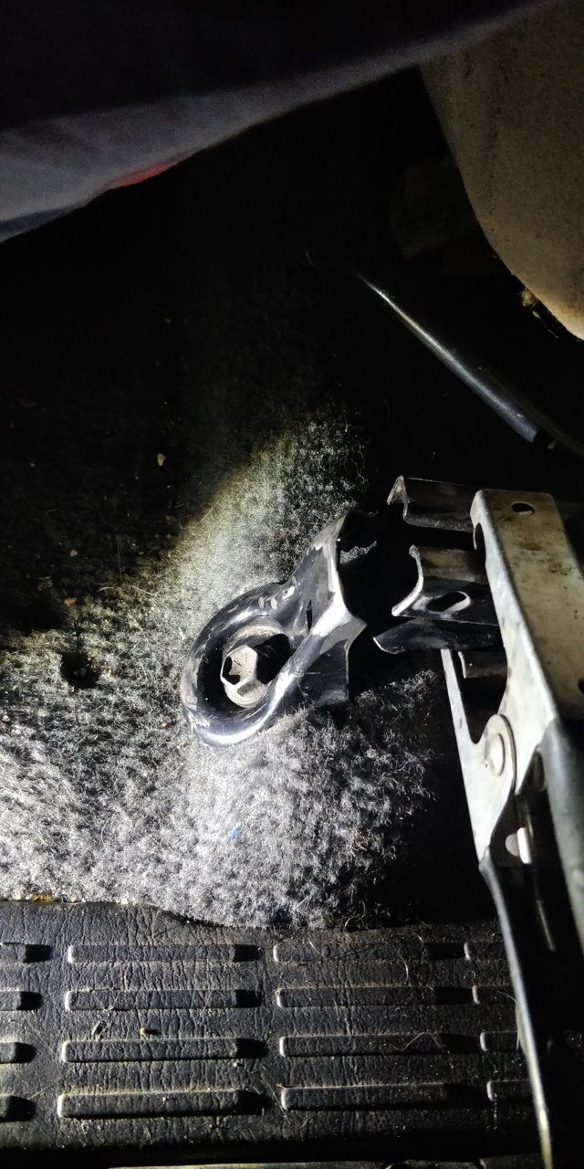

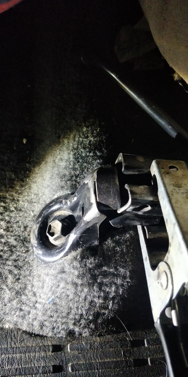

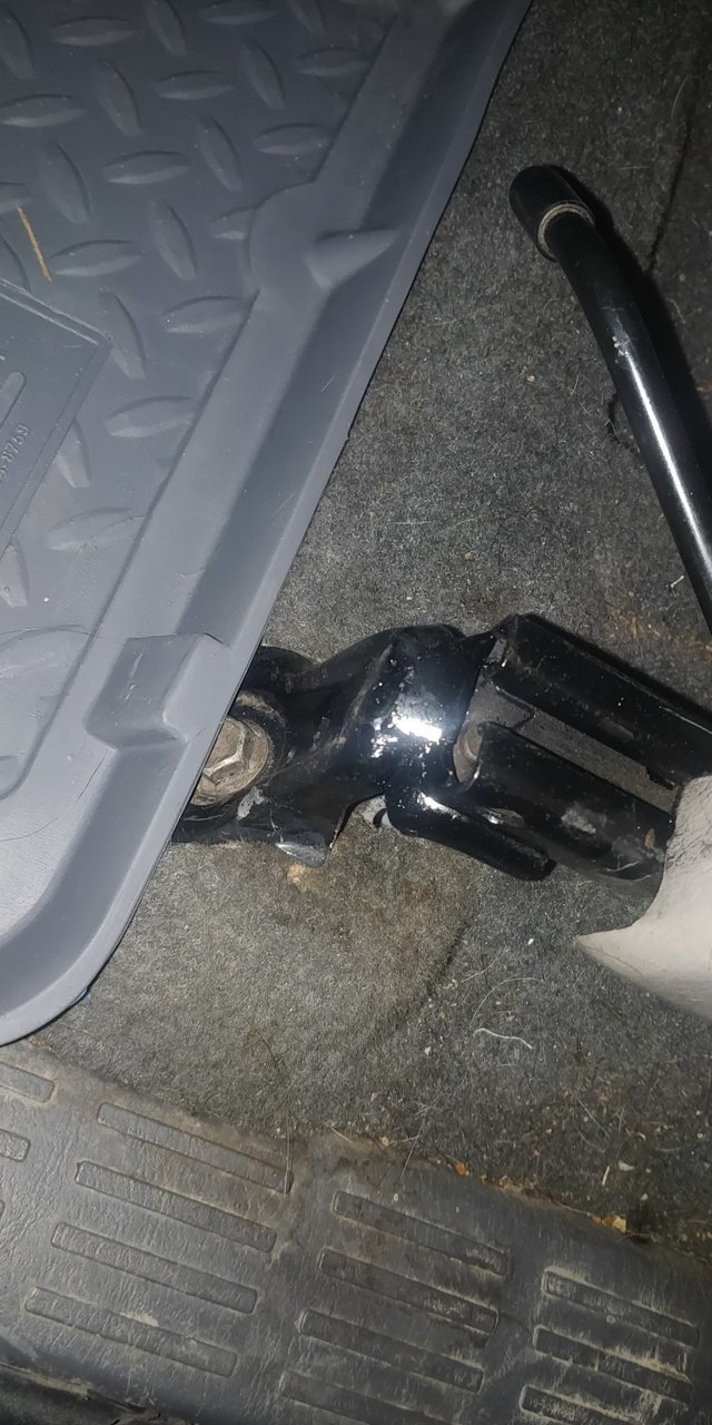

  16. Dec 15, 2018 at 8:45 PM
    #176
    Wulf
    Wulf [OP] no brain just damage
    Jan 30, 2015
    #147523
    62,005
    rock raisin
    Well, 4 of the bell housing bolts were finger tight. The TDC one is missing completely.
    I got all 4 as tight as I could and greased the fork and it's a lot quiter and there no vibration. I'm guessing the pilot bearing and input bearing were not happy with the motor twisting when the clutch was engaged.
    It does sound like there is some bearing noise when the clutch is engaged in neutral still.
    I don't really want to drop the trans so I'll see how it goes.
    I also fixed the seat mount, when I put these 4runner seats in I didn't pay attention to the fact that one of the legs was longer than the Tacoma seat. It caused it to sit at an angle and would give me hip and back pain when I drove a lot. Hopefully this helpsIMG_20181215_195423.jpg IMG_20181215_195456.jpg IMG_20181215_204108.jpg
