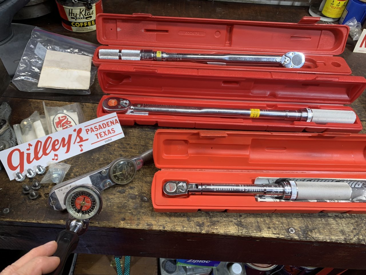

    Here’s a few of the tools I used before retirement. Lower left I’m holding a neat little wrench that measures inch pounds. Using thumb and forefinger I can twist 3 in lbs
    The black wrench is 1940s Snap On and it works. The others all garden variety Snap On or Proto.
    We had on-site standards laboratory handling all types of precision measuring equipment. The yellow stickers are certification labels from lab. Some time in the 1990s we had to take all personal measuring tools home because guys were lax on maintaining certification up to date. Lazy fukin mechanics
