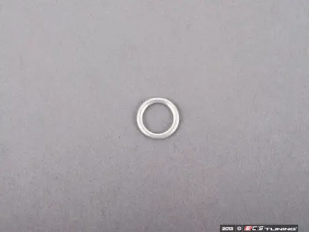

    What do you mean by come loose? Does oil start dripping out?
    The reason the torque backs off is because it's a washer that is designed to crush. If it was harder steel like a regular washer the torque would stay at 30. It's not the kind of fastener that has to "stay at 30" to do its job, it's just a drain plug. It just has to crush the soft washer a little
    If you keep torquing and torquing you're just squeezing it thinner and thinner.

    We torque to 30lbft, with a Snap-On recalibrated quite often, every-time I change the oil. The drain plug was hardly tight and slight seep of oil around the plug. That happened several times, so, I would drive for several hundred miles and re-torque. Problem solved.
    I know the wrenches are as accurate as they can be because they are used, not by me, for a lot of engine work that accuracy is important. My buddy didn’t even believe me until the next time I made him loosen it. Then he believed me.
    The fiber/aluminum ones they give are shit. They did give me, early on, some normal aluminum ones. The stock one was a fiber one that was a bitch to break loose. Way more than 30lbft. The truck has 70k with 5k OCIs.

    Have not tried different bolt, no crap on the pan. At first we didn’t torque them, just tight and a little more. We thought that was the problem, so then we did torque them.
    No damaged threads, bolt threads very nicely and after I re torque no problem at all. It’s like fiber crap shrinks? Don’t know, but Toyota did give a regular aluminum one maybe 1 to 2 times and was perfect.
    I’ll ask if they have the aluminum ones and go that route,

    Would definitely just use original Toyota oil drain crush washers. Or install a Fumoto valve, witness-mark it & call it good.

    This is a little inaccurate, as related to the type crush washer I've been discussing. Initial torque is attained @ 30ft lbs, after the crush washer has deformed. Something is happening to the crush washer shortly after this though, I do believe it is the crush washer's two sided gasket material that is degrading afterwards, thereby reducing the tension against the aluminum portion of the crush washer. A secondary application of torque seems to rectify this anomaly.

    Maybe not creep backwards on its own. But these little bastards leak if you don't replace them every time. They are very specific crush washers.

    I believe this is possible. Esp given when I worked at Toyota there was always some blue fiber on the pan and plug. Some were over torqued and required a larger ratchet to remove. Most likely caused by the fear of it leaking.

    The drain plug isn't loosing or relaxing post installation. Used washers are not the same as new washers.
    Plain washers are annealed aluminum. When tightened they are under compression, this causes the mating surfaces to work harden. Reuse that washer and you will need to tighten it to a higher value to achieve compression. After a few uses the part is work hardened enough that the slight compressive force of tightening a drain bolt no longer create a seal.
    You can heat and quench the washer to anneal it but it's difficult to do in a shop setting because aluminum doesn't change color when heating. You will probably melt it or not get it hot enough for the metallic structure to change when quenched. Copper washers are simple. Heat until red hot, quench and it's as good as new. This is why so many horror stories about stripped drain plugs exit. Tighten it more each time the washer is reused until...
    The Blue Washers - these have a fibrous cement coating over an aluminum washer. Instead of relying on the aluminum slightly compressing to achieve a seal the coating creates the seal. When tightened the compressive pressure activates the cement creating the seal. (It's the same principle as used on cement coated framing nails you buy at Home Depot, that create a grip when driven in) These are one-use items, the blue seal becomes much harder after the first use.

    it seems like a lot of these responses are assuming the OP is using oem washers. he is not, hes using an equivalent. I dont believe i have come across any user that uses actual oem washers and has one come loose, torque wrench or not. I have personally come across "looks like oem" washers and found them to compress much easier than oem.
