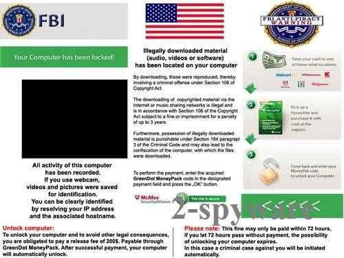

    Well my know it all 12 year old managed to download the CryptoLocker virus on to my desktop a few days ago (somehow while watching YouTube?). It'll look like this when you get it....
    In case anyone manages to get it, here is a good walk through to rid yourself of it. Worked like a charm for me....my Kaspersky Anti-Virus did not do anything for it.
    http://malwarefixes.com/remove-cryptolocker-virus/

    Just an fyi, your files are almost certainly still encrypted (whatever files the virus managed to encrypt). There's no recovering them unless you pay the ransom or have backups of those files. This virus is the real deal...
    Removing the virus won't unencrypt your files, nor will running that unencrypt tool in the link you posted. That tool works for a very old variation of this virus which stored the encryption key on the infected computer. Cryptolocker stores the key on a remove server.
    Google "reddit cryptolocker" without quotes for more information on this thing

    Just a follow up to my last post, by the time you see the popup message with the countdown, that damage has already been done. It stays silent while it encrypts your files.
