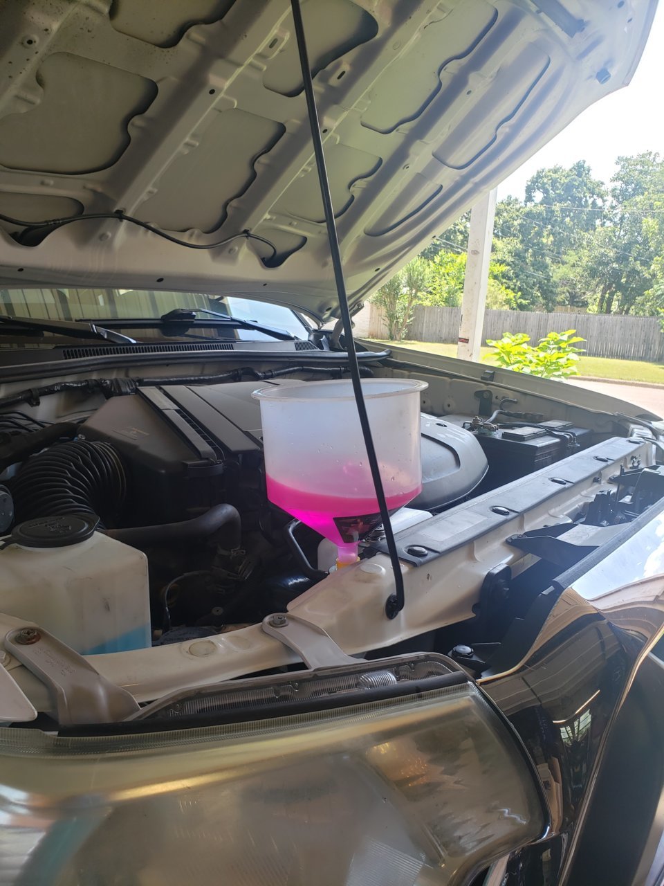

    75% sure they're all gone. I let it rest overnight and it took in probably 1/4 of the overflow tank.. I topped it off and used the funnel bucket to attempt another bleed. Holding throttle and quick throttle stabs didnt seem to yield any more bubbles.
    Only part I find odd is that it seems to get up to temp alot faster than before. Not sure if it's a bubble somewhere or if thats just how it is. Ive noticed this issue with my other cars that have had full aluminum radiators. But it could be me hyper-focusing on my ultraguage and being paranoid.

    I had to do a fresh fill on an engine last week. It got a bad air pocket. Wouldn't let the water circulate.
    There is a small coolant hose, which kind of has the shape of a "j". On the t-stat housing. Left side. Under the upper radiator hose. I carefully pulled that off, careful to use the hose to aim the hot air/steam away from my hand. There was a nice hot air pocket that came out. Once the air stopped, coolant flowed. Pulling that off for a test may help. May do nothing if your system is air bubble free already.
    Also, pretty sure you did, but I will type it anyhow. Did you turn the heater on high, to get the coolant to circulate through those hoses as well?

    I did. Heater blows hot. I also squeezed both radiator hoses and heater hoses while I was bringing it up too temp. I might give that a try later this week.

    Does no one like those over sized radiator cap funnels?

    It should just be a cap. Probably not a special adapter needed. Or just put the funnel into the neck

    Yes it does. Thats the exact kit I have on my truck. I know the metal cap adapter is B. Id have to look at which yellow one is needed
